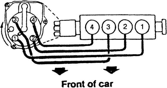

    Triple check:
    It's also worth noting that Bosch is not the Oem supplier.
