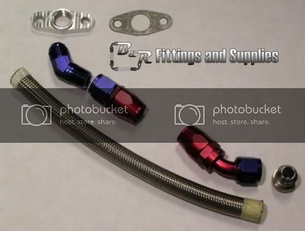

    Also, I have to make my up an oil return line to my oil pan. Im curious to know what materials are suitable for an oil return line. I was hoping id get away with simple rubber tubing, but im skeptical that it can handle the extreme heat. Any ideas?

    no way. you need stainless fittings and lines.
    you can get a kit like that for about $60.
    email this guy if you want it: bandrfittings@gmail.com
