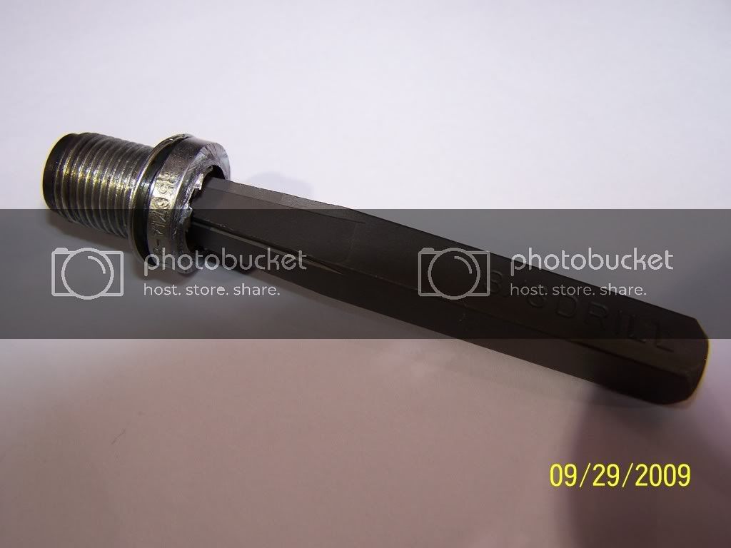

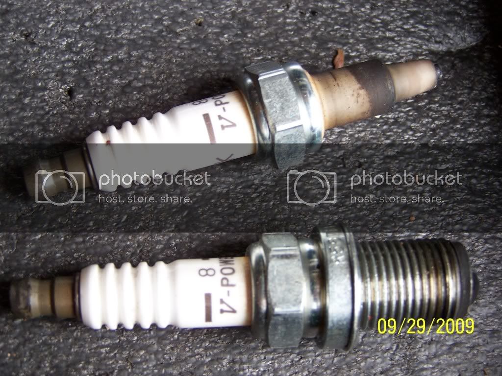

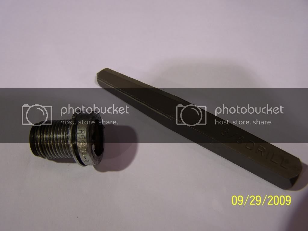

    There is the plan soak in pb blaster a couple days, then try and use an EZout... If that does not work, pull the head. These are pics of the problem and MAYBE fix. I cut an old plug to get an idea of what size EZout to use..
