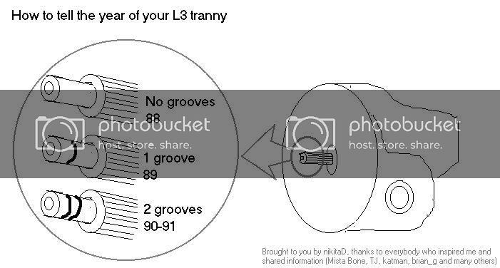

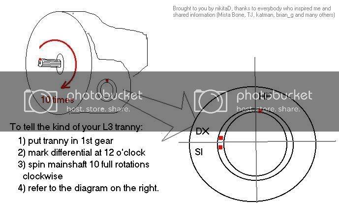

K2e2vin Senior Member Apr 2, 2011 #2 Nope. You can only tell what bearing size it uses(IIRC, Si always has big bearing, B000, rest is A000), though here's a method to figure out the FD: And of course year(88 has a different spline count):
