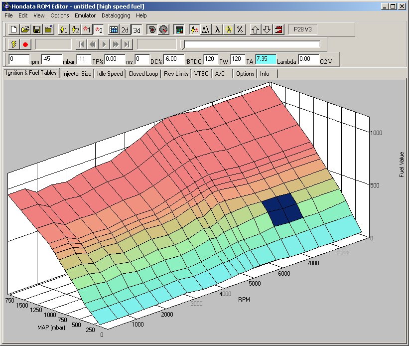

now, hondata IS a chip- but it is 100% tunable. you make your own fuel, igniton maps and all that based on your injector size, duty cycle, and so forth.

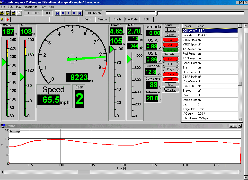

using software that you rtuner will have, you basically get a windows interface to burn the chip. it looks something like this:
Thanks pissedoffsol, I appreciated the extral miles you took to post those closed up pictures. They really help! thanks for all the posts and helps guys!
