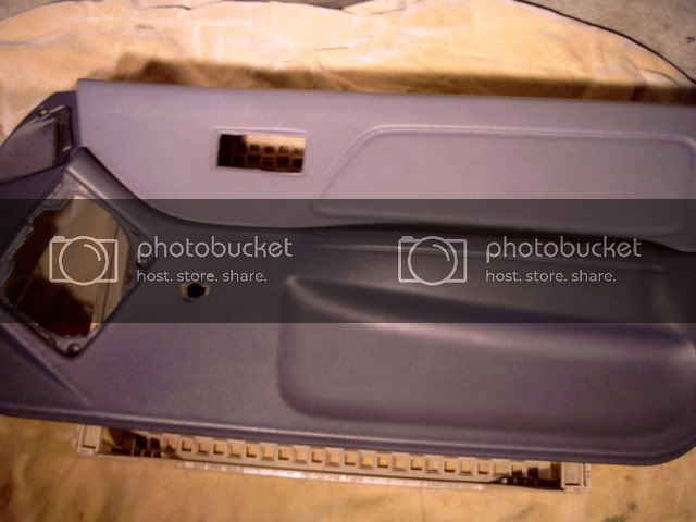

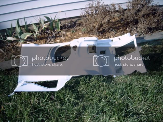

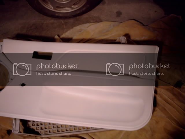

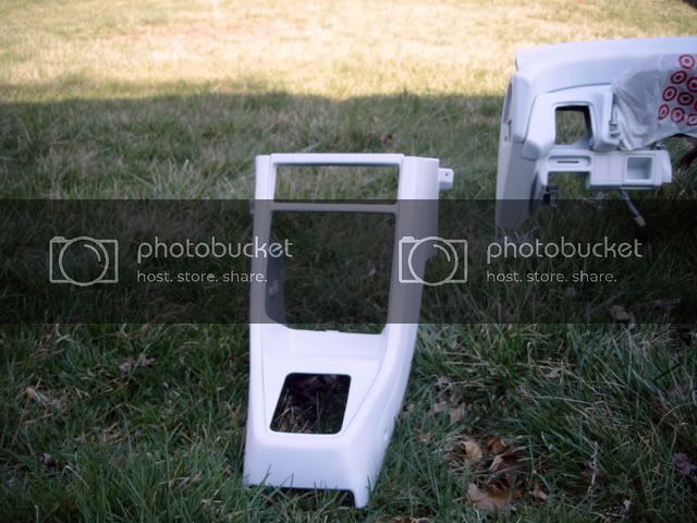

Hey I asked this same question quite a while ago and I got a bunch of damn haters saying it was gonna look like shit, don't do it, blah blah blah. Yeah they were wrong.
First off, the prep. There is this vinyl/plastic prep that smells kinda bad you use. I started by washing each piece like, honestly, about 5-10 times with soap and water. After that I went over the pieces about the same amount of times with the cleaner. You just spray it on and wipe it off to make sure all grease and armor-all etc.. etc.. is removed. Just go over it a ton. One can goes a LONG way.
Now for the paint.... You have to get the FLEXIBLE vinyl/plastic paint. Also, I put like 5 coats on mine to make sure it looked really good. Remember, thin coats mang, thin coats. Then I would suggest putting clear coat over it. The paint people at French's here in Iowa said most people slack off on this part because of making the interior appear glossy/shiny. However, my interior is white so it doesn't really matter to me. In your case I would apply the clear coat sparingly and mainly on pieces that are going to be leaned on or possibly rubbed against. Definitely do the center console. Also, the clear coat can run just as easily as paint and build up so be careful with it as if you use it. And w/o further ado here are some pics of my interior. If you have any more questions feel free to PM me or whatever. Good luck!!!!
