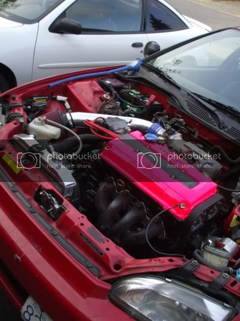

    might as well post a photo i guess.
    1 person likes this.
