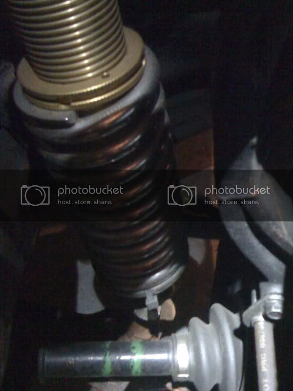

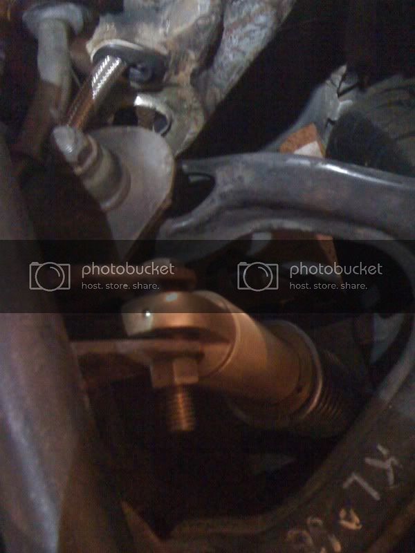

    Top of coilover showing mount
    Coilover from Mini Sprint, ya that took some fab work to make it not hit axle haha. Damn stock fork setup is weird.

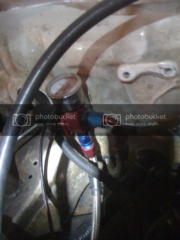

    Here is my Fuel Pressure Reg.

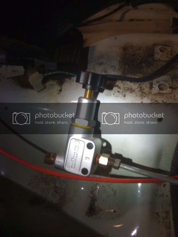

    Manual Prop. Valve from Wilwood so I can adjust on the fly and fine tune rear brakes.

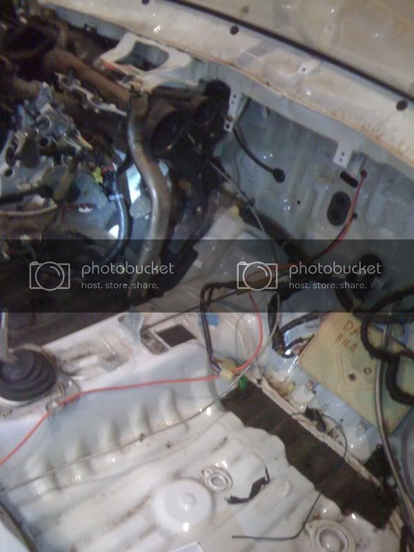

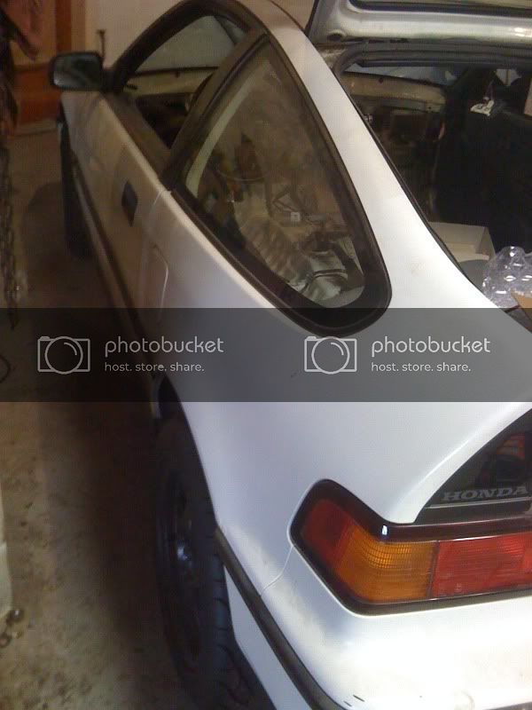

    Not that we haven't seen a Rex with no dash and carpet before but here is another. Just showing how it sits.

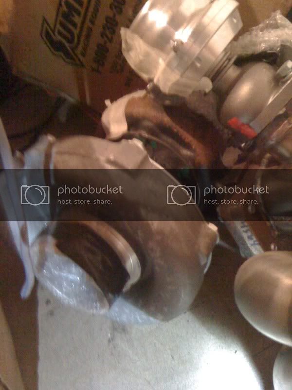

    Garrett T3/T04E

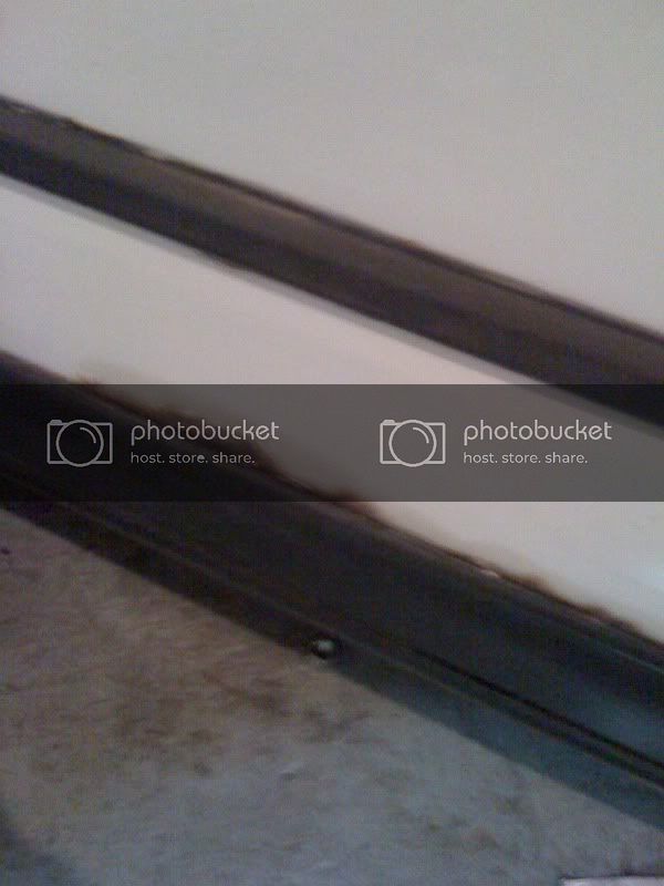

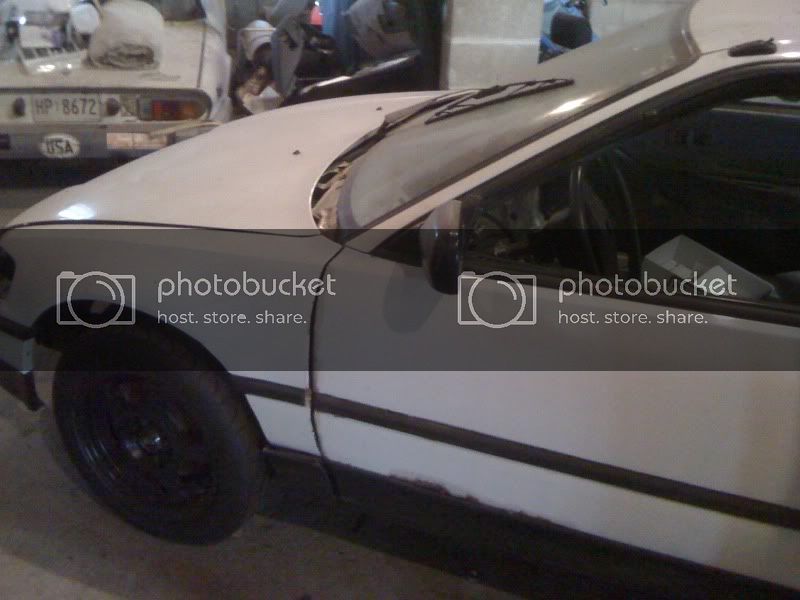

    Only real rust on body. What can you expect, gives it a sleeper look haha.

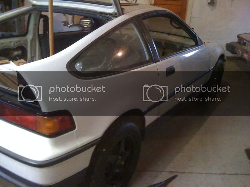

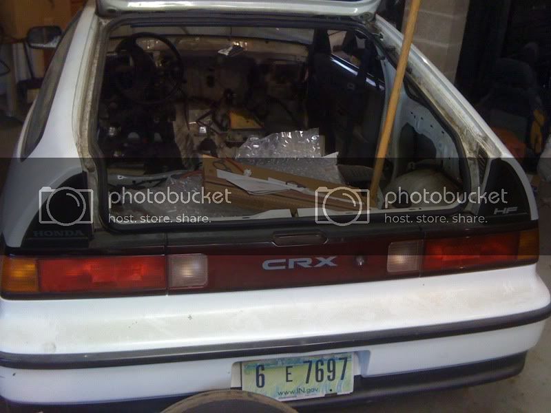

    Yes that is a push broom holding up the hatch lol. I had it off, struts were shot so I threw em away and haven't gotten new ones yet

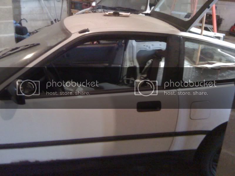

    This is a shadow not different color
    Not sure if this shows up but shows how much dust is sitting on it.

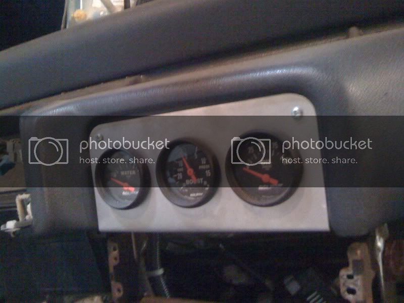

    Had a buddy at school make this. Very nice brushed aluminum. Won't find this in a catalog. Thanks Palmer.

    looks good but i bet theres alot more rust under the side skirts, id pull them off and take a look

    Ya there may be some I think that skirt has been pushed in and caused some damage behind it. All other panels look fine and there is no rust under it anywhere. Its really clean for an indiana car. I plan on fixing that door skin or getting another door sometime.
