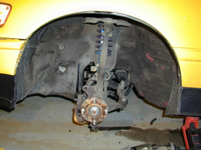

the EF's have spring over strut suspension, your car has torsion bars up front
EF (all 4 look similar to this):
EW front:
