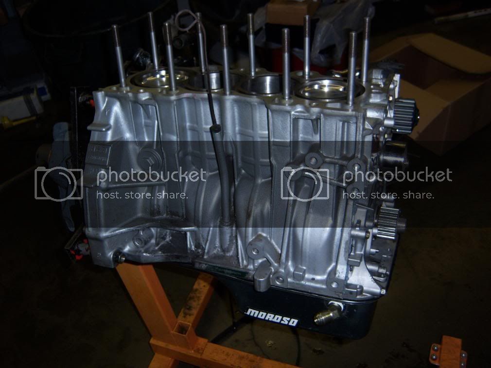

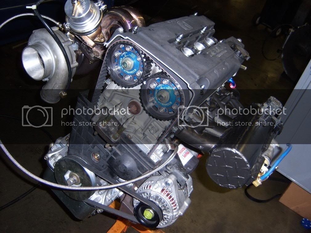

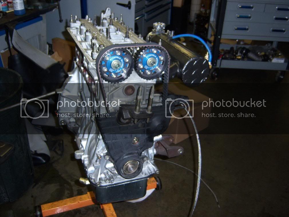

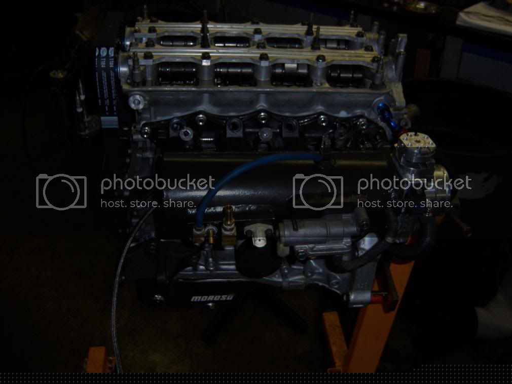

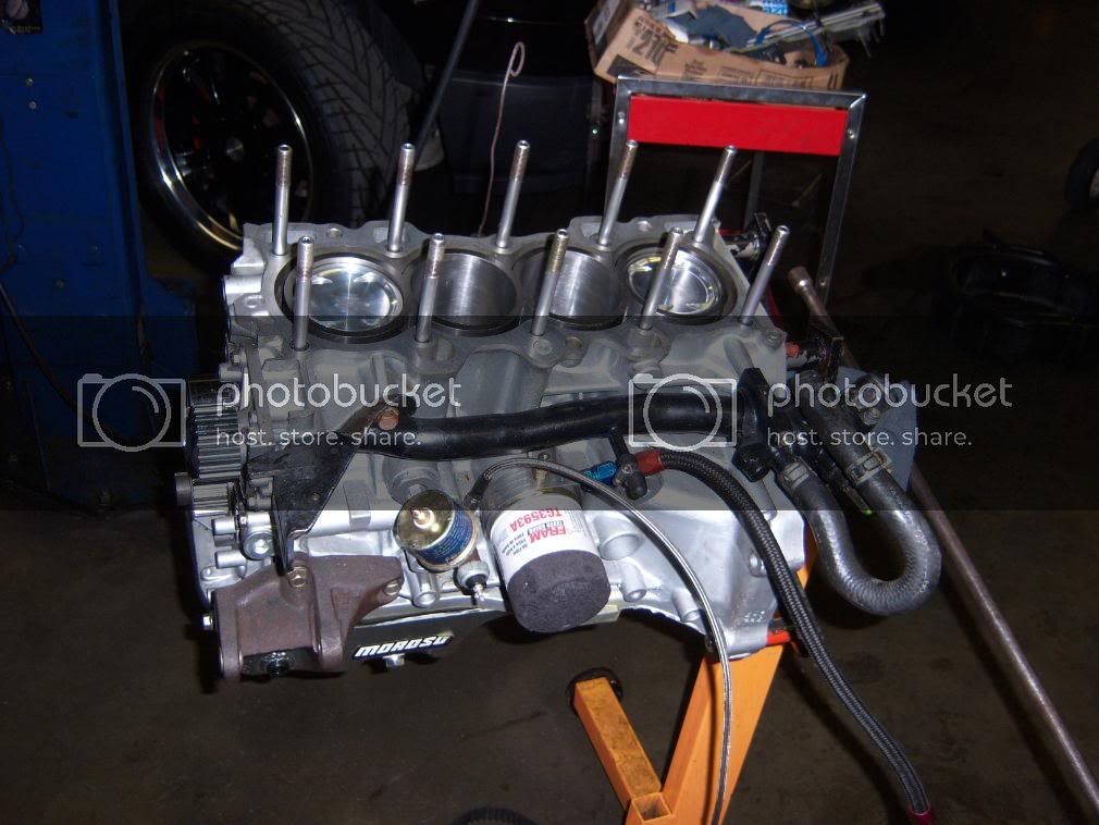

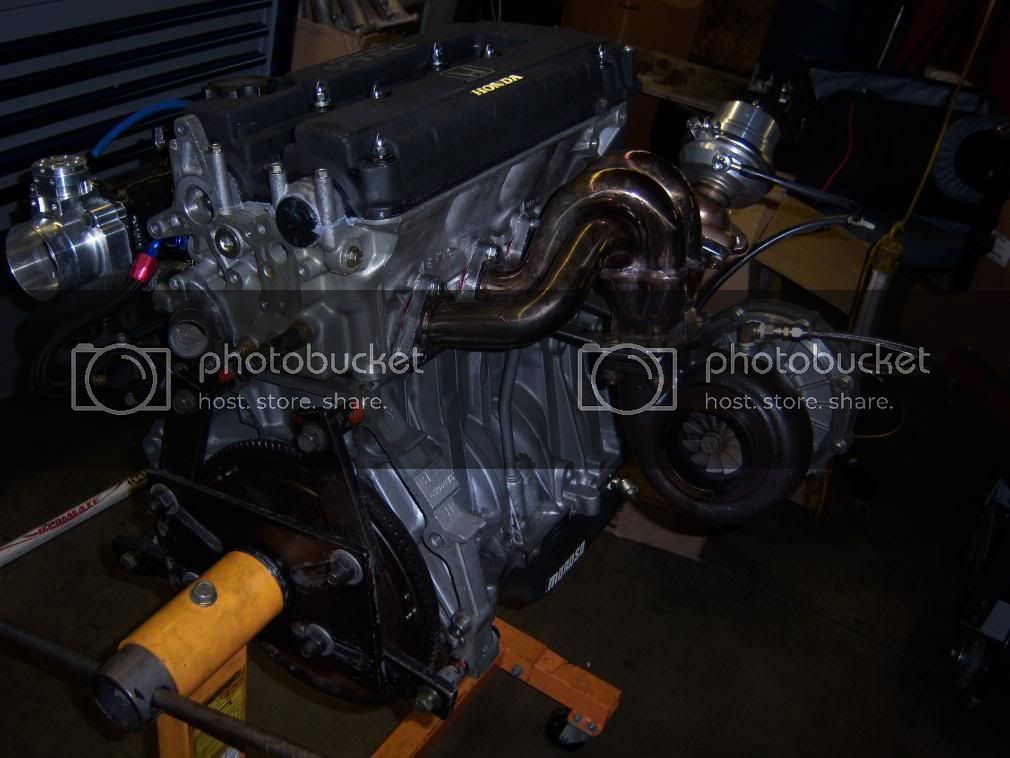

    So since my other motor decided to break a valve and damage the motor here is the new beast that went into my car.

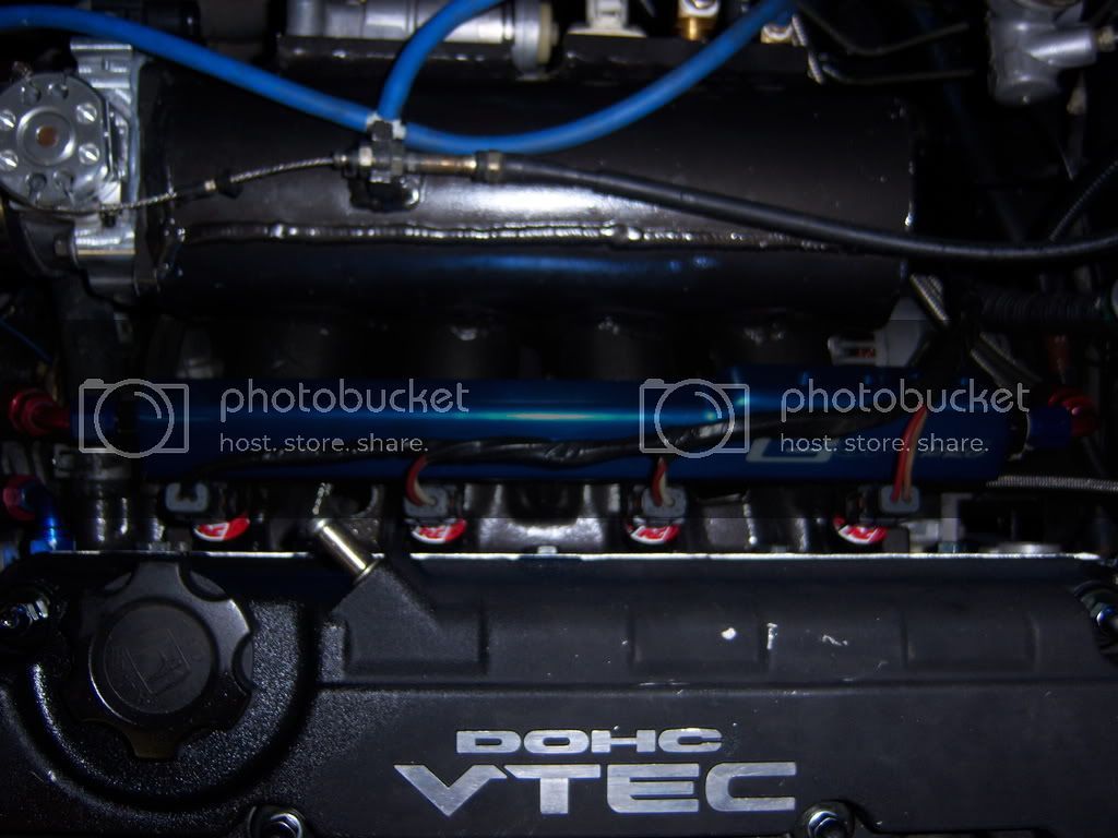

    Here are the pictures of it in the car

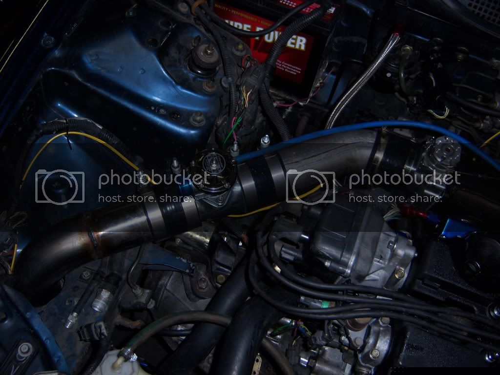

    Nice build, how did you route your oil line to the Vtec. The oil line feeding your turbo is the line I have feeding my head. were is the other line coming from?
  13. Sko0terMan
    Sko0terMan Member
    150
    Jan 12, 2003
    Los Angeles

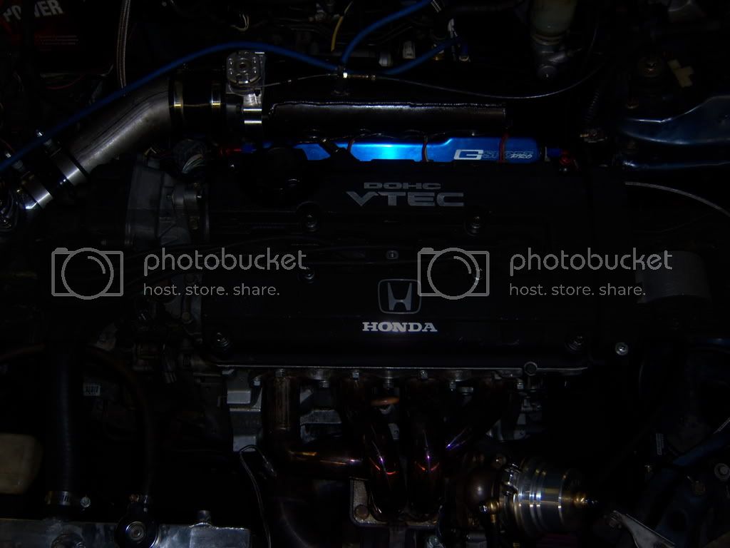

    if you look in the first picture, the black hose coming from the oil filter area, that is the line that is feeding my head. I used an oil filter adapter plate that i was able to run an extra line.
  14. civicman69x
    civicman69x New Member
    Mar 3, 2008
    Thanks for the info
    Thanks for the info. I have a similar set up but nothing as clean as yours. Hopefully one day mine could look like that. I'm still in the process of putting on the turbo.
