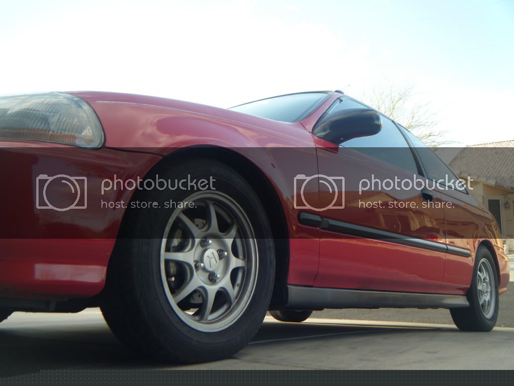

    Figured I would start a thread on my turbo build for my LS Vtec. Car is a 98 EJ7 Civic coupe that started life as a Hx, fast forward 3 years and now is LS Vtec and boost is waiting. Plan is to boost the stock LS block (plus ARP rod bolts) and shooting for 250-300whp. Then build a second B18B1 for 400+whp, this will be a DD car. I already have a Hondata S100 car is running a great LS Vtec tune. ID750cc injectors and walbro 255 fuel pump will take care of the fuel needs. I have started to piece the kit together. Got a cast manifold that will work with AC and PS (I hope) and have a HKS SSQV on the way. I have not fully decided on what turbo yet but have a good idea. This will be slow build as I am buying this as I get the money to, so stick with me.
    Pic of my EJ

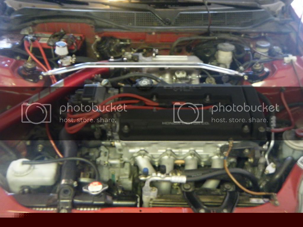

    going back a little

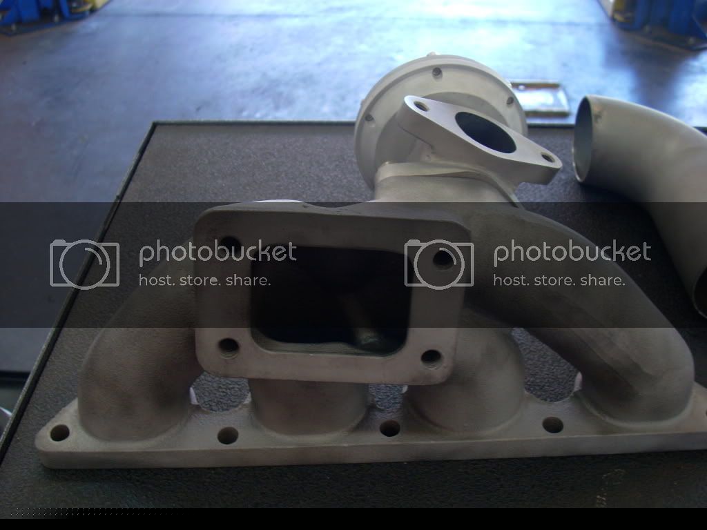

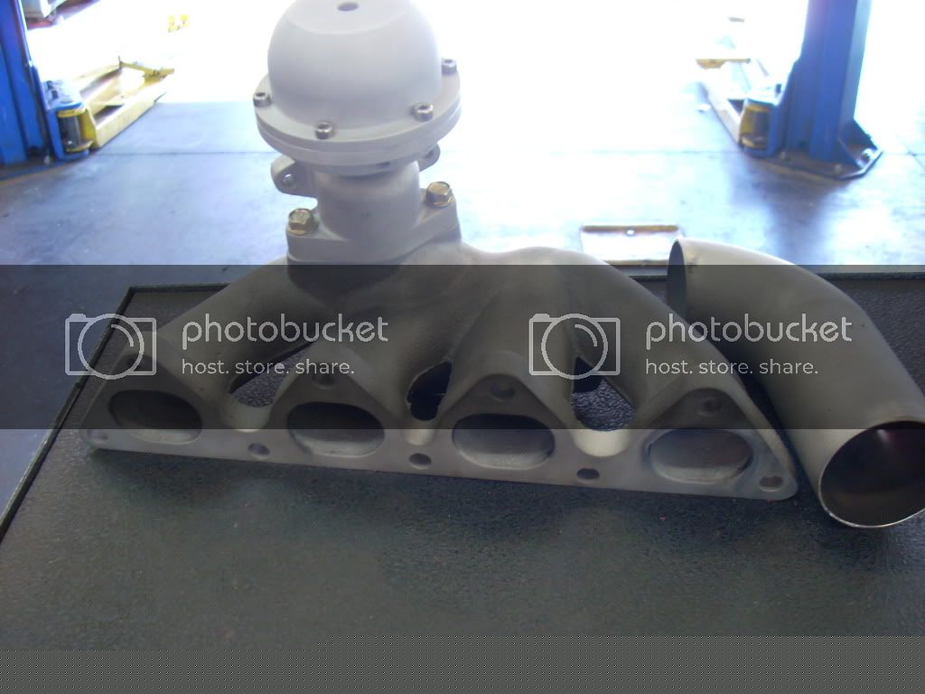

    turbo mani, not using the waste gate on it

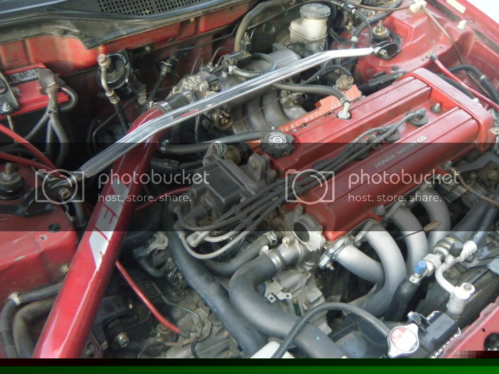

    Yes B16 head off either a OBD2 Del Sol or 99-00 Si, fully rebuilt, decked a little, 3 angle valve job and H22 Type S LMA. Stock B18B1 pistons compression is around 9.6-9.9:1 after decking and the increase from the Vtec head's smaller CC. B16 cams, 99 Si ported intake mani. I did have a head that I P&P but it got ruined by a machine shop (long story that makes me mad). CAI, 4-2-1 header, 2.5" cat back. All in all my current "stock" LS Vtec set up is making 161whp and 125lbft, not to bad. I told myself that a mild LS Vtec would be good but you know how that goes.
