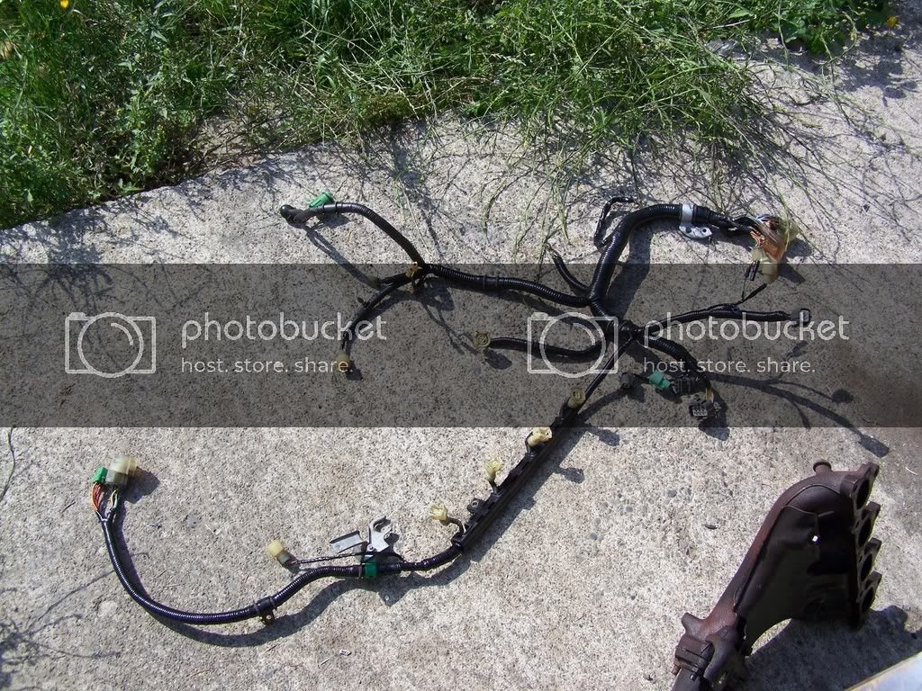

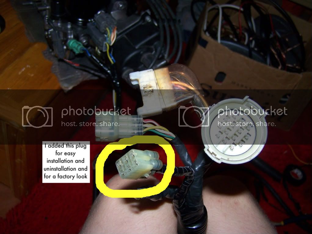

I made my converted wiring harness today, it turned out pretty good.
That plug has the two wires for VTEC and the 4-wire 02 sensor.

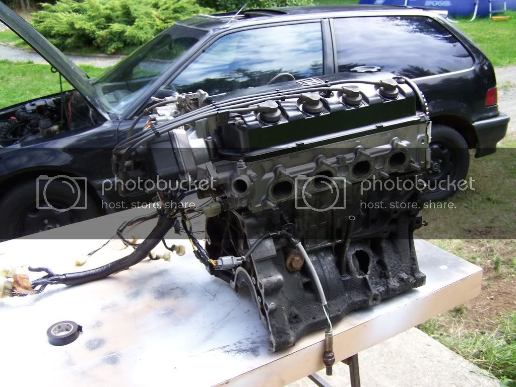

I set the head on a blown a6 block with the a6 intake manifold to set the length for wires.
After I put on the tubing stuff and covered everything with three roles of electrical tape.:)

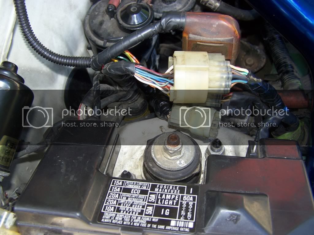

The other side of the plug for VTEC and the 02 sensor through the firewall.

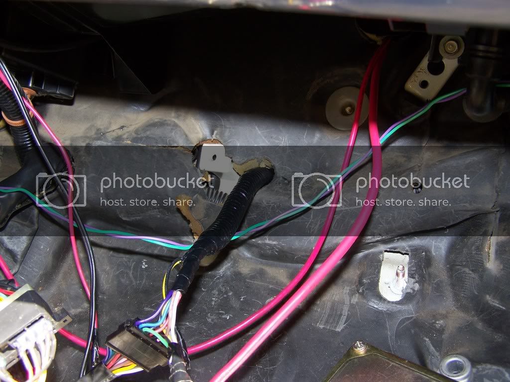

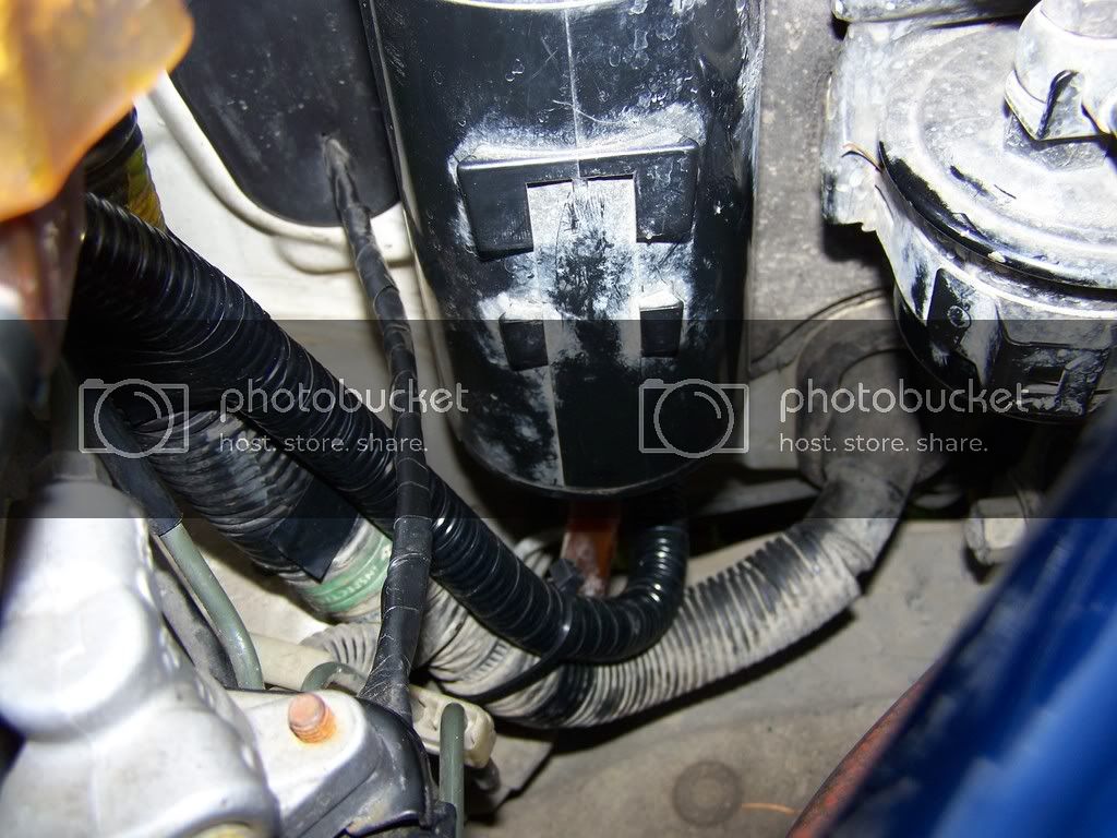

This is where the wires went through the firewall.
On the other side of the firewall.

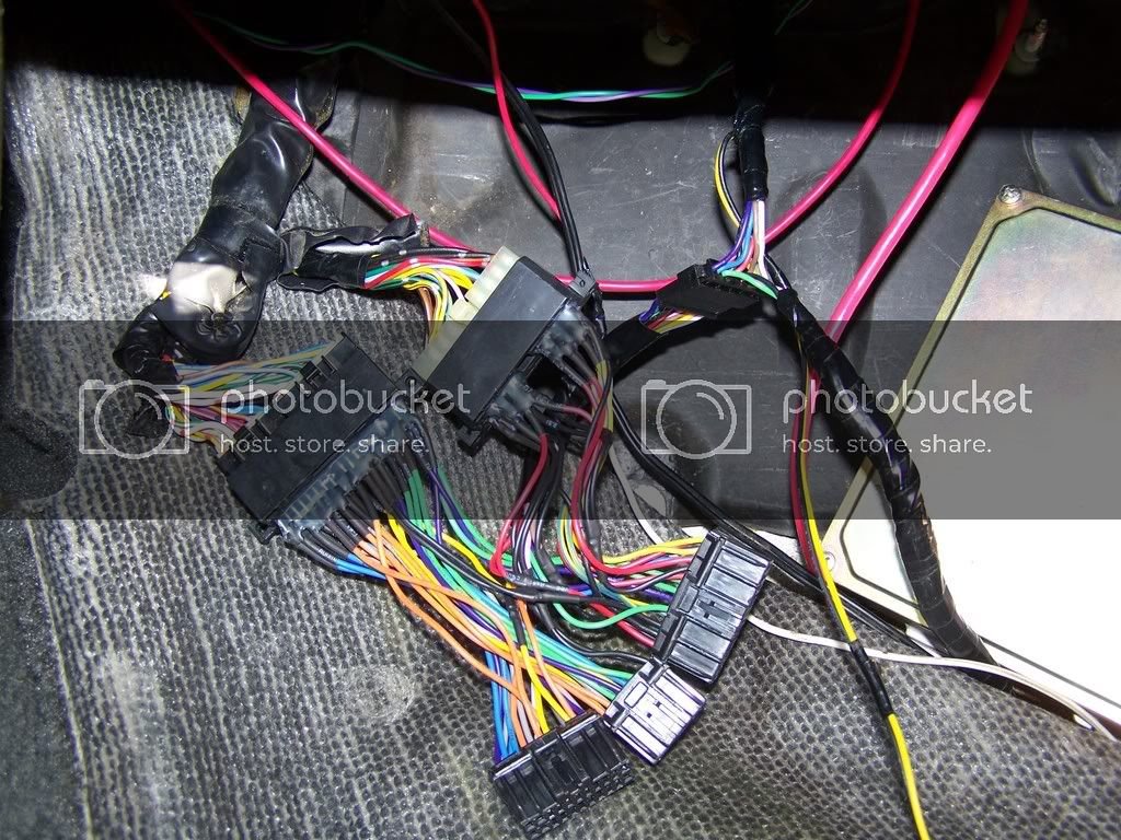

Plugged into the harness.
