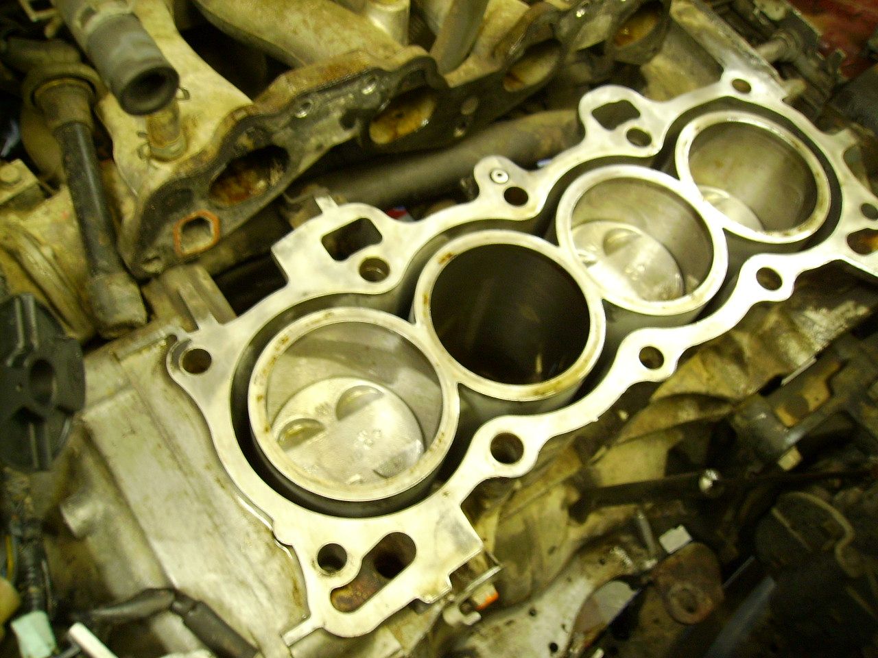

this was picture i took of my 90 std hatch.....i am new to honda and cars so i figured i would just rebuild this car clean it all up and then go for power once i had learned more about cars before i got in head over heals

i am pretty sure if i told you about the rebuild you would be surprised its running.............before anyone says anything i was working a honda dealership when i did the rebuild over the summer and would work on it alittle each night with a 20+ year honda master tech and he has done the same thing to 2 of his hondas one crx and other 89 hatch...........the car only had 130,000 miles but wouldnt start there was so many oil leaks that it looked like someone painnted the engine bay area black so we just left the motor in and pushed the pistons out the top and replaced the pistons rings and all the oil seals and had the head hot tanked so now it runs great......most people freak when they find out that we didnt pull the motor....sorry its kinda long
