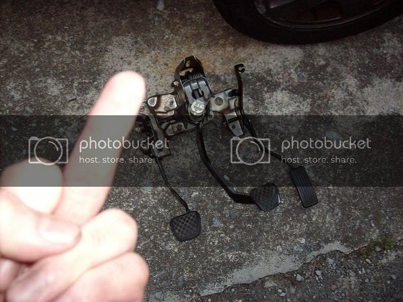

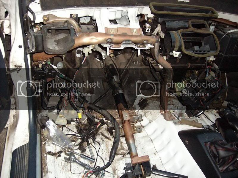

    I swear, taking the pedals out my Honda is just about the damndest thing i've ever done...me trying to squeeze my 250lb ass back in there to disconnect all that shit is a lot harder than it sounds... I've given up on it for a few more days now...might start back in on it Saturday or something...ugh I hate small cars sometimes.
    FWIW: clutch pedal broke, have to replace the whole assembly.
    From Jerm, to the Civic: I hate you

    I don't think its something that happens to every single car, but for those of us whose pedals are very hard to push down, such as mine, it really stresses the welds evidently and they end up breaking in the exact same spot every time, at least on the 88-91's.

    when you toss in a heavy duty clutch...and still run cable, the weakest point snaps.
    87 CRX the weakest point was the pedel.
    ahhh I remember that day like yesterday...
    made a run, lost all control, had to push the car to the pits, found the snapped pedal assy, took it out, drilled holes stratigically and threaded 0.035 wire double twisted and slapped them back in. Missed one run, and still got second in CSP behind that damn purple spec miata.
