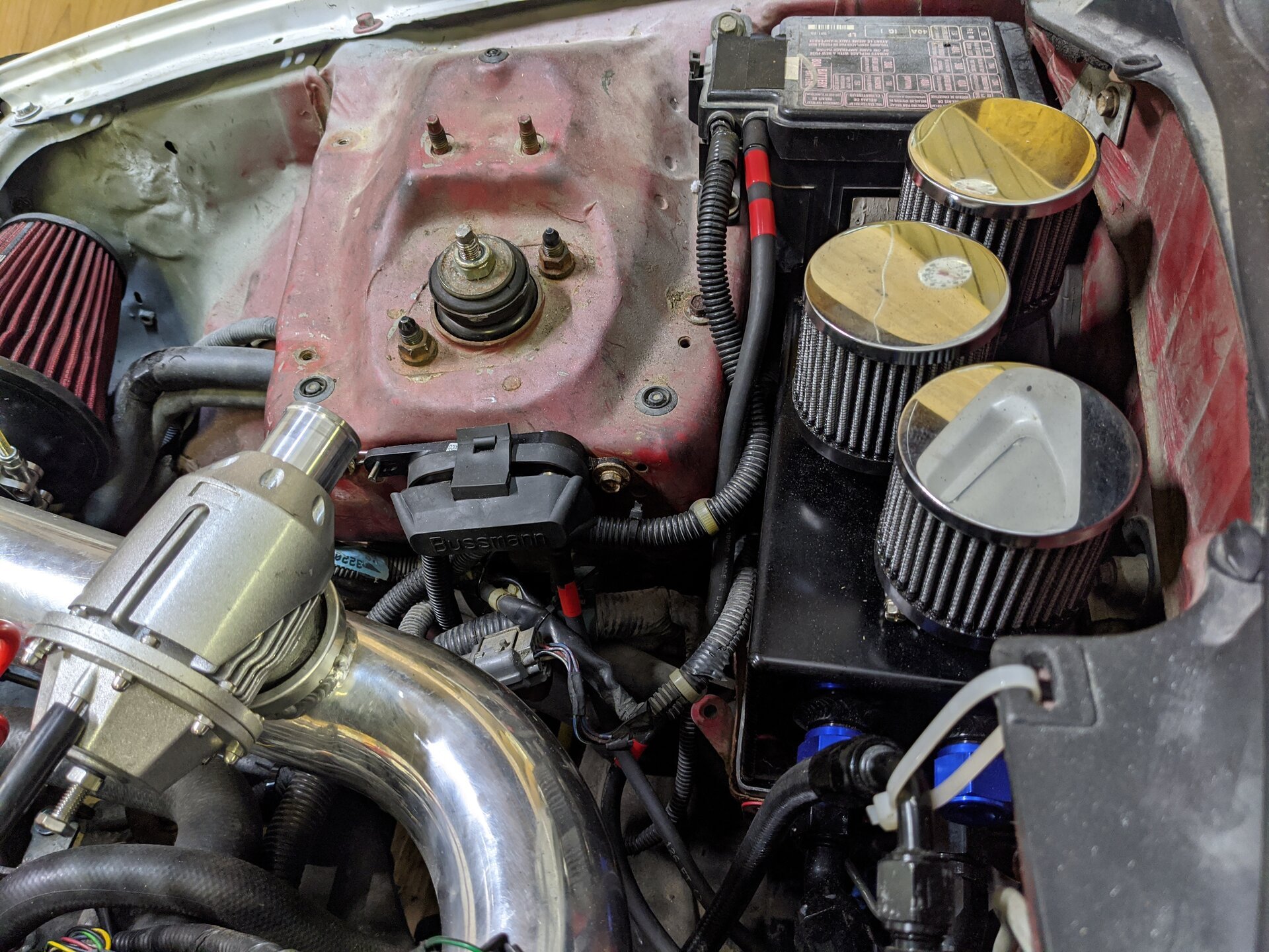

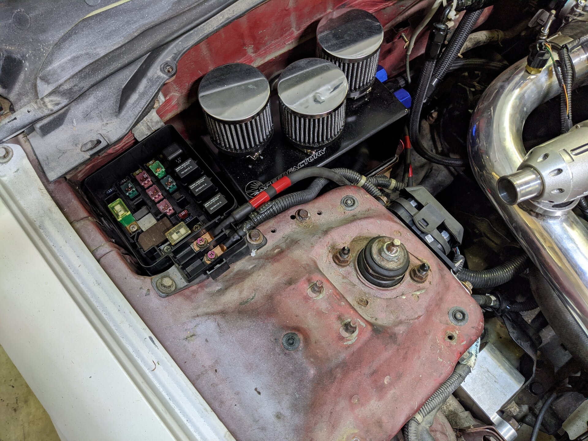

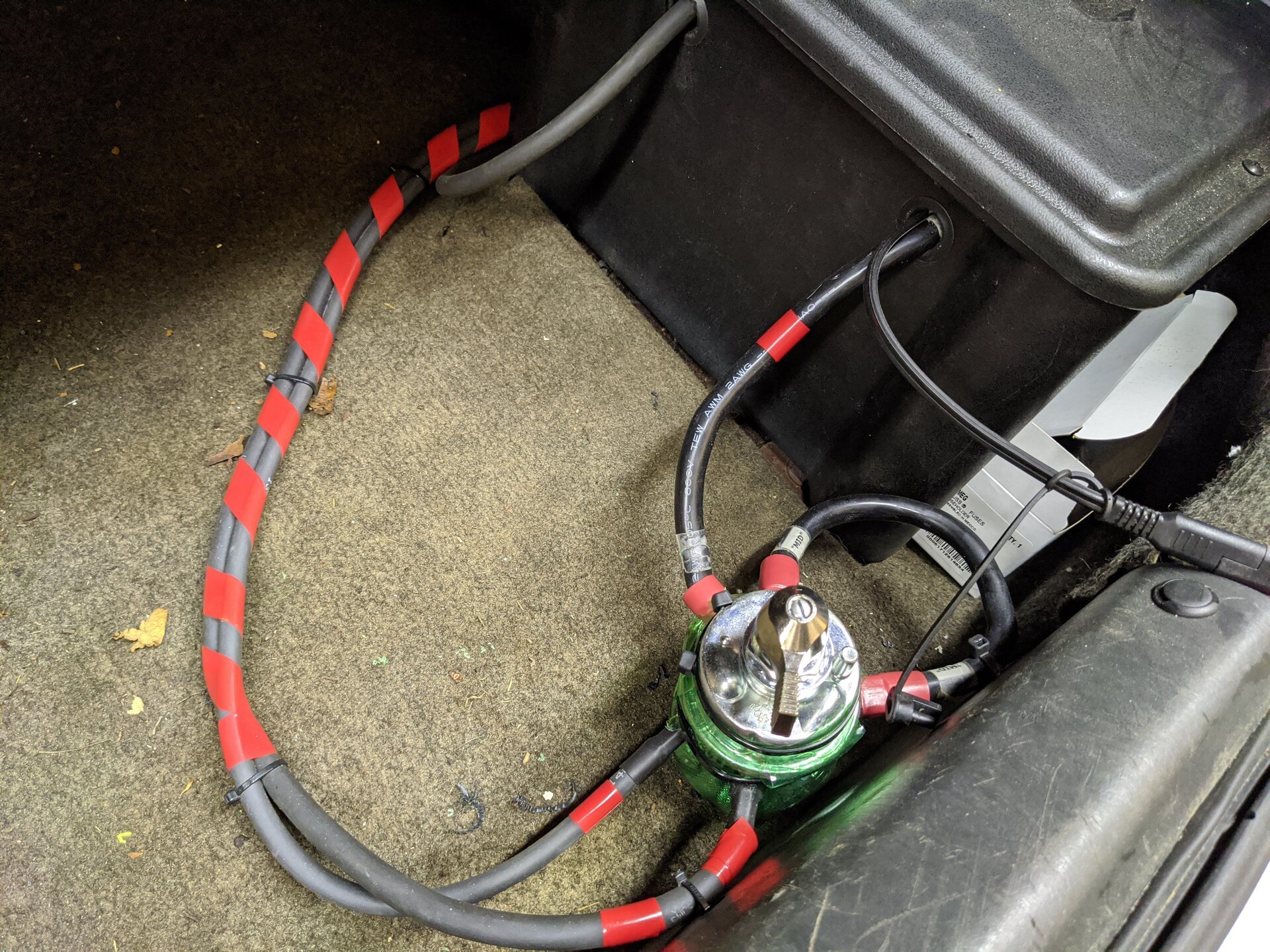

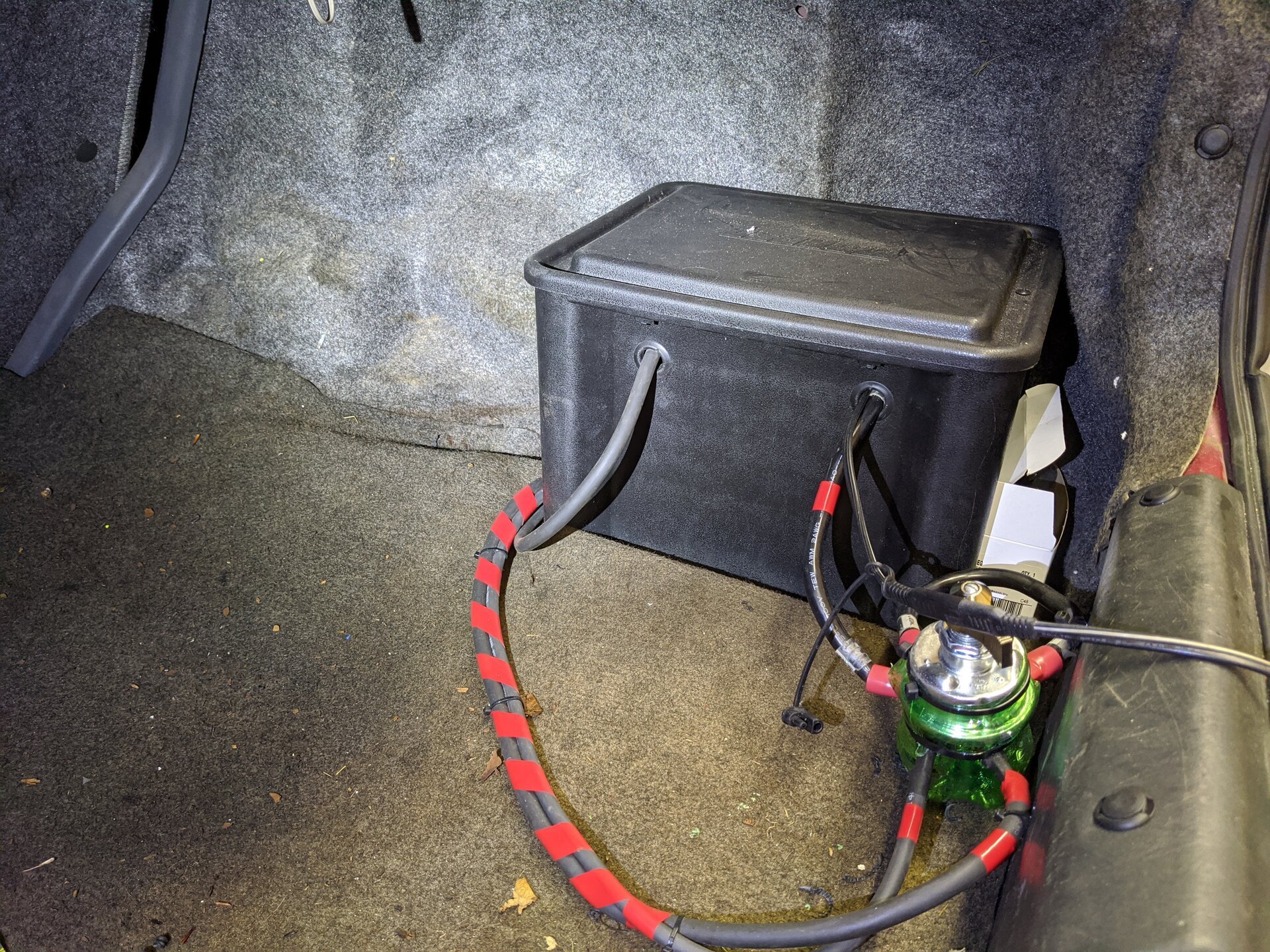

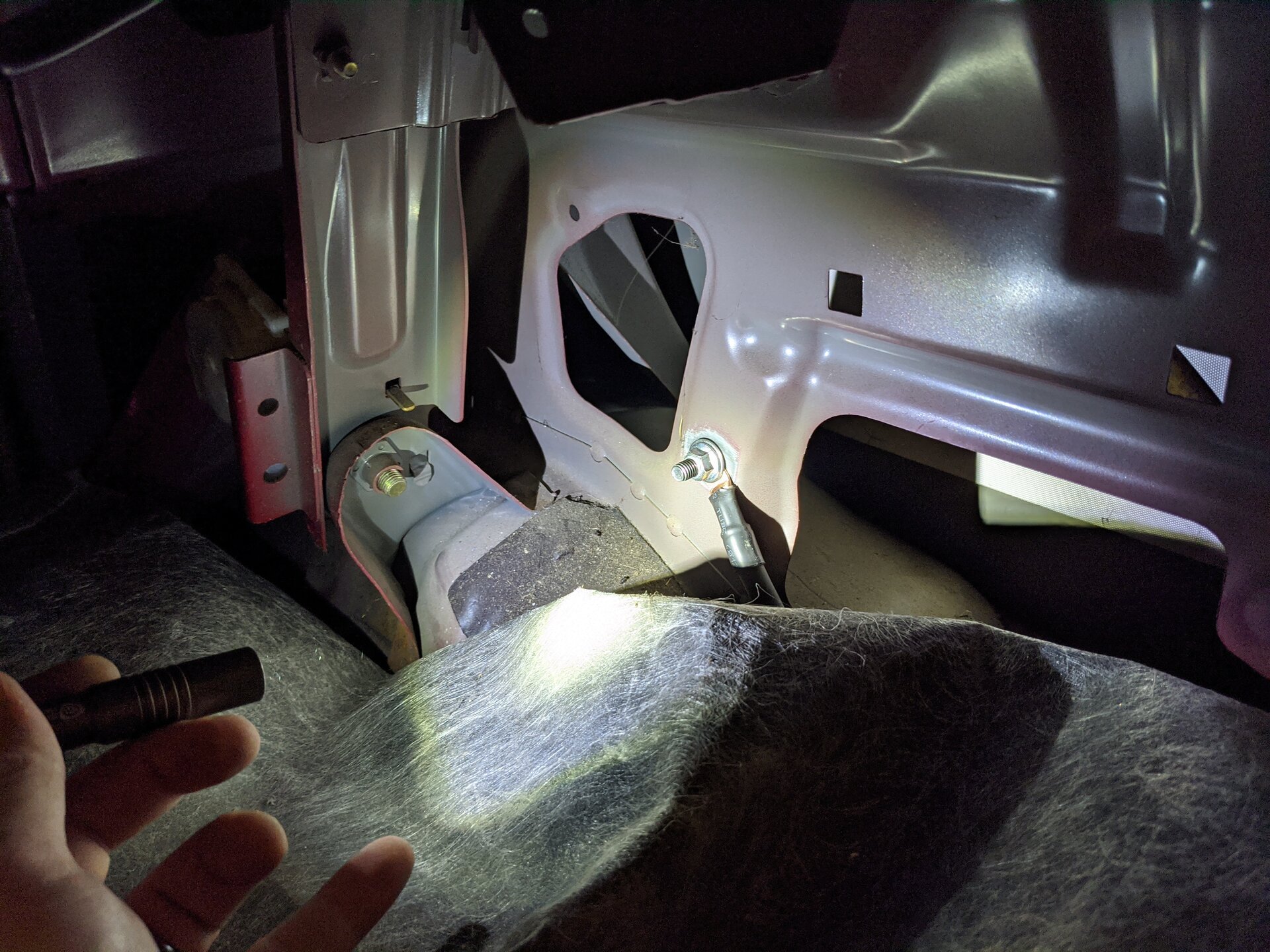

What gauge wire are you using? It looks inadequate. Here's mine, #2 welding cable for starter, #4 welding cable for the alternator, going into a moroso disconnect. #2 is fused at 250a, #4 is fused at 80a.
View attachment 28741View attachment 28742View attachment 28743View attachment 28744View attachment 28745
