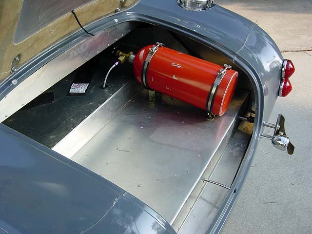

3.) As far as installation goes, i would mount the bottle in the trunk since you want to hide the system from other people. Mount the bottle in the trunk like so . . .
