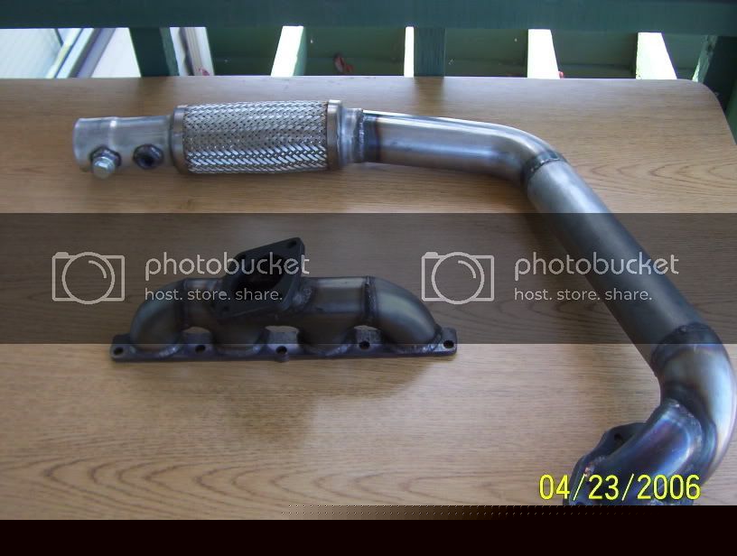

    1. Have a local shop custom make a Exhaust Manifold and Downpipe to your specific needs.
    2. Call and have www.LSDMotorsports.com sell you their kits and or parts for your Boosting pleasures. LSDMotorpsorts is the only one who is actually carrying custom made parts for 3rd Gen's on their shelves. I personally have purchased a Exhaust Manifold and Downpipe from them. Mike(sales@lsdmotorsports.com #1-877-573-6686) - is the guy I talk to everytime I call and he has been extremly helpful and non-baised about setting up my car. I highly recommend them and I know you will be happy too! (sorry just wanted to give my little testimonial...hahaha!!)
    3. Ebay for alot of miscellanous parts like Turbo's, Guages, MAP Bypass links, Oilfeed and return kits, used ECU's, Conversion Harnesses(I recommend emailing the Harness sellers to ask if they can build you one with the pinout above), and high flow injectors. And so forth.
    4. Here is a picture of the www.LSDMotorsports.com T-25 Manifold and Downpipe:
    These parts are made of all stainless steel metal and are of good quality craftmanship. You have other options, I am only using my setup as an example for all you wanting to know - parts etc..

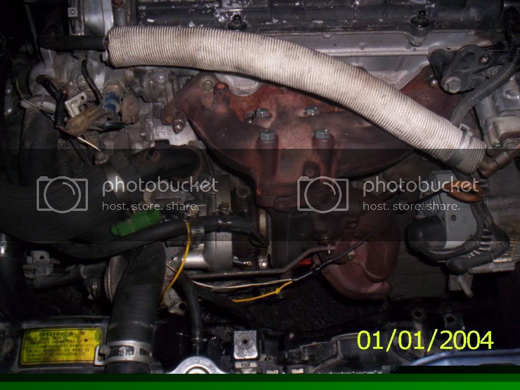

    I decided to upgrade my Radiator fans for more room and better cooling before I put in the Turbo here are the pictures and a little write up:
    Ok here is some pics to give you an idea of what I have to contend with:
    So what do you think??[​IMG] Should I pull the upper hose and just let some leak or what??

    For those of you who wanted to know, you can successfully install a complete Eclipse DSM Turbo system in a 3rd gen and get it to work. His setup up was from a 91 Eclipse DSM. This setup is from a member by the name of Fisher Price.
    Here is a picture of the only one known to date to make it work:
    Quote: "Well for those who said it couldnt be done...here it is....im finished and here are the pics i promised...it fits like a charm...there was some minor grinding i had to do to the block to get it to fit but its nothing major...all minor work...the front mount will fit but only with the bottom bolt only...the top half of it would have to be cut off....O2 housing clears the alternator fine but i think i will make a heat shield for the manifold and the O2 housing so i dont fry the alternator and the power steering line...not bad for 10 bucks on the manifold...free turbo and 4 hours time of beta testing....for all you who said it couldnt be done...well its just been done!!".

    CADster's formerly Bgerk's Setup:
    www.LSDMotorsports.com - Manifold Kit(DIY) I had welded togther
    Intercooler and Piping
    Rebuilt and Polished 14b
    Polished DSM BOV
    Downpipe
    SAFC II- for Tuning
    Wired-up MSD-BTM - for Tuning
    GM 2-Bar map sensor
    walbro 255lph fule pump
    modified Powersteering line to go over and down on the driverside
    Zex Plugs
    *Kept all A/C, Powersteering, Cruise Control.
    Power Output:
    158 w.h.p and 159 torque - Dynoed @ 8psi
    Boostedlude3g -
