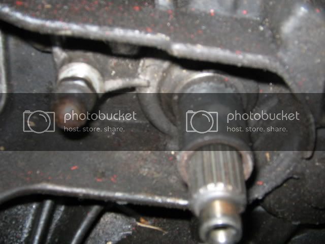

    Ok, I've undone every bolt on this damn thing and I still can't get it apart. Is there some sort of spring pin or something that I'm missing?
    Should I set it on blocks and hammer the shaft?
    This damn import tranny has me confused, I can't get it further apart than this.
    It's probably something simple that I don't know or at least I hope. Thanks in advance.

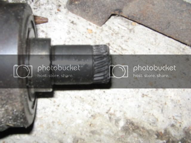

    This is the old one. I'm opening it because it started jerking on me while going about 85. I was just cruising in fifth, not driving like an asshole. It sheered the axle, broke the seal, and the fluid went everywhere.
    I'm opening it up to see if I can fix it for sale or use =P.

    There's a snap ring in there. On the "pointed" end there should be a plug about 1" in diameter, use a 1/4" ratchet to remove it. Then you will need snap ring pliers that pull the ring together(it's a expand-type snap ring; holds a bearing to the case). After that, shimmy and shake and the case will come apart.

    I know EXACTLY what you're talking about now. I saw it and was like "Wtf is this shit?" at first. Thanks a ton. But of course, I have another question =).

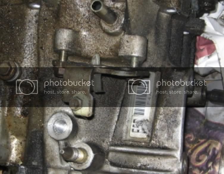

    Ok, so if all these transmissions are the same, will their model #'s be the same?
    This is mine...
    I hit the tag when banging the thing out so you can't read part of it, but the two #'s are "5FE" and "P4A".
