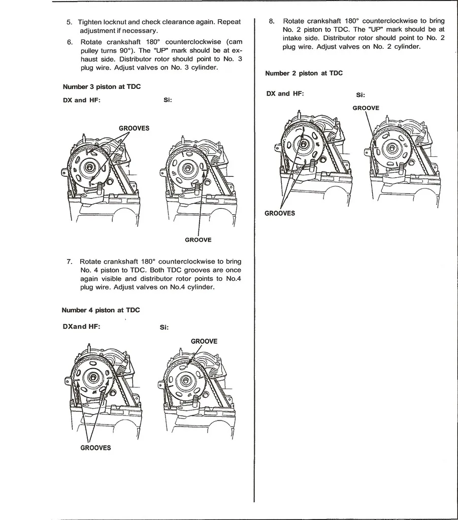

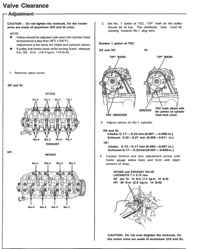

Taken from the repair manual. I attached it. It's the entire repair manual. I know it says 88 CRX, but it's for 88-89.
5-8.pdf in case you wanted to check again.

Heres what your looking for straight from honda. Hit me wit sum rep point if you feelin the info!!!!!!
