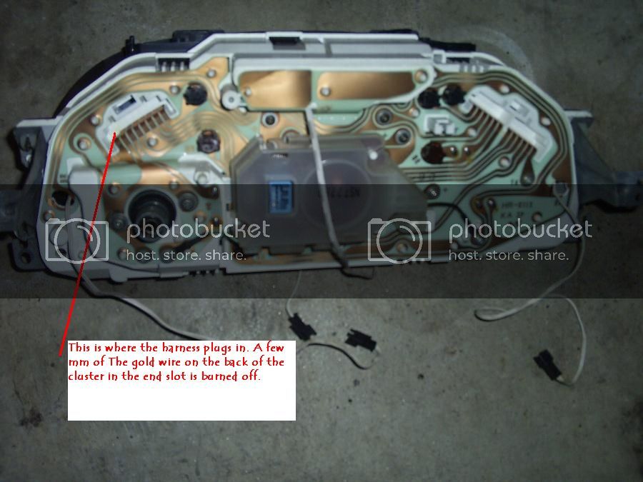

    Maybe pull the cluster to see if the printed circuit decal (not sure what it's called) that the bulbs twist into aren't pinched anywhere.
    Check your grounds again.

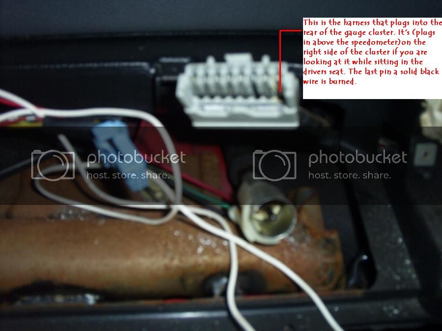

    I pulled the cluster and found a burned area on the back of the cluster, and a wire burned around the end where it plugs into the cluster. The rubber coating is burned off of the speedometer cable on the transmission end as well. I still have not found what caused this. The only thing I came up with is something shorted out inside the cluster.

    I thought so..
    I picked up a civic si that a shop couldn't get going..
    Bought it, took about 2 hours pulling all the alarm system out and drove it (beat it) for 3yrs and still got 37 mpg
    You don't know what caused it??
    Pull all that ricer poop out of it, fix the wires and it'll be fine.
    There's several harness on Ebay. Message them and see if they have the dash harness.
