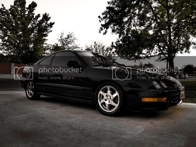

    well, they're for a 96-00 Civic, so they dumped it out in the front (got that raked look).. thats why they gotta go.. much lower than i was expecting and the woman is getting sick of it, so i gotta do something.. found some ITR springs for $100 shipped, so i went w/ those.. gonna put on my agx's

    heres a pic of it though

    So is that pic with the ITR springs or H & R's... What's the drop front and rear? I wanted the adjustability coilovers offer but that drop you got right there looks about what I am looking for... Can you get me more side shots and what not?
  12. eg6sir
    21,707
    those are the H&Rs .. and for a Civic they give a 1.75"f /1.5"r drop.. but with the weight of the integra they dropped more.. not quite sure how much though .. i'll get some pics up

    here ya go.. you can see the raked look in the first pic.. 2nd pic is the rear gap, 3rd is the front gap, 4th pic is the underside clearance (of course thats the under plastic part of the bumper hanging low though)
