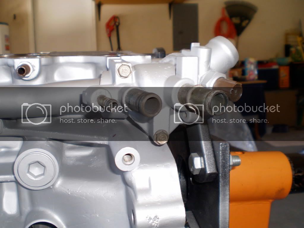

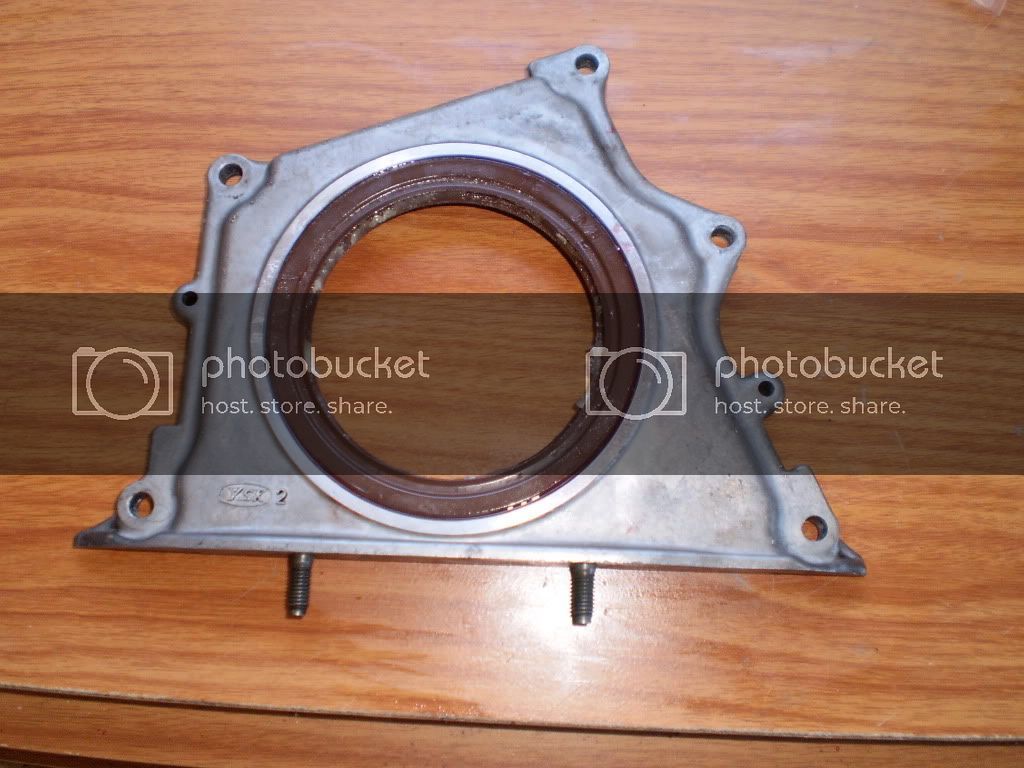

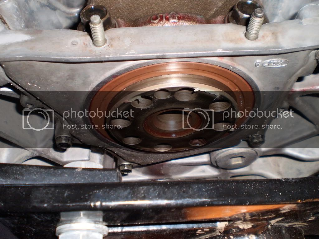

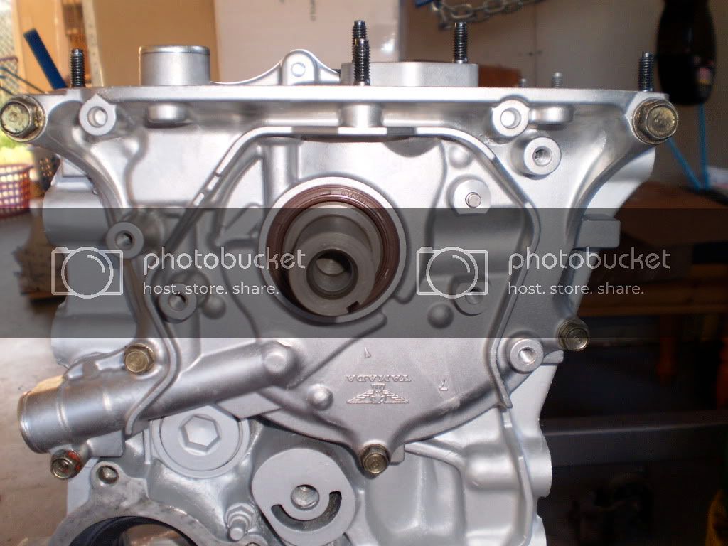

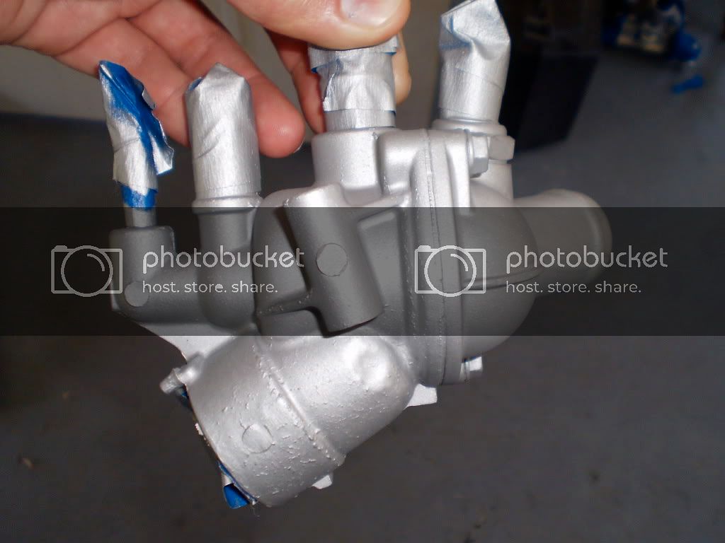

I got some work done on the engine yesterday. I had a little problem. I must have lost one of the rod nuts when I checked the bearing clearance a couple of weeks ago. I had to order one from the local dealership and it will be there tomorrow. So all the rods are torqued down except the #1 rod. I put on the oil pump, rear main seal, and water pump. I stopped at the water neck because I forgot to clean it up. I cleaned it and painted it to match the engine and put it on this morning.

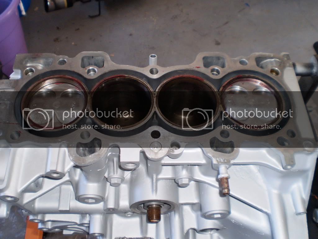

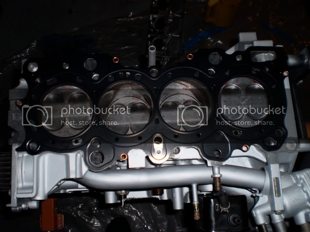

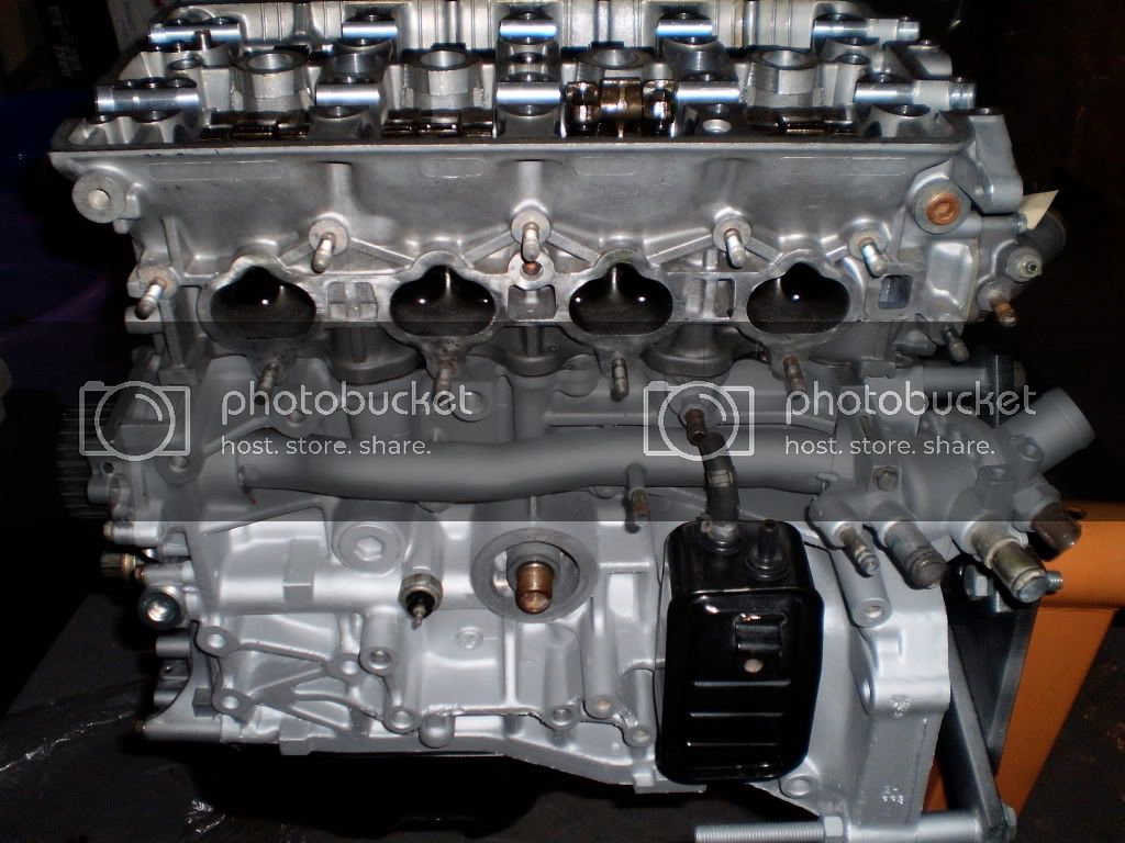

I got the head on tonight, and I will upload the pics tomorrow. Anyone have an answer to my knock sensor question?

Thanx. Well I got called into work today so the rest of the head will have to wait until tomorrow and I left my camera at home, so the pics will have to wait as well. More updates soon. I hope to have this in the car and running by the end of the month.

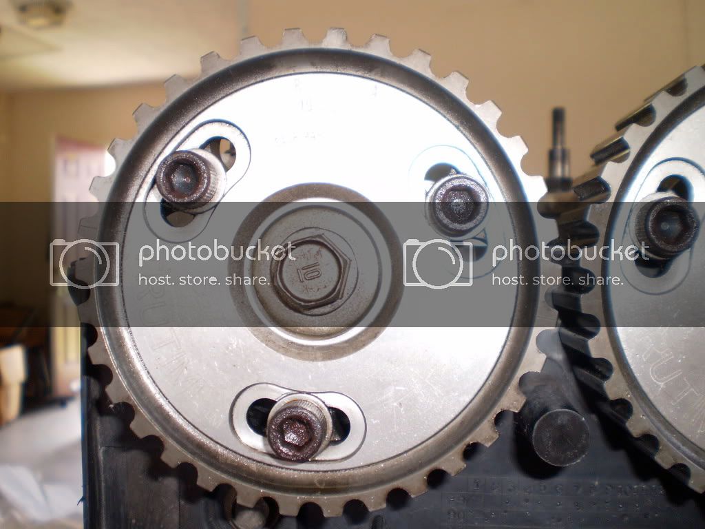

I also have a question about installing the cams.I am not sure what is top dead center on these cam gears. There are paint marks on one sprocket that line up with the zero on the gear then there are lines etched into two sprockets that are equal distances in both directions from the paint marks.
Do they look like they are set correctly or is TDC when the white marks face each other.

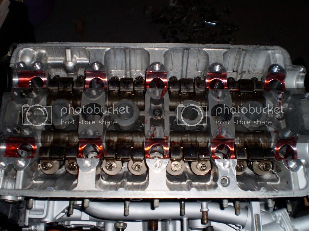

I figured out what marks to follow. I installed my cams and the exhaust cam is pointed at tdc like it should be, but the intake is pointed at the 11 o'clock position. I can turn it to the 12 o'clock, but when I let go it falls back to 11. It looks like the #3 cylinder rocker arms are what is preventing the cam from sitting at tdc. When I install the belt can I just hold the int cam at 12 o'clock? When I adjust the valve clearance will it fix the problem? Or should I take out the cam and try again?

I am going to try a couple of things tomorrow and see if I can get the cam to sit properly. If that doesnt work I am just going to roll the cam forward with a wrench while I put the belt on. Its only off by about a 1/4 of an inch and everything spins easily, no binding or grinding. I dont know if thats a bad idea, so if it is let me know please. Anyway here are a few more pics of the progress.
usually when i install the timing belt on my car, it takes two people. i have to have someone hold the intake cam in place, and then i slip the belt on. the way you are doing it is correct.

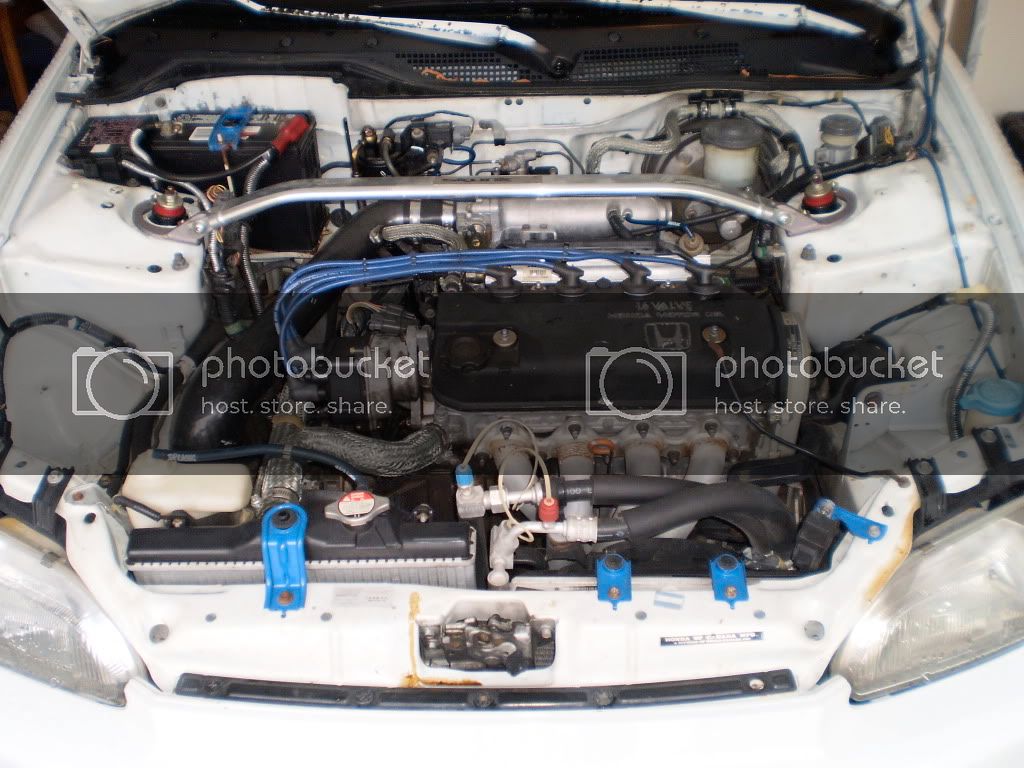

Ok well the build is going slow for the next two weeks. I have a film that I am working on that has to be done by the 1st. I did however mock up the rest so everyone could get a little taste of what it will look like finished. Do any of you guys have a spare timing gear cover? The plastic piece that goes over the belt and gears. I seem to have misplaced mine, so if you have a spare laying around let me know and I will buy it from you. Anyway here are a few pics.

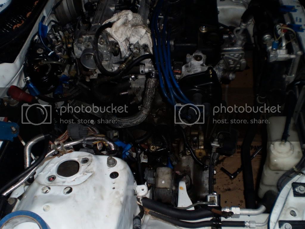

I pulled the car into the garage yesterday and started getting the engine ready to pull. I got most of the plugs unplugged. I took out the rad and most of the other parts that will be in the way. I checked the high and low lines to the ac before I started and there is no pressure in either line. If there is no pressure then it is safe to take out correct? I want to get rid of it, but I am a little nervous about taking it apart. Here are some pics.

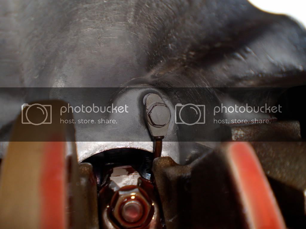

Today I will tackle the BITCH pin.
