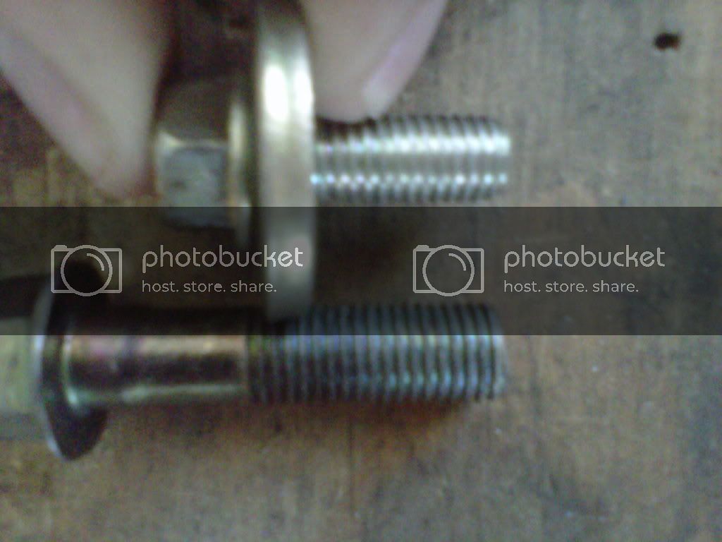

I havnt actually found an 8 bolt which I am assuming is way smaller than a #8 screw lol. But I just went and took a video (which my black berry will not let me send) and a few pictures. I went through my random bolt bucket and actually found the correct size that I need unfortunately the bolt is way to long. I am currently uploading the pictures to photobucket, should be able to post them shortly.
The 10x30
The Bolt that fit

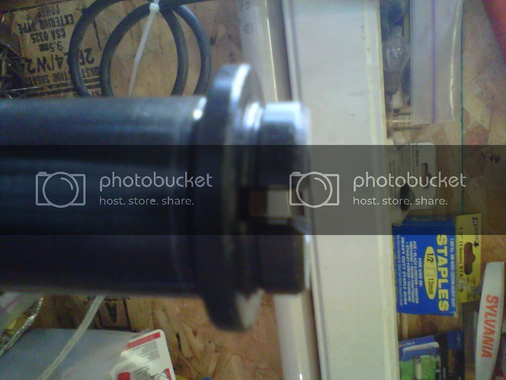

That's a stock cam?
This is the only pic I can find right now of a stock SOHC cam, blurry, I know.

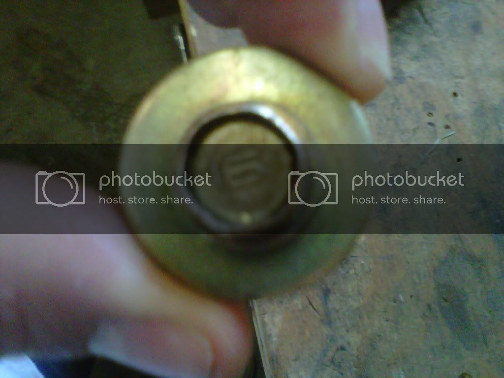

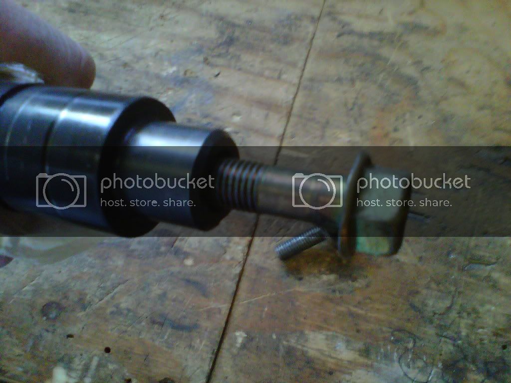

I never said the number on the bolt is the size! The other doesn't even say 8 it has a S imprinted on it. The point I'm making is that the 10x30 is the same part number as on the link you sent me, that I picked up from Honda yesterday and is to small. The other bolt is significantly larger as you can see in the pics
I've just measured a complete OEM bolt and it's definitely M8x1.25
That transmission or starter bolt is definitely larger than what a stock cam would use.
Yeah I think someone gave you the wrong cams, honda cam bolts should take a 12mm wrench.. None of them take any bigger bolt.. D and B series take the same..
