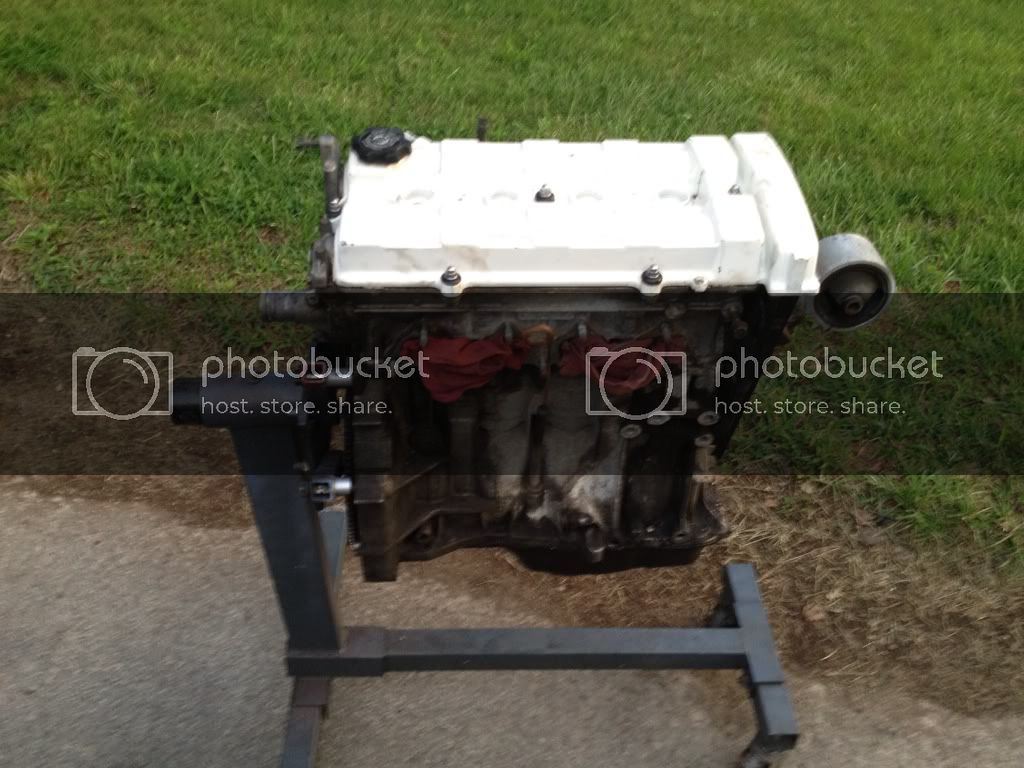

Ok let me start of by saying yes I know this is an obd1 motor and the car is an obd2a. This swap I'm doing is not for me. I'm helping a friend out who is not very mechanically inclined. I have been doing some research and I know the better candidate for this swap would be the b18b1, unfourtantlly we can not find one in our area for cheap. So this is what we have to work with.
So here is what I have gathered so far:
B18a1 engine complete minus the dizzy
B16 5 speed trans sc4 I think is the number
Half shafts and axles
Rear engine bracket '99-00 civic si
Left hand engine bracket "same as above"
Front transmission bracket "same as above"
Front engine bracket '94-97 del sol DOCH VTEC ( this is to keep ac )
I also have a shift linkage from the '90-93 Ls
I think this will at least get the motor in the car. I shouldnt have a problem getting the motor in the car. Im just going to need some helping with the wiring, ecu selection ect. I keep reading that the difference between the a1 and the b1 is the obd and a couple hp's. Is this true? One of the questions I have trouble finding the answer to is, can I make the b18a1 obd2a to save having to buy/make a jumper harness for the ecu? That way I can run the obd2a ecu and dizzy. Also will the dizzy from a b18b1 fit on a b18a1? Will the axles from the b16 trans fit in the hubs on the 96? I'm sure I will have more questions as the swap goes on. We just started cleaning up the engine. This week we will be replacing timing belt, complete top end gaskets, oil pan gasket, oil and filter, water pump, thermostat, spark plugs, adjusting the vales and other routine maintenance. All help and suggestions will be greatly appreciated.

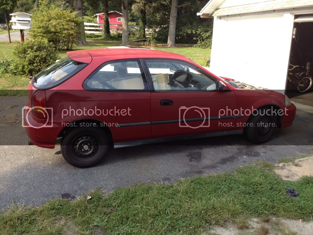

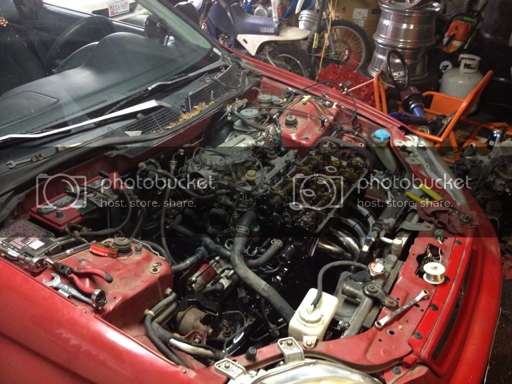

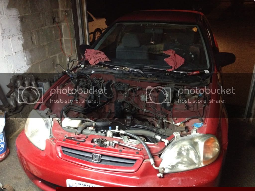

So here's the car that I'm working on. Ill post a few pics of the progress.

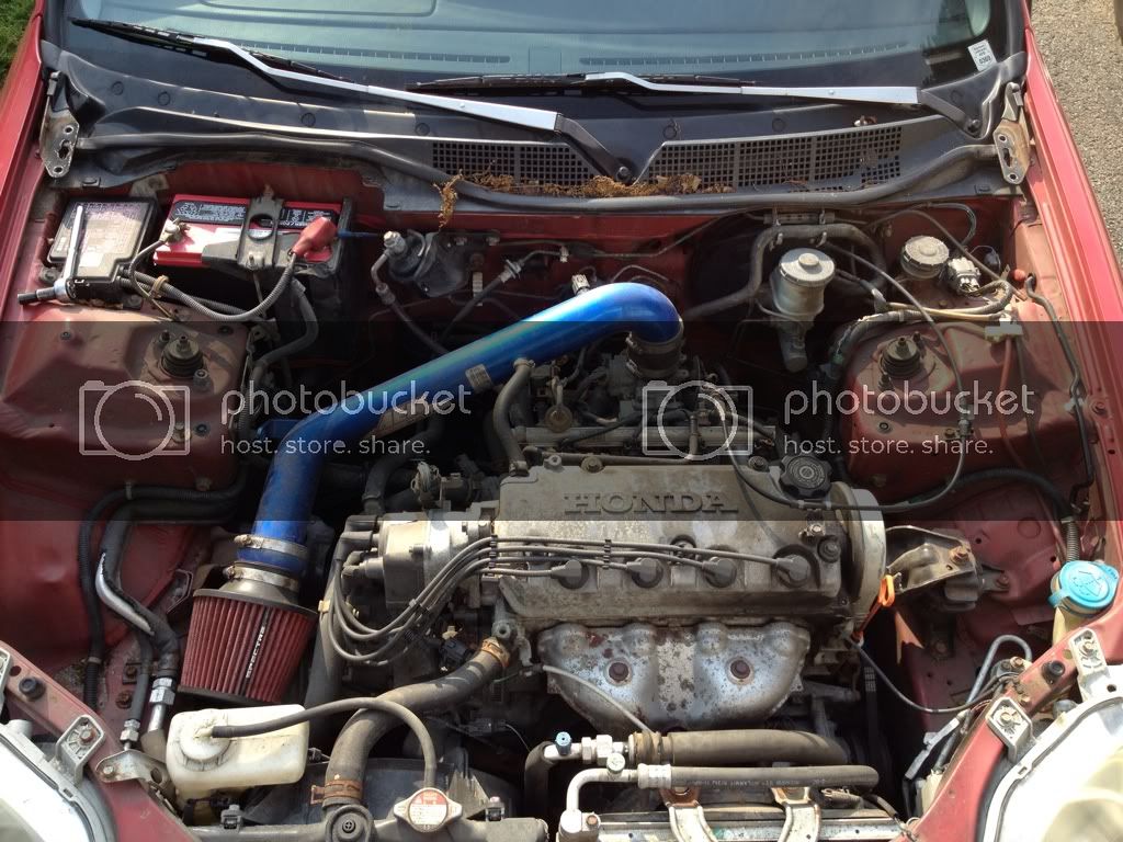

Out with the Y7!
Before.
After a good wash.

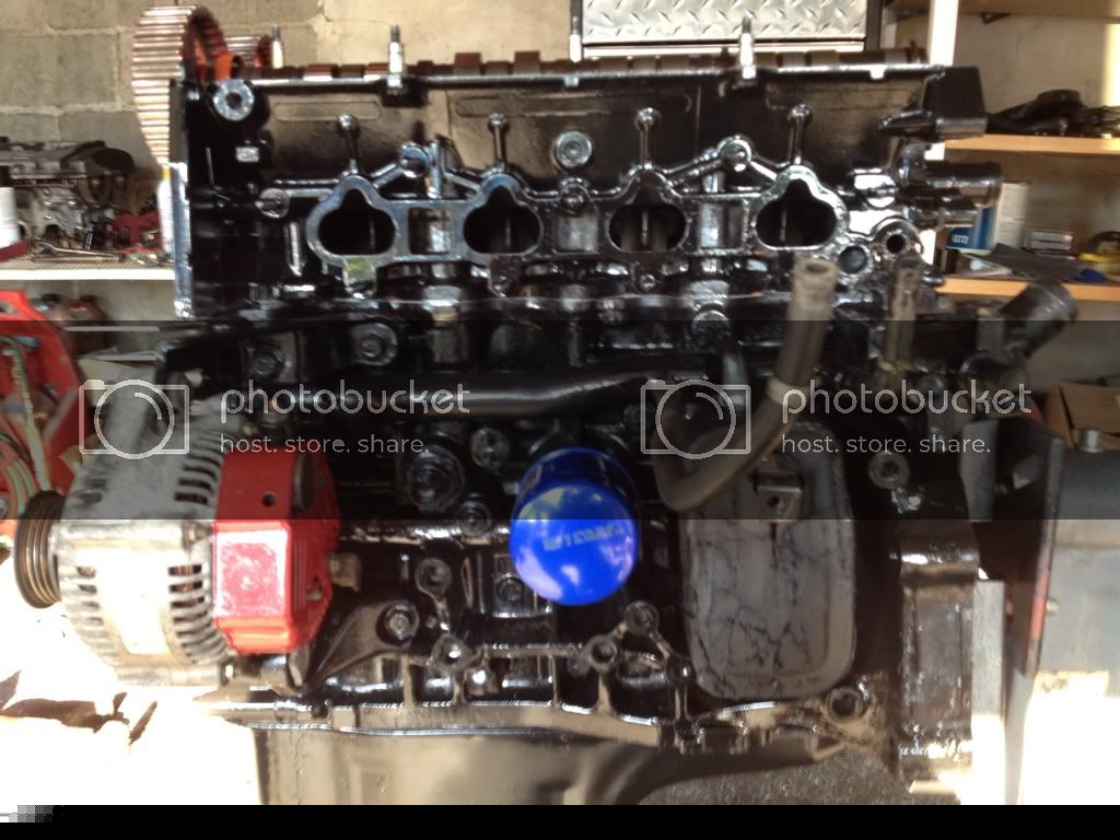

Some fresh paint. Still waiting on the valve cover.

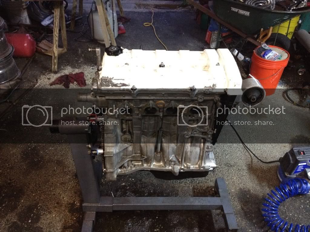

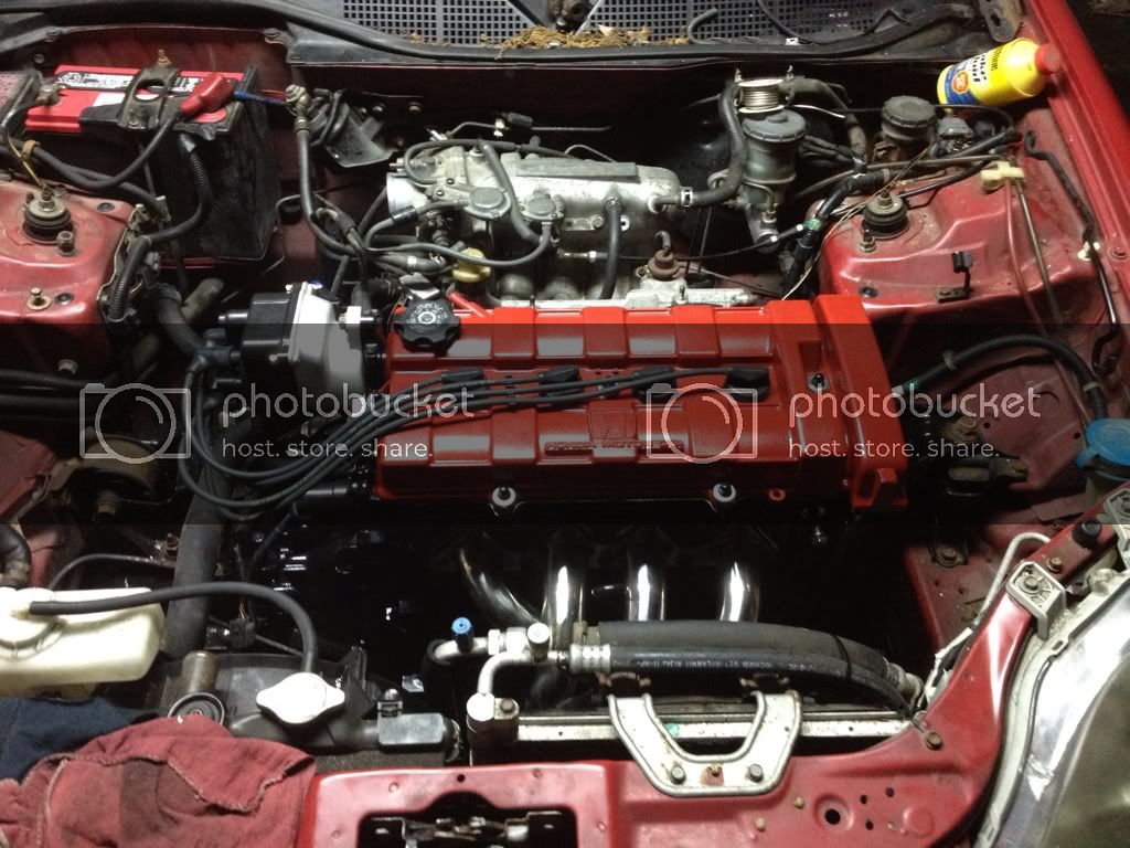

Finally got the valve cover and painted. Engine is in and it's about 90% of the way complete now. Tried a test start tonight and she will not start. I checked the timming, firing order, check engine codes, ect. Still won't start. I had a gut feeling to check the compression and bingo. Only having 30 psi in two cylinders and 0 psi in the other two could be why it's not starting. So I broke the bad news to my buddy. He has decided to go ahead and buy new rings and bearings. So tomorrow I get to start pulling the pistons out to change the rings, rod bearing and crank bearings. Buy the time I'm done working on this thing it will be damn near brand new.

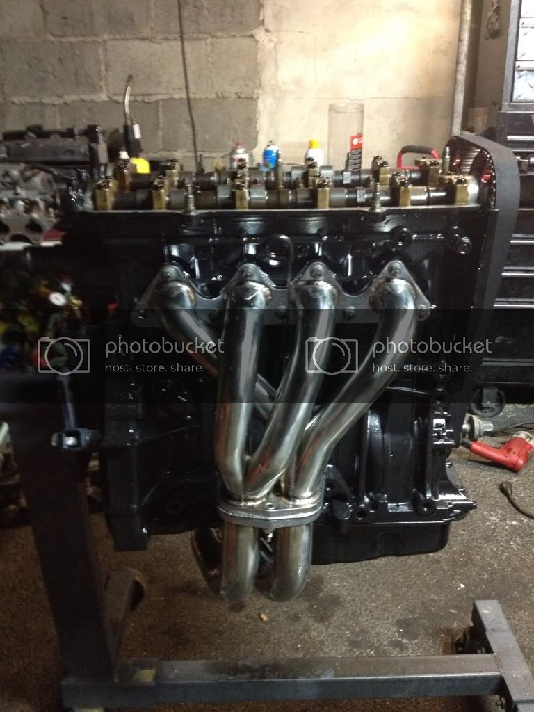

Okay small update. Tore the whole engine down, replaced piston rings, rod bearing and crank bearing. Along with new front and rear main seals. Got everything back together and still low compression. So I checked the valve lash and it was way out causing the low compression. I readjusted the valves and it started right up. It was running very poorly. After a couple frustrating hours I notice he had bought an automatic ecu. I ended up pluging the stock ecu in from the 96 dx civic and it runs 20 times better. Except for when your taking off from a dead stop or barely pressing the throttle when trying to cruise. The best way I can describe the problem is its like having a dead spot when giving it gas. It revs up fine to about 1500 rpm then has a dead spot but after you get past that it runs great. I'm not sure what the problem is. It's throwin a code for the 2nd o2 sensor and the iacv. I know the o2 sensor is cause its not hooked up yet and the iacv is cuz I switched it from a 3 wire to 2 wire. Anybody ever had this problem or might know how i can fix it?
Well finally got the obd2a p75 manual ecu. I hooked it up and the car seamed to run better. I didn't have that dead spot in the throttle like I did before. Now its throwing code 91 fuel tank pressure. When I had the other ecu's plugged in I never got this code. Now all of a sudden it's throwing this code. Any idea of why it would be throwing it now?
