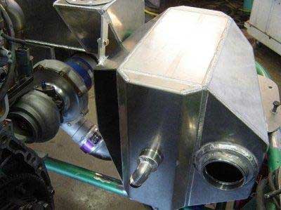

it doesnt look like any water to air intercooler i've ever seen? but you never know it could be

Originally posted by pissedoffsol@Sep 24 2003, 04:25 AM
this one?
Originally posted by GSRCRXsi+Sep 23 2003, 09:52 PM-->i circled the box that i think you're talking about... i'm pretty sure it's a fuel cell.and what is that box thats conected to it on the firewall?
Originally posted by SiR Kid@Sep 25 2003, 03:34 AM
Not the water to air... the Air to Air from Full Race... Jeez. I guess I'll have to find the pic Art posted a while back...
i'm pretty sure this is the IC you're talking about...
SiR Kid@Sep 24 2003, 03:11 AM
PWR = teh suck.
He should have picked up the Full Race FMIC they have that works perfectly with that manifold/turbo setup.
Originally posted by kylemarhx+Sep 25 2003, 03:58 AM-->GSRCRXsi@Sep 23 2003, 09:52 PM
Originally posted by SiR Kid@Sep 25 2003, 08:47 PM
The cell in the circle is a water cell for the intercooler.
The "bubble" in the intake piping IS the intercooler. It's made by PWR, and it's made for EXTREMELY high flow environments, but unfortunately, it doesn't cool very well, and can cause detonation issues at high IAT's.
They work great on Drag car's though, because with icewater in the reservoir, the cooling capacity goes tthrough the roof, with very little pressure drop.
KYLEMARHX, yeah, that's the intercooler I was thinking of.. I can't find the setup pics I know existed, though. Odd.
Originally posted by Calesta@Sep 25 2003, 11:10 PM
The fuel cells on the drag Hondas that I've seen look just like that. Hell, Intercrew's looks exactly like that one, except it's mounted on the front of the car. It only holds one gallon.
