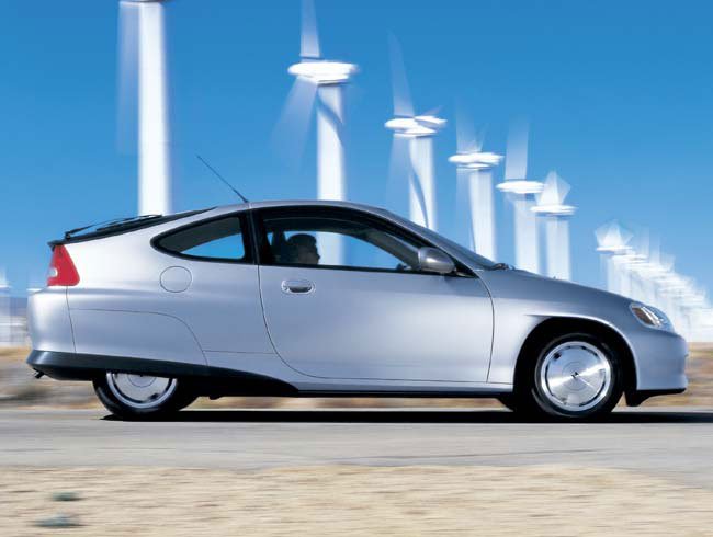

Maybe going to paint the rims. Any suggestions? This is my color:
Probably the best suggestion.
