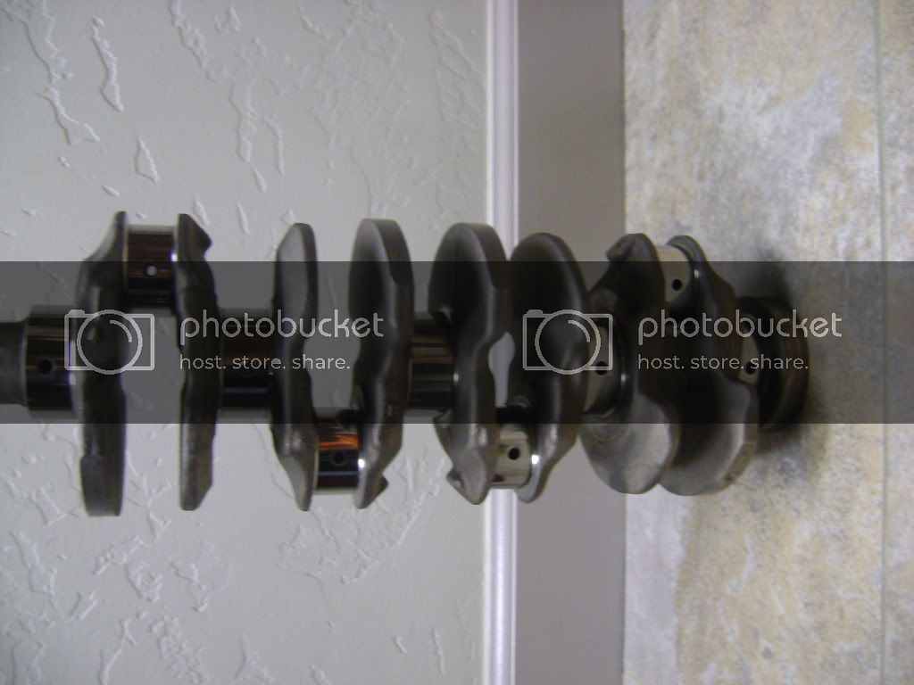

yeah this crank had crower h beams and je forged pistons. I thought the crank was ballanced on its own? Ill ahve to check into that.
The crank is usually balanced to the reciprocating "BOBS" or "Bobweights" I don't believe they're balanced to "O"/zero. That's why they have to add Mallory or grind off material.
The 'otherside' has to weigh the same as 'that side'.. Now your're talking about a circle, but we know that the combustion process happens only at one 'side', but the other side has to compensate per/detonation right?? (firing order)
I'd take it to a good shop and ask them. It shouldn't cost too much to grind but adding mallory is more expensive.

Im gonna check If its not too off, if it is then Ill just buy another used crank or take one from the junk yard.
This is a econo build, I started with only the head. whant to see total end cost.
Sorry man, I just wouldn't want you to be all excited, fire it up and have a BAD shake to it. ('been there too many times)
If you haven't pressed the pistons to the rods yet, maybe just have it all balanced to eachother.
4cyls shouldn't be that much $$ to balance. The 'bobs' are just 180 out. AGAIN check out your local machine shop.
E
thanks, I read that after 78civic posted. Im gonna take it to my machinest see if we can salvage it, or fix it under $100. if not then Ill just junk it and buy another stock crank.

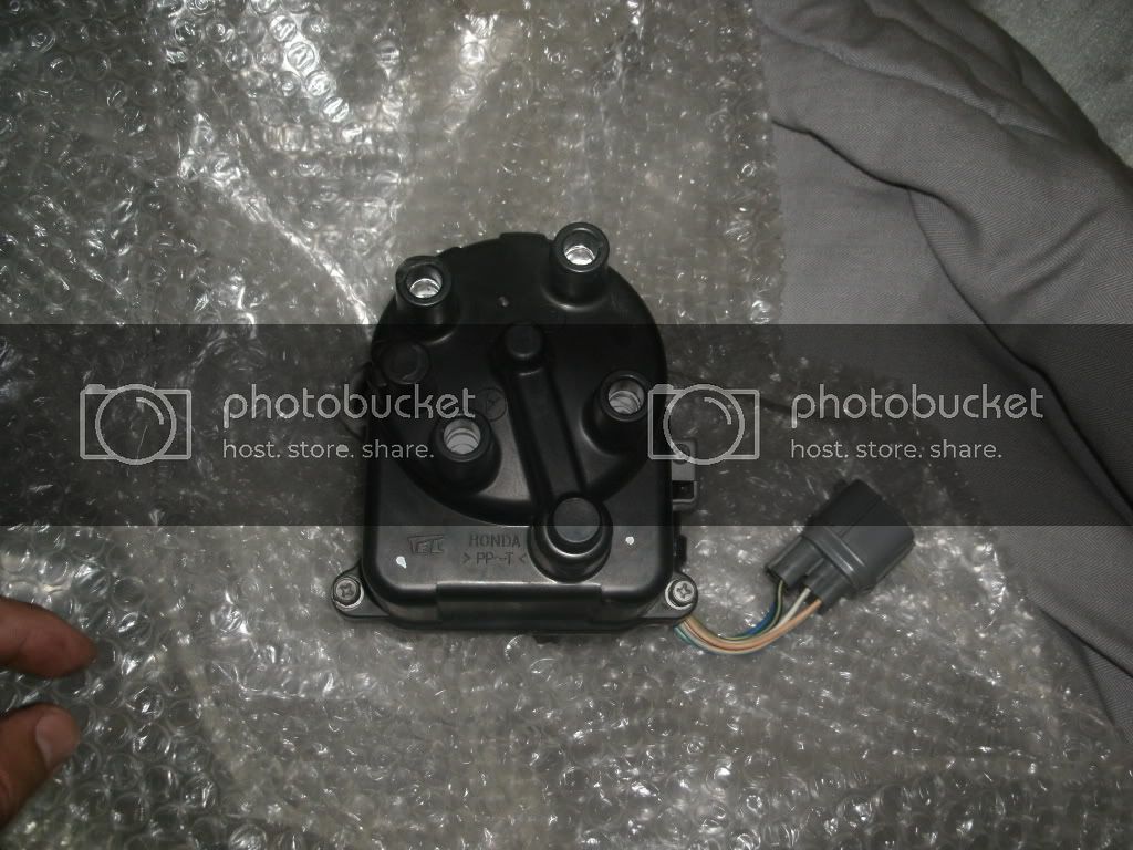

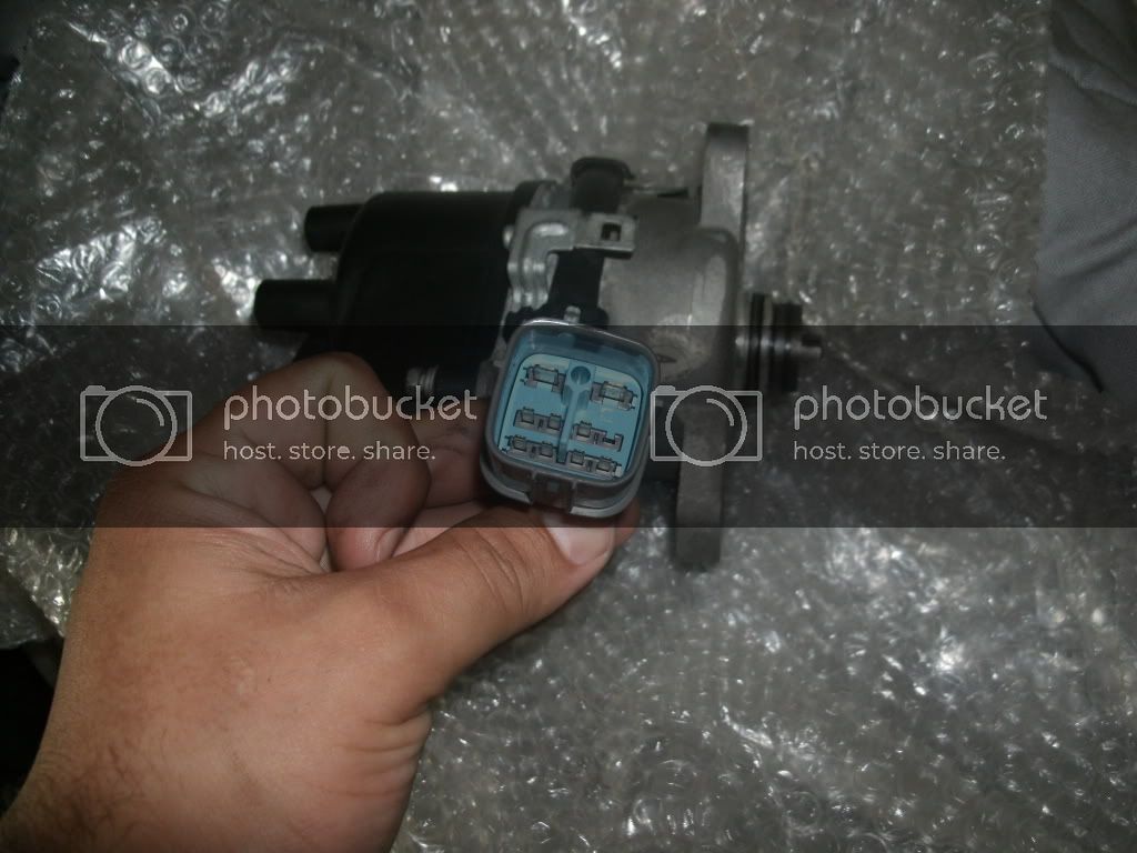

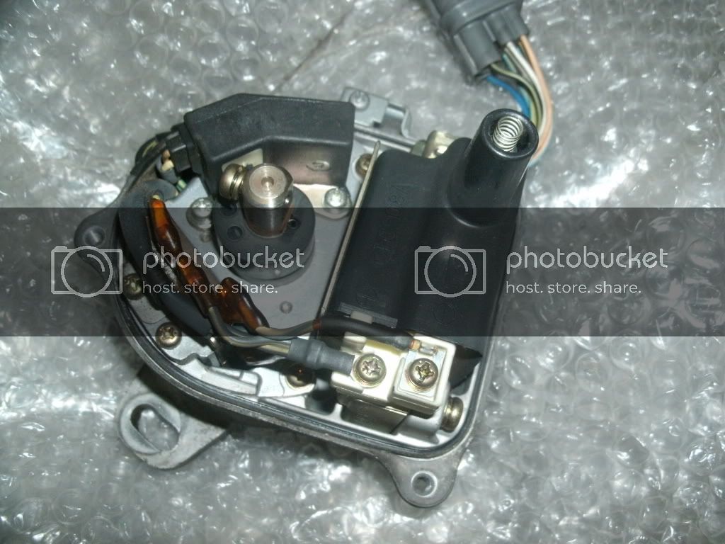

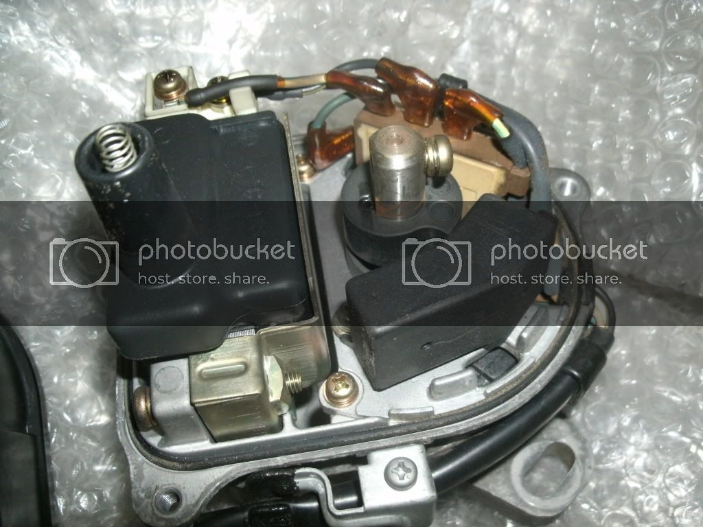

OBD2 dizzy that came off of a JDM b20b so it has no more than 35k miles! ;) scored it for $65 shipped.

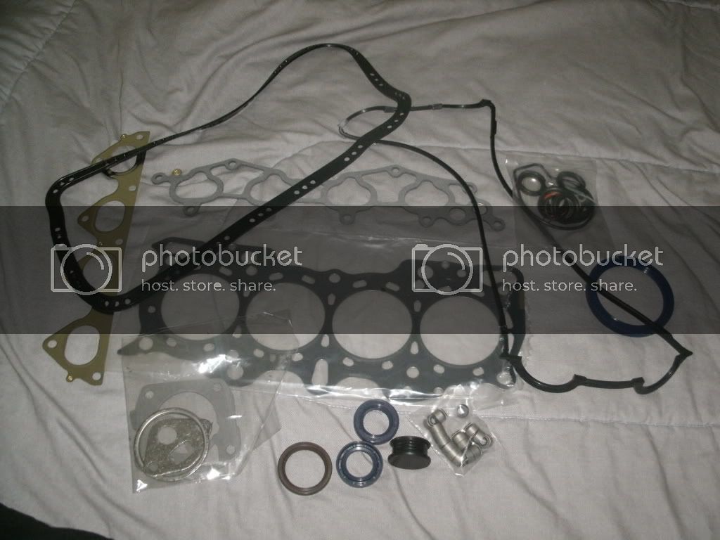

Nippon racing gasket kit, OEM quality for $87 shipped!

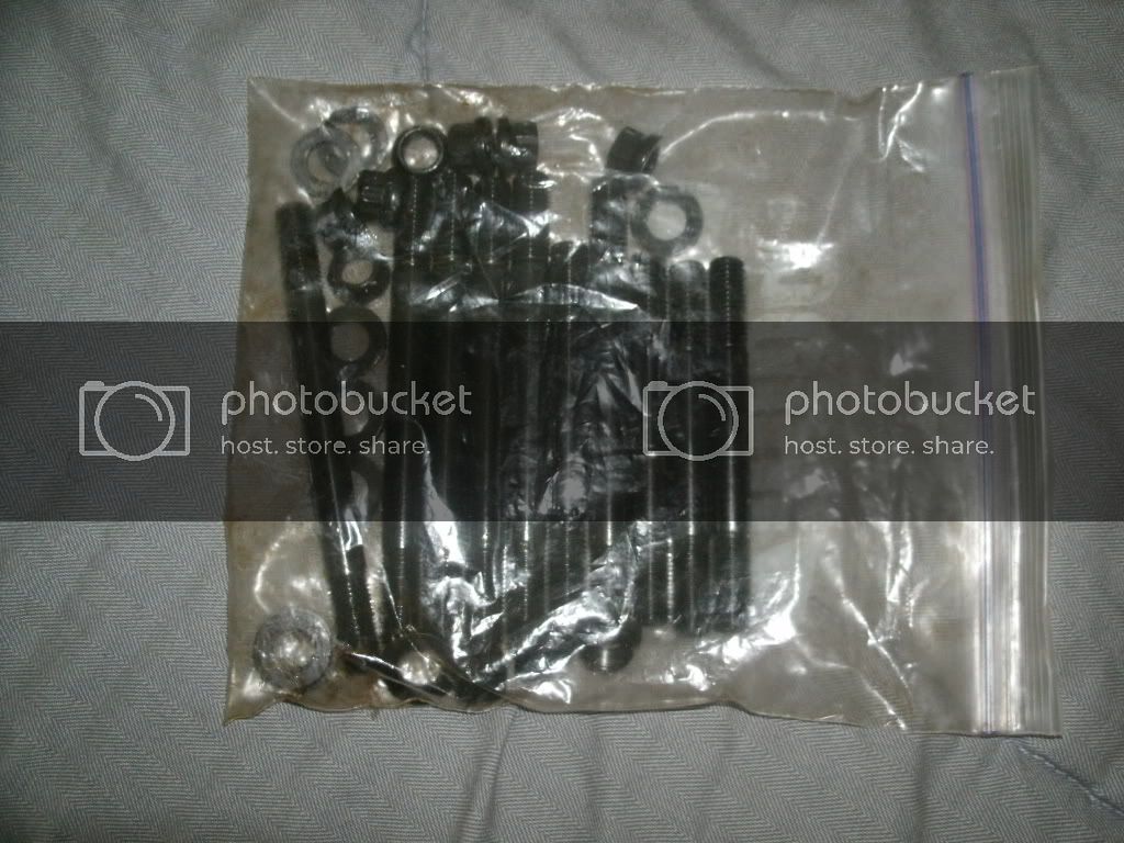

ARP LS main studs Got em for $60 shipped, never stretched :o
dizzy will be converted to obd1 or ill buy monotech jumper.

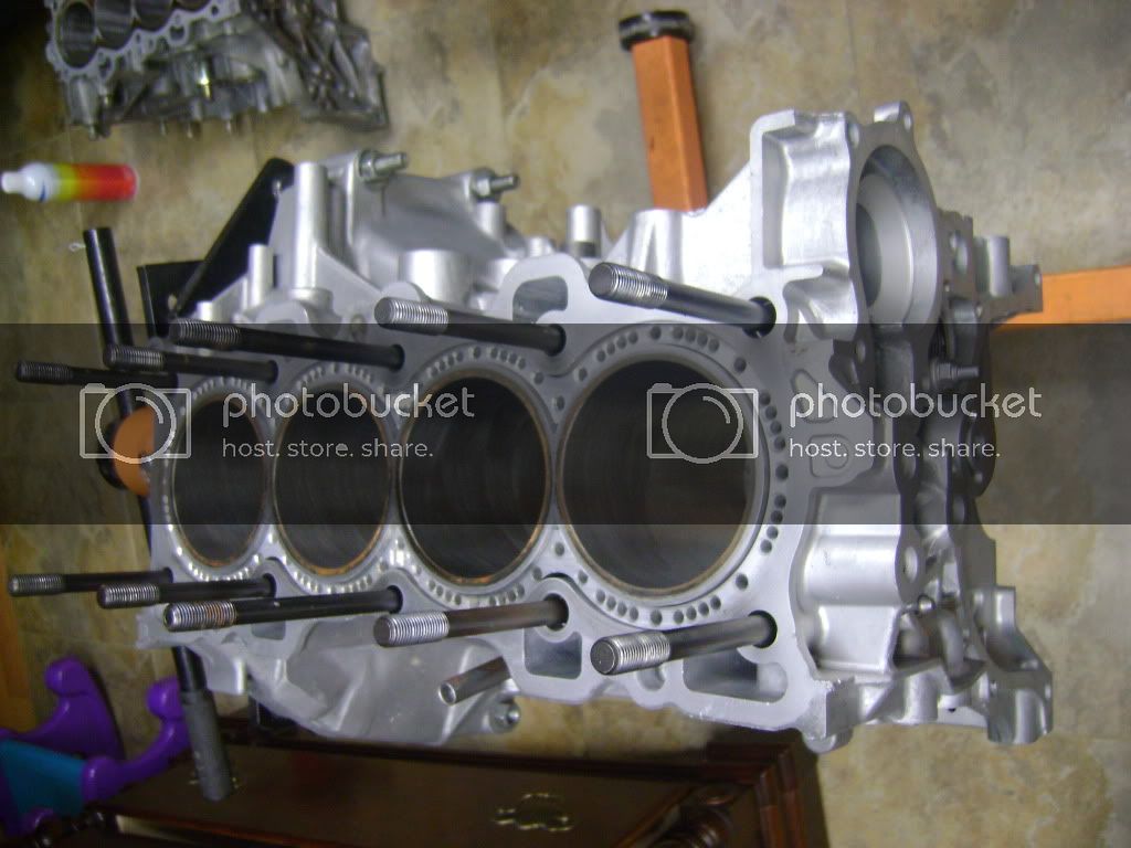

Block should be back by friday but im gonna go camping for the weekend so ill post pics when im back.
Ask them to blow out all the threaded holes for you and wipe the cyls with a light oil even before you wash it down..
BEFORE YOU LEAVE thier shop, ask if the cyl tops have been chamfered so you won't chip or break a ring going in..

Will you have to de-pin/re-pin the dizzy to work with your setup?

all threaded holes were thread chased and cleaned, block was jetwashed and media blasted, then painted to look like new.
Didnt check if the tops of the cyl's were chamfered. Never had a issue with breaking a ring, maybe you didnt set the ring compressor right or maybe even too lose??
Dizzy is going to ahve a obd2 to obd1 jumper harness, no soldering nightmares for me!
