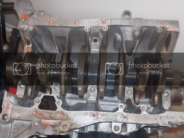

I started with assembling the crankshaft back into place...
Here is the crankcase with the ACL STD Main bearings
I used 5w30 motor oil to lightly lubricate the bearings (cant find the Clevite bearing guard, grrr)

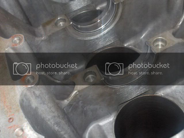

Carefully place the crankshaft down into the crankcase

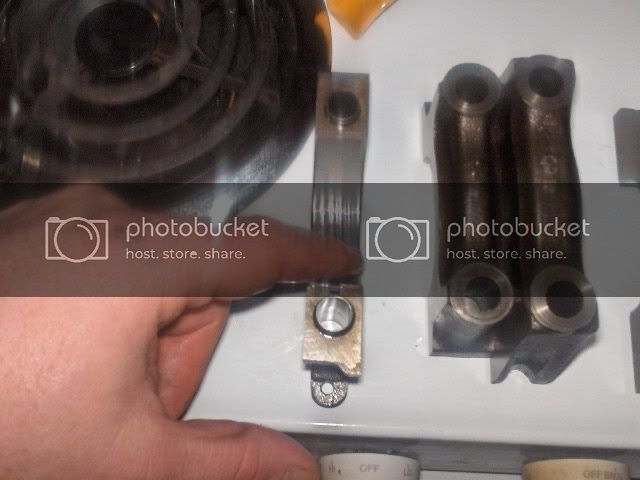

Before applying the Main caps, I lightly lubricated them as well as the bearings with 5w30 motor oil...
Place caps on and evenly press downward, the Dowels should guide themselves right in...

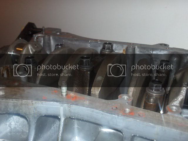

ARP Moly lube used on the Main bolt threads and washers...
Hand thread-on the main bolts after evenly lubricated with arp moly lube....

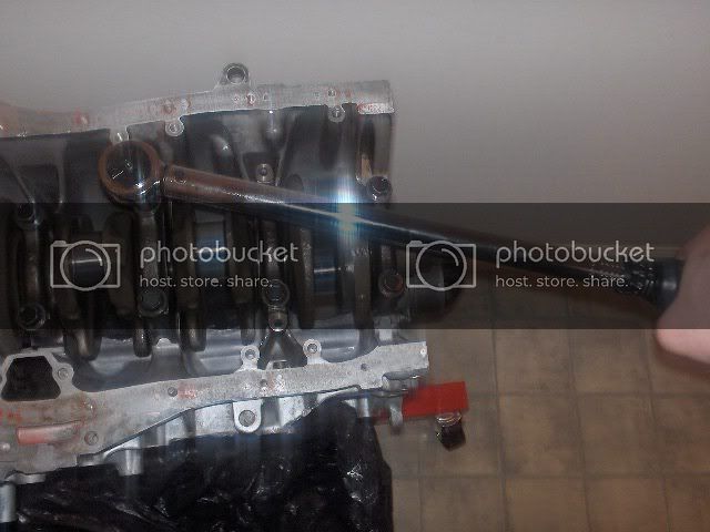

Torque the main bolts to 56 FT.LBS. in sequence, starting with main cap #3, than 5, than 1, than 4 and finally 2.
