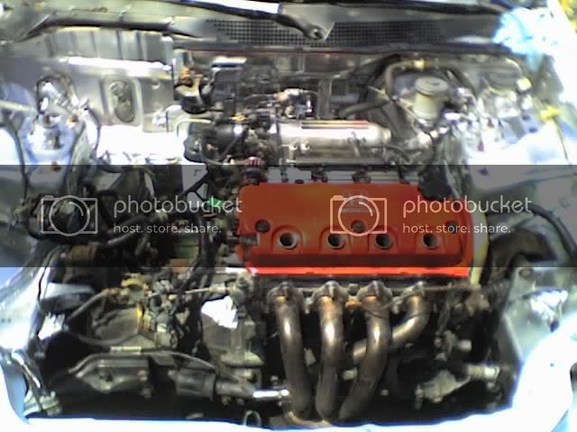

Thanks guys! It was rainning today so all i could have done was getting the d15b out of the del sol.
Just making sure i got the vtec wiring right.
-VTEC solenoid wire to ecu pin A8
-VTEC oil pressure switch to ecu pin B5 , (black wire is ground)
Is that right and all i have to do?
