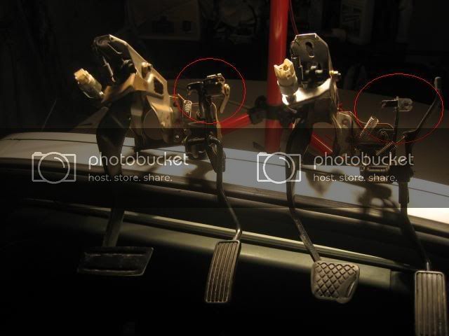

Alright i got the pedals in and all but after looking at the clutch I don't seem to have the sensor that's suppose to connect to it.....also am I suppose to tap the wire to something? For the Gas Pedal am i suppose to be using a different cable? Doesn't seem to bolt up.
as for the clutch sensor, you wont have a plug for that since you have a auto dash harness. you dont really need one, just be careful not to leave it in gear and start it. gas pedal cable should be the same, but if it isnt, go find a manual del sol throttle cable, but i do think yours will work.

Alright if you look at this picture I took of both pedals side by side you can see how the part where i circled is different. The end cable will not fit in the manual pedals because it doesn't have that push to the side piece on the top right.

number 1 you need a del sol dohc Linkage and on the pedal the low one should is for the curses control and the top on is for the gas pedal.
on the petal assembly, there are 2 places for wires to connetc, the top one is for cruise control, and the bottom one is for the throttle cable. as for the shift linkage, the stock one will not work. you have to use a b series shift linkage.

PEDALS
what i did...is took out the cotter pin holding my old accerlator pedal off of the AT pedals set and put it on my new MT pedal assembly..which takes care of having to get a new accerlator wire...it will be a little loose when you do this..just go to the throttle control and tighten up the wire with a 10mm open end wrench
