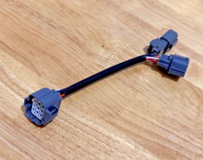

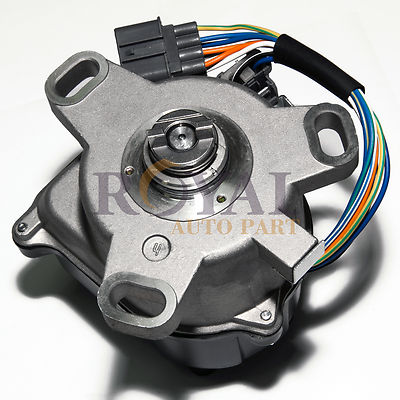

Edit: here's the parts I was looking at for running the P75, would these work?
All this to ask,
1. Is there a way to get around the limp mode and let it rip? The car runs alright, and it's a track car so it doesn't have to be perfect.
2. Should I get another distributor and obd2 to obd1 adapter so I can run the P75?
Any advice would be helpful, any advice would be appreciated.
1992-1995 Acura Integra 1.8L B18B Non-VTEC Ignition Distributor FOR | OBD1 | HDTD55
1992-1995 Acura Integra 1.8L DOHC Non-VTEC (B18B). New Ignition Distributor for 92-95 Acura Integra 1.8L NON-VTEC ONLY TD-55U TD-46U. Ignition Rotor Included: Yes. Integrated Ignition Coil: Yes. w/ TEC Distributor; ID # TD-55U, TD-46U.

OBD1 to OBD2 8-pin Distributor Adapter Harness For Honda Acura Civic Integra | eBay
Adapter is made for a 1992-1995 OBD1 Chassis to plug into a OBD2 8-position Distributor plug from a 1996-2000 Honda Distributor. 1992 - 1995 integra.
