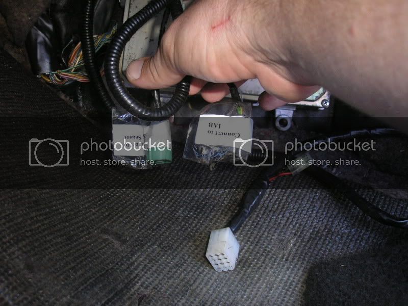

also, there's three unknown plugs underneath the carpet, all associated with the same harness. knock sensor, IAB, and a blank white one with 12 pins!!!
these plugs are parts of a harness (possible aftermarket?) that is also connected to the 4wire O2 sensor, and the vtec oil pressure switch. Have any idea what to do with these?

You will have left over harness plug for the IAB that is not on the z6 intake and the knock sensor is not on the z6 block

As far as my unused plugs - it appears they are part of an aftermarket "vtec subharness" i'm probably just going to hook up my vtec and o2 sensor through it (as its already hooked up), instead of removing it and completely redoing the vtec subharness from scratch (even though that would be cleaner).

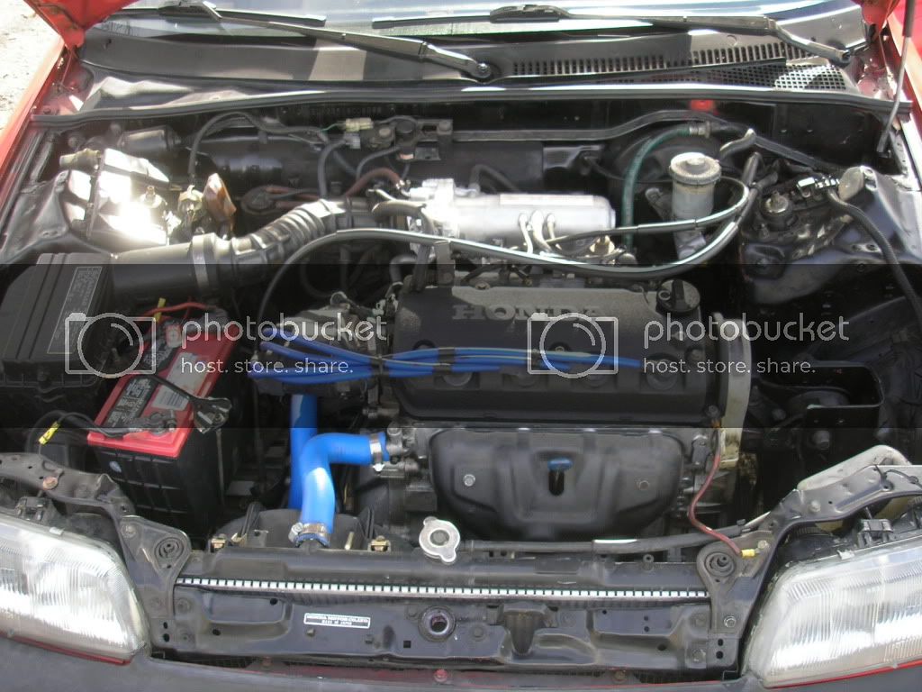

If your engine bay in the picture above looks like that running than you have a "wire tuck" harness which is nice, and expensive but that is a very nice way to do the swap with good attention to detail.
The D16Z6 will run with the stock Si injectors. I would go with Z6 injectors, Z6 dizzy wit 0bd0 to 0bd1 dizzy wiring harness from rywire, p28 ecu wit 0bd0 to 0bd1 jumper wire from rywire also use rywire's v-Tec sub harness. As far as the resistor box you don't need it that's why it's not there. They probably cut the wires that went into the one that was there and just spliced them together. That's what I did when I did my Z6 swap. It was a plug and play swap.
