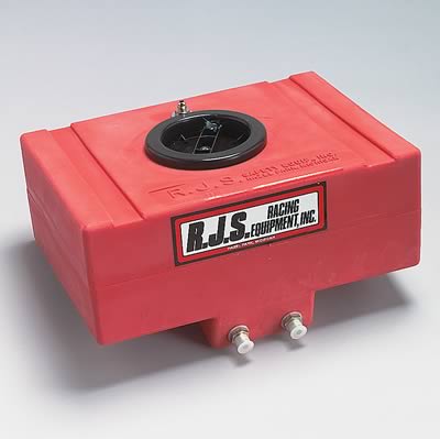

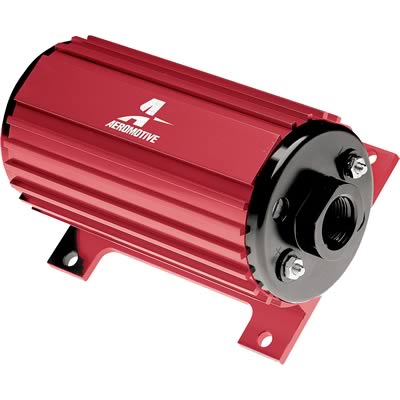

and the trunk is getting this:
and this:
Aeromotive A1000 Fuel Pump -10 in and out.
