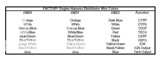

I tested continuity on all wires relating to the diz.Tested from the ecu to the diz plug. They all checked out good and in the right spot. I am using an obd1 diz, so I dont think your chart is going to help me because its obd1 to 0. Here is a print out I got from honda that should be helpful to others. I am going to try a 3rd diz, and see if it helps. In the meanwhile Im still open to any pointers.
It's supposed to be obd1 to obd0. You're using the ef harness right? which is obd0, so therefore the chart i posted is obd-1 distributor wire color to the obd0 harness color...

And try this its at the very very bottom of the write-up. (The dizzy wire colors)
Alright...fixed. Turned out to be unshileded diz. wiring. Grounding out and causing a short. So shileding your diz wires is a very good idea when ever converting to MPFI.
