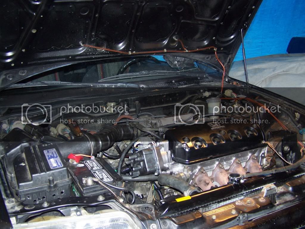

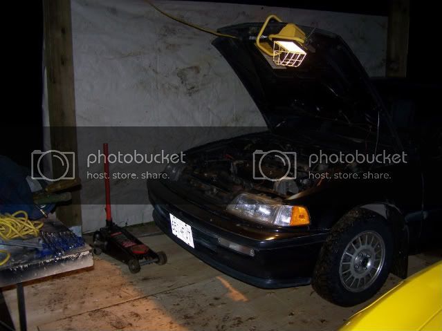

Before:
After:
Notice I tucked up the muffler, took off the side moulding and the wheels.

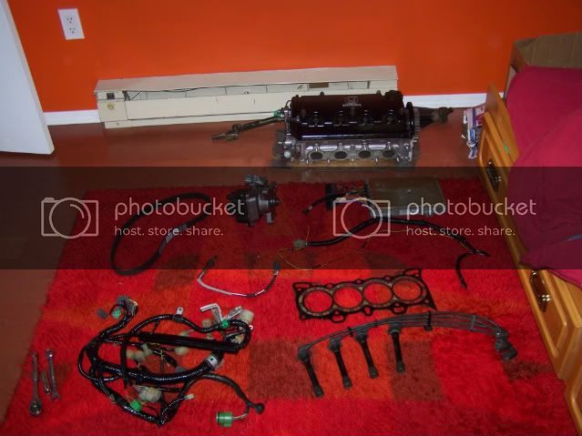

Here is everything I have ready to go for tomorrow.
The head and everything has been sitting in a box in by bedroom for the past 6 months while I was collecting everything. I got some good deals from being patent though.

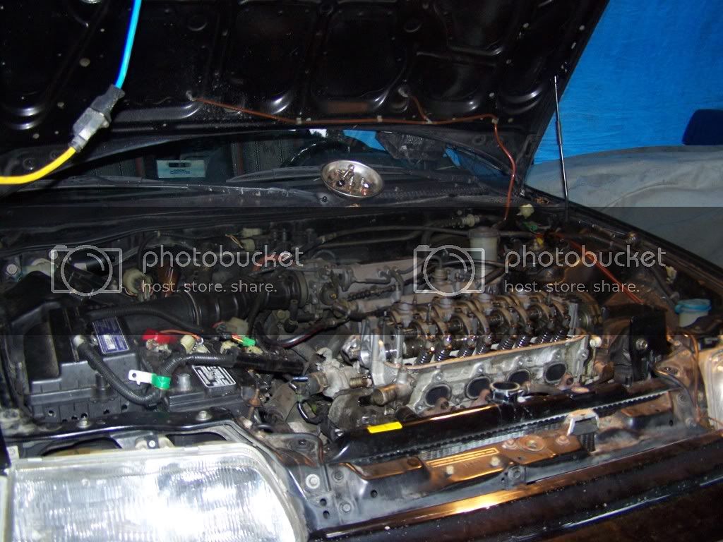

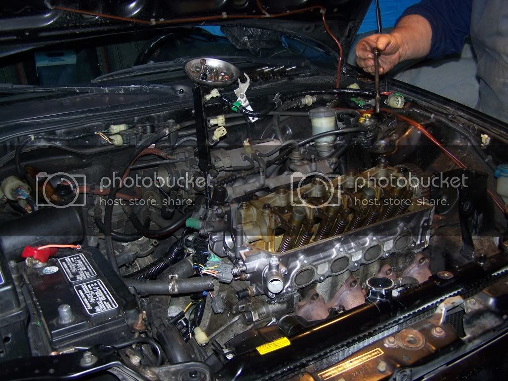

The old head being removed:

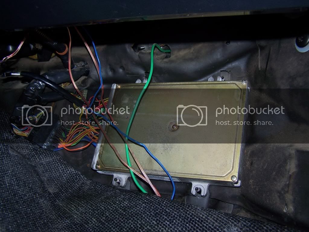

ECU hooked in:

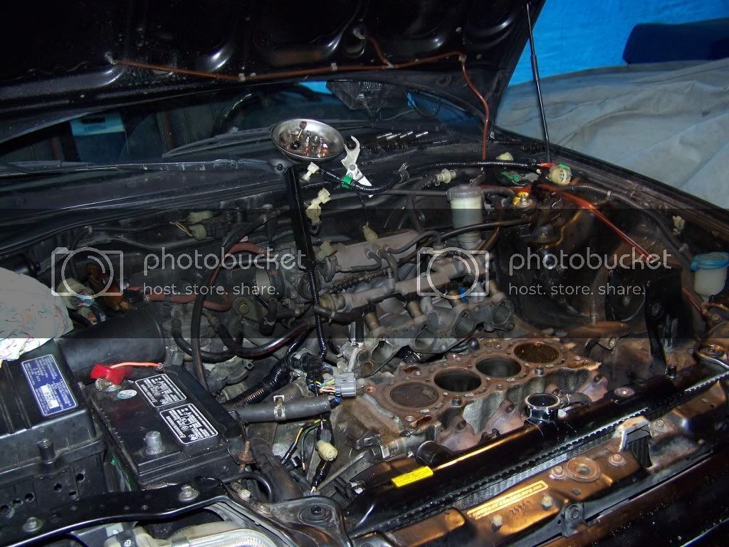

Head off:
New head on:
All bolted in:

So first we bolted everything up and tried to start it and it didn't even attempt to run. So we pulled a plug and it had no spark.
Then I put the OBD0 dizzy back on with the OBD1 ECU and it ran but like shit. It sounded like a Subaru.
Then I put the PM6 OBD0 ECU back in and it fired and ran perfectly.
Then I put the OBD1 ECU and dizzy back on and "borrowed" the coil out of my moms Accord. Then it ran even better.
