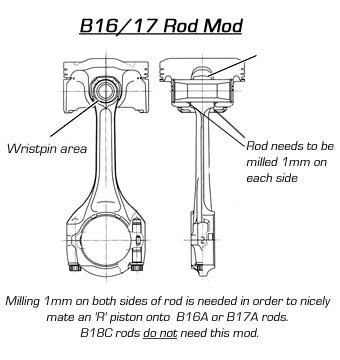

Don't forget when you want to put CTR pistons in your B16A your going to have shave the connecting rod. CTR pistons are narrower where the wrist pin is! But, any machine shop can do that for you.
isnt a b16A a jdm CTR or del sol motor? i believe we kinda cleared up that he has ctr pistons already.
but thanks for the knowledge. i sure as hell didnt know that.lol
a b16a is a jdm civic si motor or a del sol motor.
a b16b is a civic type r motor.
well.. i think i've gone against the CTR pistons..(it was just a thought anyways), since i have p30 pistons already i'm just gonna free up the head a bit.. but thanks for all the info guys
