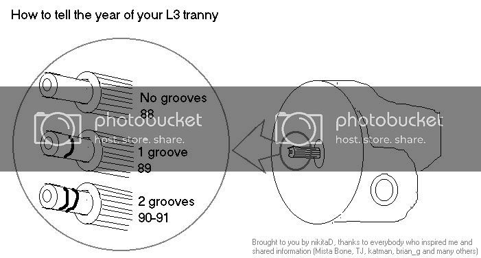

there should be a sticker on the front of the tranny right by where it meets the block..it should be gold

All 4th gen d-series transmissions are going to say L3 and a series of numbers. theres only one sure way to figure out what you've got.
if i had to guess i would say he probably just dropped a dx tranny in there.
