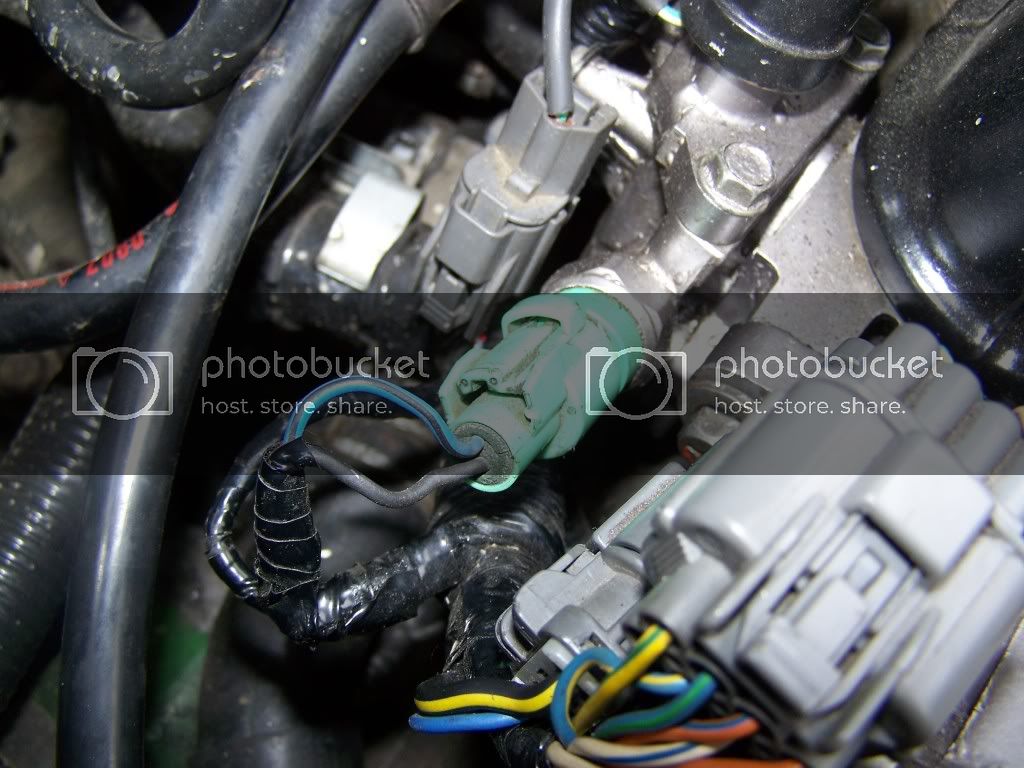

ok so i think i have it..on the oil pressure switch the red wire is a ground.the green wire goes to pin D6..on the solenoid the green wire goes to A4...correct me if im wrong?

Since I'm such a swell guy I took a picture of my Z6. Now, you have a different plug on your pressure switch, no problem.
YOUR green wire goes to ground.
YOUR red wire goes to pinout D06.
The VTEC solenoid goes to pinout A04.
