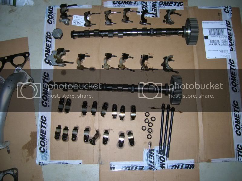

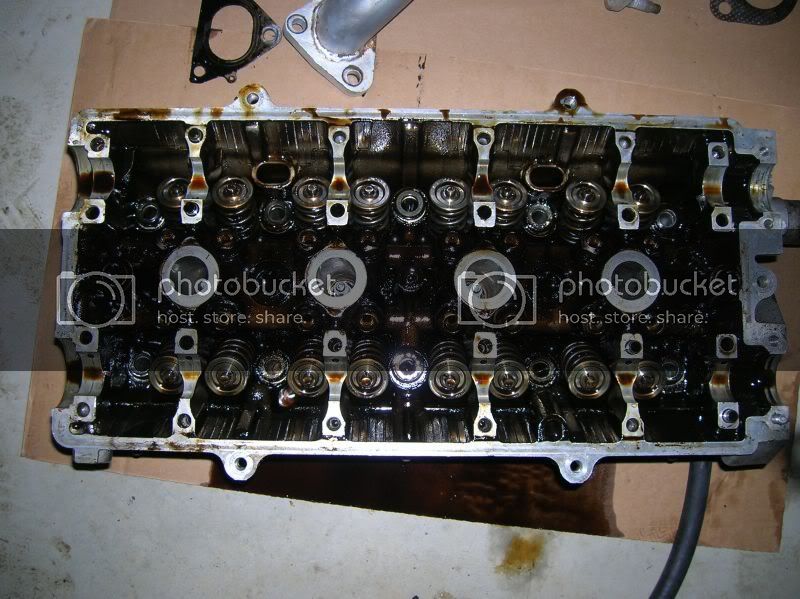

    Im Jon. Im 18 and you prolly dont care. more interested in the car. eh. 1990 integra that has a fully built top end. crower cams, retainers daul valve springs. the motor is good up to 9500 rpms. i havent dynoed it yet. but has to be making about 175 to the wheels atleast. when we put the motor together we didnt torque down a head stud fully and blew the head gasket. just got my new 82mm cosmetic head gasket in and the motor is currently apart. taking the head to a machine shop to make sure all is striaght and to have cleaned. i did look at the pistons tonight and the car was running pretty rich. time for a wideband and tune. i also noticed cylinder 2 has a bit of scuffage and thats why i was burning some oil. im wanting to possibly bore the motor out more and get new sleeves. what is the best manufactor for this. wanting a 84mm bore. about how much hp would i gain, is it worth the money?
    in the long run i want a strong motor with a turbo kit only putting out like 10 psi. in the meantime look at the pics. :)

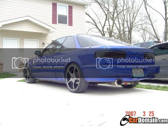

    Looks pretty nice! I like it! :thumbsup:
    What are those rims?

    not sure. there a buddies rims. ill ask him tomorrow. and thanks for all the comments. anyone know if it would be worth it to buy another block and have it sleeved with 84mm bore. or should i just suck it up and keep burning some oil here and there.

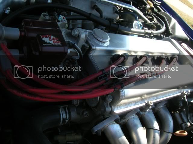

    * added pic *

    Did you just weld beads all around the edges of the valve cover? That looks pretty freakin' sweet...

    Whoa that's some sick welding right there.

    were did you get that valve cover???? it clean^_^

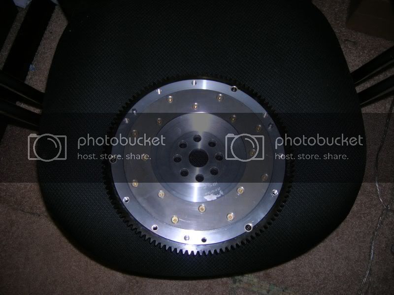

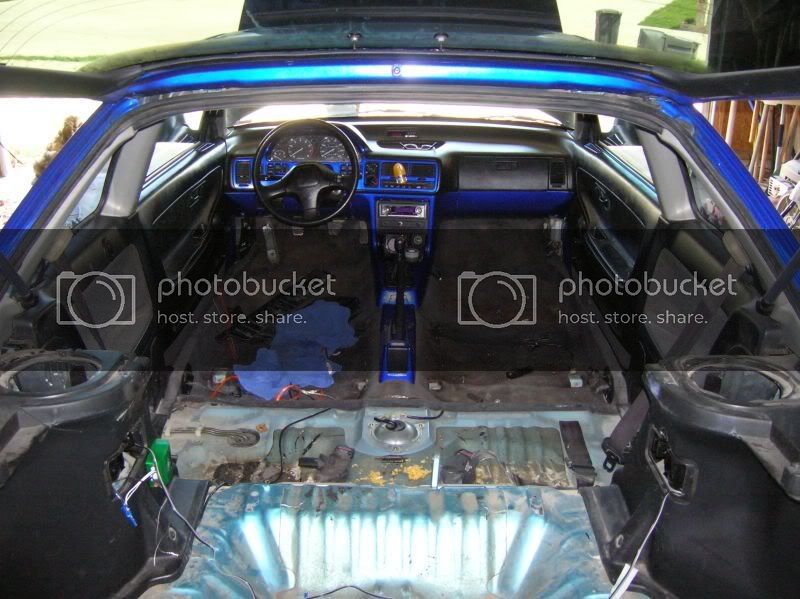

    i should have the car back together and running by next weekend. atleast thats the plan. im stoked cause ill have the block mound and motor mount swap from the 90-93 version to the 94-01 so i can use my sweet new ingalls torque damper. and i will have in a fidanza lightweight flywheel. all new stereo. (will upload pics momentarly) rear strut tower bar. rims are on the back of a ups truck right now and should be here in time. and my rear tokicko struts were blown so i got new kyb struts so no more bouncy. should feel like a whole new car.

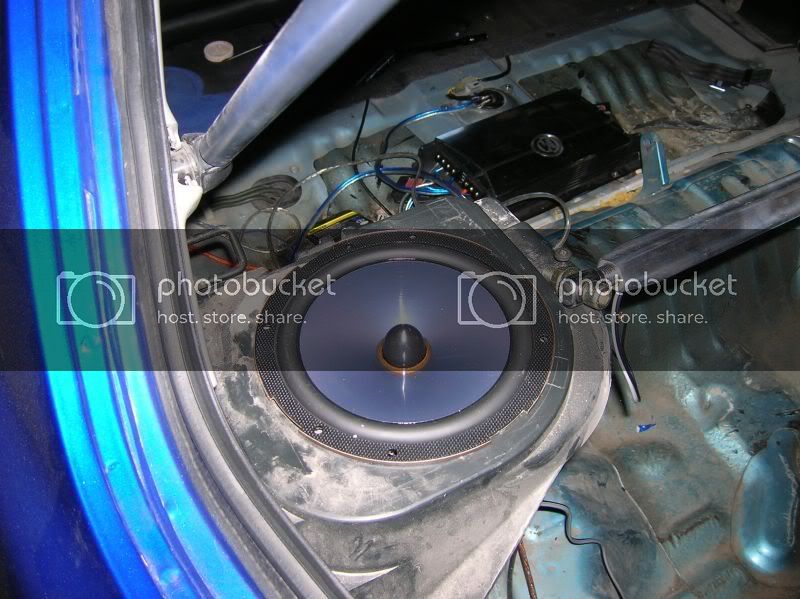

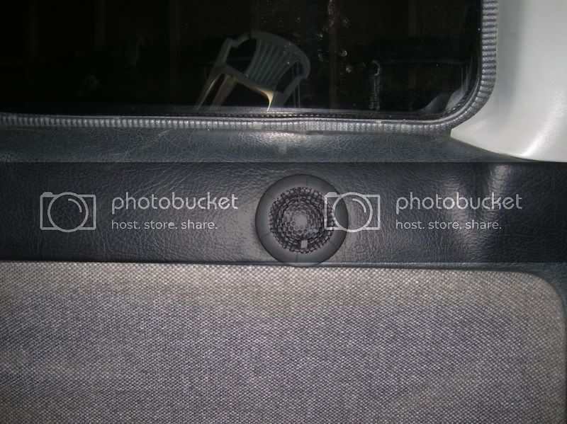

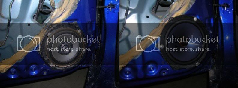

    went from a 4 inch speaker to a 6.5 inch component. very easy to get in there. take off the plastic peice the holds the 4 incher and cut out the back and put the bracket on backwards of how it came off and wam it holds a 6.5 inch.
    [​IMG] tweeter for the passengers in the rear. which there hardly ever are. i have components all the way around so it should sounds superb.! I dont have pics of the tweets in the doors but will snag a pic within the next few days
    rear speaker normal install was easy as 3 screws

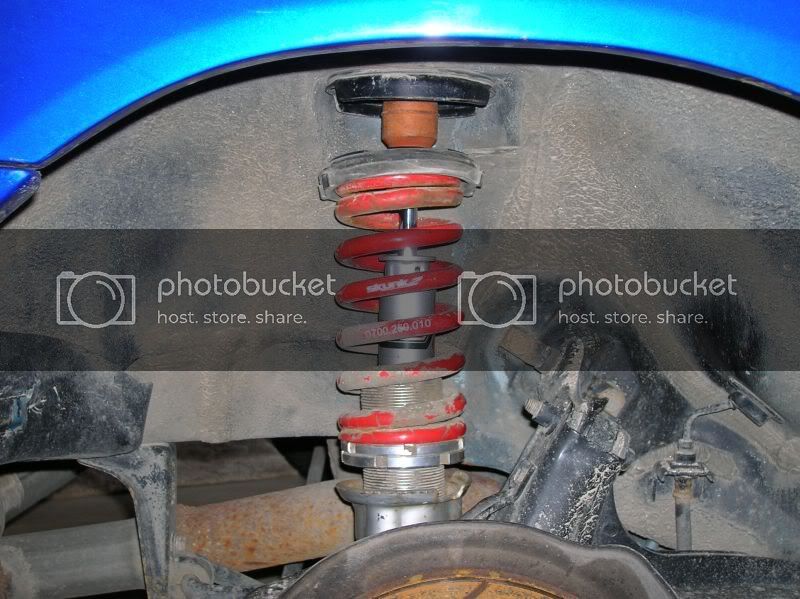

    [​IMG]new kyb struts and skunk2 coilover kit.
    fidanza 7.5 pound flywheel

    Im all about the valve cover, thats one sexy piece right there.
