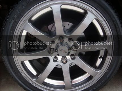

    Well guys, Today I'm noticing that my stock clutch is dying so I most likely will find someone in southern california to install it. Any suggestions? I also just upgraded the factory brakes to withstand the higher speeds I will be braking at. The brake upgrade went smoothly, I upgraded the rotors to Brembo Drilled and Slotted Rotors,

    Well guys, today I started to feel my clutch go out. I need to get it replaced on monday with the ACT clutch that I have. I also picked up a case of Royal Purple oil and some Peak radiator and a bottle of Redline Water Wetter. I also upgraded the stock brakes so they will be able to withstand the high speed braking I will soon be doing. I added Brembo drilled and slotted rotors with Earl's stainless steel brake lines and Hawk HPS brake pads. A quick update on when the parts are coming. My hood is taking forever but, that's not at the top of my list anyway. The turbo setup and exhaust come on wednesday and all the supporting upgrades come on monday. So this week I will be turbocharged, hopefully if I can get a boost guage, custom charge pipes and the clutch installed in time. I'm lazy right now but, I'll post up some new pictures soon. I started on some of the body work, and I got a friend who will be painting my car in his shop. He's a very legit painter, I'm going to stick with gold but, there is this one blue color that caught my eye, the color was gorgeous so I have to think long and hard about it.

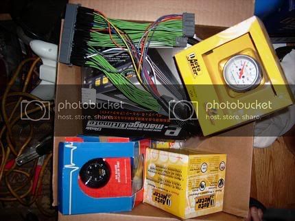

    Parts Arrived Today
    Today a shipment of goodies arrived at my door. My Greddy E-manage Ultimate with all the options and a plug and play style wiring harness, AEM Eugo Wideband o2 guage, my triple a-pilar guage pod, and my one step colder denso plugs.:mellow: I will post a picture in alittle, I'm working on the accounting for my friends buisness.:mad:

  10. schleht
    schleht Automotive Addict
    129
    May 8, 2008
    I'll post up a picture of what the ecu looks like tommarow. I just got my car back from getting my ACT street mod 243tq Clutch and my 500hp MuenzRacing Custom axles and a new slave and master cylinder to keep it all fresh. I also have a good collection of parts including my turbo, manifold, Walbro 255lph HP(High Pressure modified specially for forced induction applications), 440cc injectors which I do not regret buying now that I was enlightened by another forum member and will be fine for up to 350whp and I got a good price so buying bigger ones once TIracing builds my motor won't be too much of a shot in the wallet and won't come until maybe at the latest by next and second to last semester of college:). My greddy emanage ultimate with all the fixins and a plug and play harness which is soo helpful and will allow me to skip most of the wiring between my ecu and the oem ecu. Two Autometer ultra-lite guages(EGT and oil pressure), and AEM uego wideband. I also installed my wheels and got my projector one piece headlights and Red/Crystal 2000 SIR style Non-LED taillights that I may niteshade the red part(might be too much for me tho, it's just an idea). I will have alot of pictures up of the progress I've made trying to un-bucket this dimond in the ruff. I've just been reading up on how to use my Greddy Emanage Ultimate and the proper way to apply boost and fuel to my engine safely since I will be using stock internals for acouple of months. Hopefully no-one reads this and f**ks up my ebay purchase, nevermind it just ended. It's for an eagle lightwieght forged crankshaft for $260.00 brand new and shipped which is a steal, and most likely stolen:cool:. Keep checking back, tommarow the pictures will go up and I will start keeping a very percise log of all the modifications and problems I will encounter so this will add to the vast accumilation of knowledge on this wonderful beacon of knowledge aka Hondaswap.com (a little plug for any admins that are reading, don't say I don't try to promote the website^_^). The golden monster is still in the ruff but, the final product is near stay tuned. PEACE.

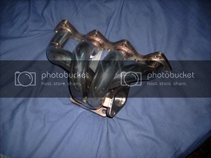

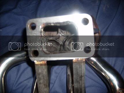

    AEM EMS and hondatas are cool but, the emanage ultimate is just like an AEM EMS I think, there are so many features, it's like an apexi safc-II's ease of tuning with all the bells and wistles of the aem ems. I'll get more into it when I start mapping later this week when I'm turboed. I'm going to start piecing together all the oil lines and such so I just have to bolt the f*cker on. I got lots-a-pictures for you guys, I'll post them up in a second I just have to photobucket them.^_^
    The Manifold and Turbo aren't that bad acctually for the price. I am a skilled mofo with a dremil tool and I'm going to smoothen out all the rough inner-welds and the 4-to-1 connection between the runners and the manifolds mounting plate and it will work perfectly. I'm opting for a dual ball bearing AGP 50trim like I have in my srt-4 eventually but, for now this will do.

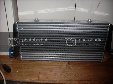

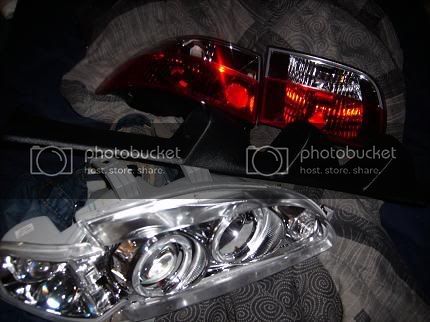

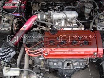

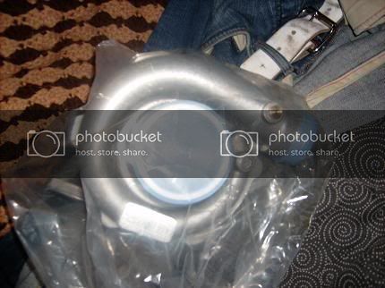

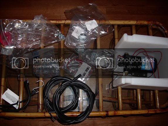

    Pictures
    Here's the pictures I promised, they are self-explanitory.
  14. schleht
    129
    May 8, 2008
    Pictures Again
    I forgot to post up my faviorte part of this custom turbo kit the intercooler. I'm going to cut the front bumper to further expose the charge pipes and the core/endtanks of the intercooler as this person did from the May 2007 Issue of Dsport, a magazine dedicated to very fast daily driven cars. This blue honda runs a 10.19 second @ 147MPH 1/4 mile Which is boosted to and held at 32psi on E85 Ethanol established at 606 wheel horsepower.

    Wut made you decide to use the E-Manage and piggybacks over a tuned factory ECU? Also, at 350HP do you see your intake temps being far enough outa hand to use both that big ass intercooler and the meth injection, or are you preparing the car for when you upgrade your parts farther?
  16. get_nick
    12,325
    1,374
    Apr 21, 2003
    Washington State
    that intercooler is way overkill.
  17. SLOWdelawareEG
    SLOWdelawareEG my cars go fast
    290
    4
    Dec 21, 2006
    hilton head island, sc
    nice. straight up ebay setup. be careful with those stainless tubular mani's they like to crack.

    The intercooler is impressively good, the welds on it are very clean and look like stacks of dimes. And from the inside with a flashlight I couldn't see any manufacture's defects so I'm gonna stick with it, it's hella clean looking and will match with a professionally cut front bumper (my friend is good at mod modification and cutting and mounting bumpers and lips..etc) will look hella clean. I wanted JDM Fogs but intercooler pipes look cooler so i'll just stick with my chrome one piece projectors. Later guys be safe and watch out for the 5-0.:ph34r:
