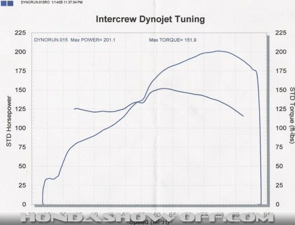

edit: But at any rate, I still think something's off.
My previous setup:
85MM Golden Eagle sleeved B18C1 block, CP 12.5:1 pistons, Eagle rods, LS crank, GSR head, Skunk2 Stage 2 cams, Portflow valvesprings & retainers, Skunk2 intake manifold, Skunk2 cam gears, DSM 450cc injectors, Crappy Ebay intake, Ported ITR header, RSR ExMag exhaust, CarSound cat, CTR tranny, ACT ProLite flywheel, Clutchmasters stage 3 clutch, Gator stage 2 axles, P28, Hondata S200
Dyno from that setup:
Something just isn't right, that with the same bore/stroke, milder cams, and less compression, that you'd make 34 more hp than I did....
