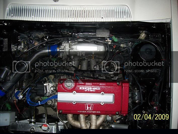

im finally doing the accord 80 cvcc spindles and 84 accord hubs for 4 x4100 bolt and axles for the accord to upgrade size disk,calipers,axles it should be better i have the front all off now ill do pics of the swap for the cvcc guys to upgrade the 80-83 hubs and exe...and i tucked up some wires and the fusebox on trans side to get into the motor better looks great..
call drive shaft shop and get some good axles made for that thing Frank will make them with for what ever hubs you want and what ever length you might need also

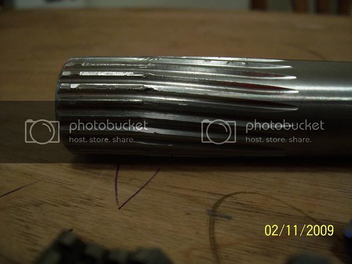

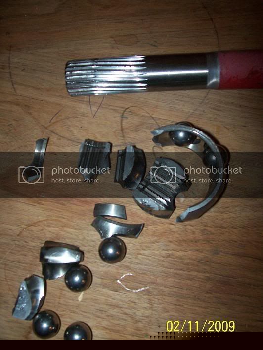

sorry didnt explain better the stock axles are made to fit for size then Dutchman motor sports make new chrome molly axles i didn't have them last time cuz i just had the stock B16 and did great with stock and the new plice in the stock axles make it week its past the treated metal but yes the axles are going to be upgraded i had to get the stock axles from the 80 accord and hubs for the 84 accord then cut down to fit then send out for better stonger... and still up there in price$$$$$
i knew that the ones made that they did say it will not hold up to more 160 HPs
and !!
it was fun when the old ones twisted and snapped allot of people were out side at the time never seen any one hit the deck like that lol...
loud as hell like a gun shot in a barrel lol
