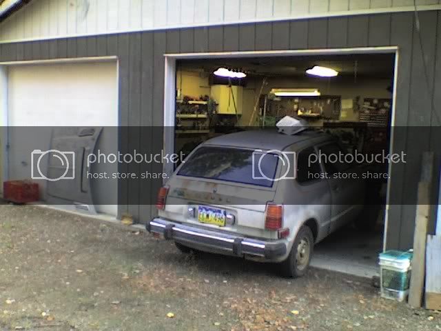

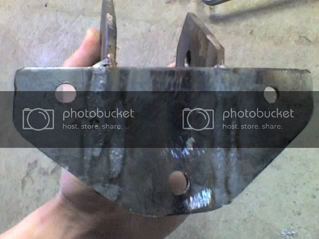

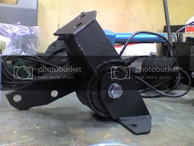

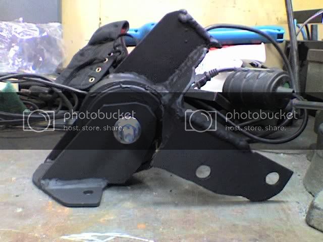

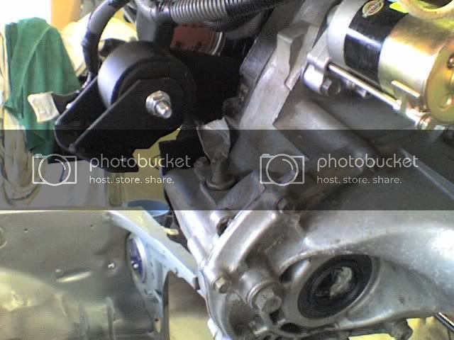

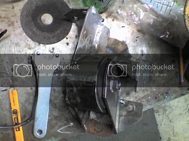

I finished the new rear mount so that the car can be towed (hopefully to the new house)
Sorry about the shitty cell phone pics, but it was all I had.

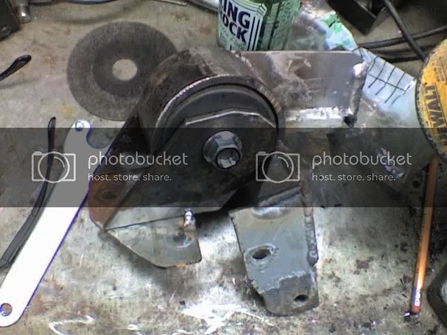

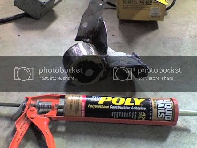

The Poly-Caulk has to cure overnight, then I'll reassemble and pray to God it fits, I kinda rushed this mount and banged it out in a few hours.

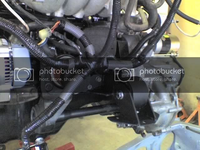

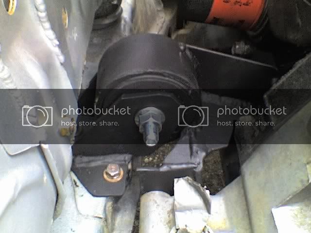

Got it painted and installed!!!
Now this shit is a HELL of a lot beefier than the last one. The suspension flexes before the mount does, which is what everybody wants right?
Bump, in case anyone missed it. What do you all think of the hockey puck mount?

I'm just glad the mounts are finally done, this means most of the major fab. work is complete. My buddy who is a tech for Audi in Seattle is comin up soon, he's sposed to help me with the wiring. After that, all it needs is fuel lines/pump and I might get to hear this beast roar.

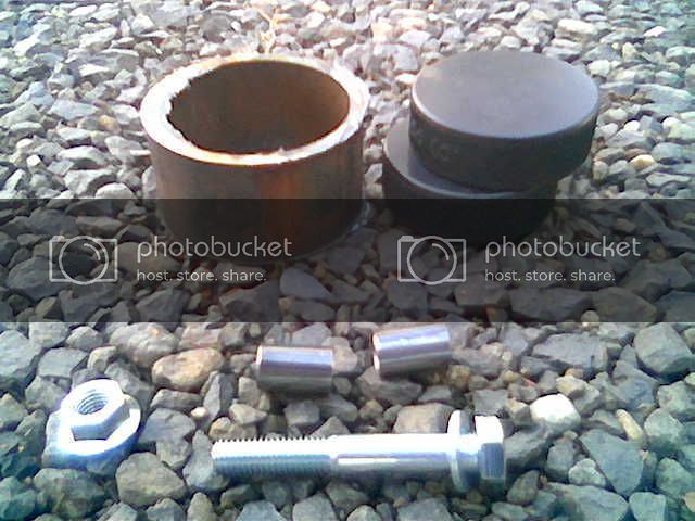

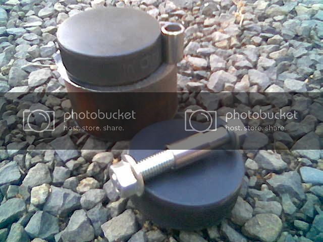

those are the hockey pucks, right? was there a lot of play after you stuck them in? is that adhesive going to fall apart?
keep up the good work and good luck with the new house!!
Yup, hockey pucks. With 3" sched. 40 pipe, there was about an 1/8th of an inch of play. The adhesive is poly construction adhesive used on subflooring and wall panels etc. It should hold just fine, it doesn't hold the pucks in place, the ears on the other bracket do that, it mearly takes up the gap between the pucks and the pipe to keep it from rattling. I don't think it will be a problem.

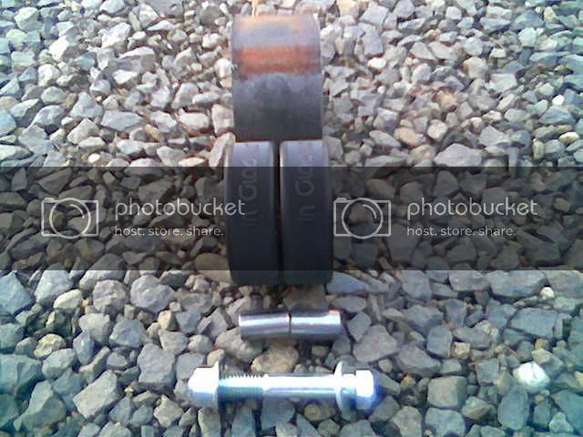

did you put a sleeve in the middle of that puck for the mount bolt?
you should :-\

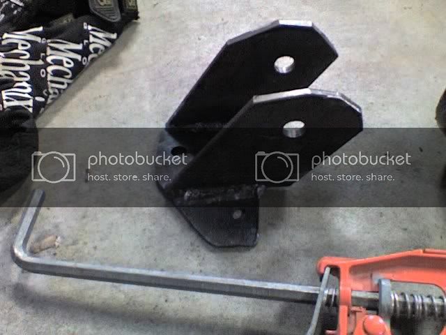

I got the supplies to build my Hockey Puck Mounts.
Pictured are 2 pucks, a piece of 3" sched. 40 pipe the length of both pucks, a M12x1.75 bolt, washer and flange nut, and 2 12mm steel sleeves that are both the length of one puck.
Tonight and tomorrow, I'll see if I can make this crap into a new rear mount.
