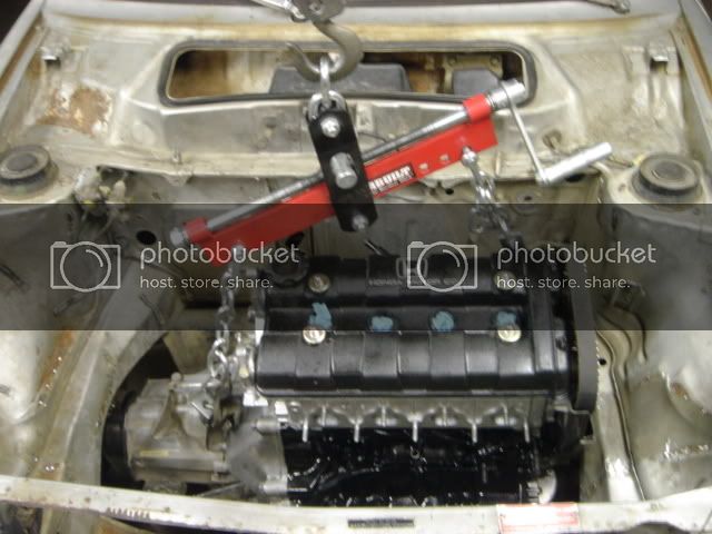

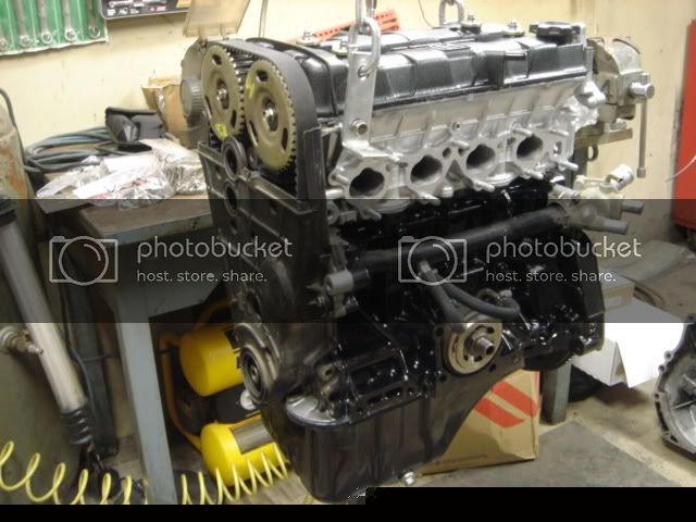

I'll update the pics 2nite. I got the engine back from the shop, put a new clutch on and put the tranny back on. Then I dropped it into the CVCC to see how it'd fit. Looks like I gotta do some trimming on the framerails...

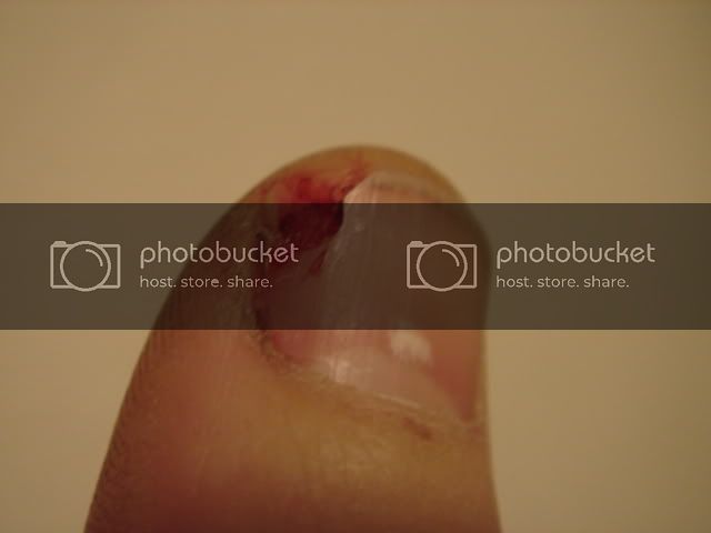

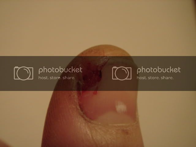

Whenever working on such a project, be sure to handicap yourself by any means necessary to make it more dificult. Start by removing unneeded portions of your thimbnail so that your opposable digit is rendered useless.

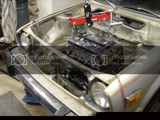

Then finish removing motor mounts, install clutch and transmission to engine for a test fit in the car.
As you can see, It's a tight fit. The engine has no crank pulley, as I'm still waiting for the Ebay pulley to arrive, but i figure the driver's side framerail will only need to be pushed in about an inch, so I'm just gonna torch it to make some room.
The framerails taper as they go back, so I'll also have to notch out a small section for the alternator pulley, and give clearance for the belt to run.
On the transmission side, I only need to notch out a small portion to move it further forward into alignment.
i think we could have gone without the nail picture,
+1 on the nail thing...

except...pull the motor back out and at least wash the engine bay...^_^
