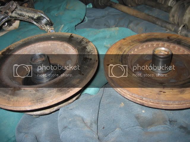

Here's a shot of the two rotors. CVCC on the left and Integra on the right.

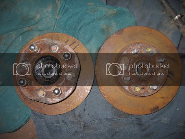

And here is a shot of the other side to show the spindle shaft that will have to be turned down in a lathe.
I still need to mock these up to check for clearance as it appears the CVCC rotors extends out past the knuckle farther. If this works, I will shit my pants and sing hallelujah!
