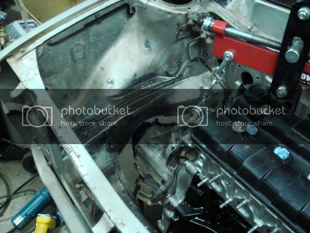

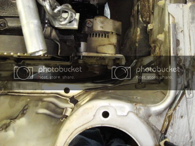

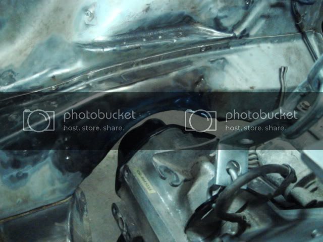

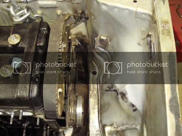

I gave the car a little massage with an oxy-acetylene torch and a BFH (big fuckin hammer). I needed a little more clearance for the pulleys and the transmission pan.

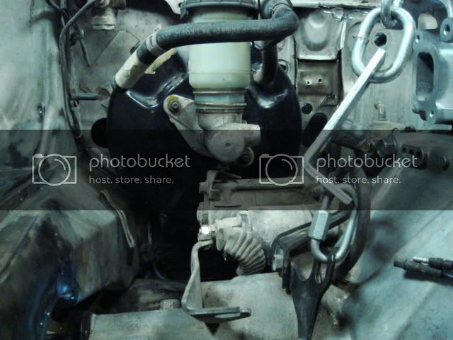

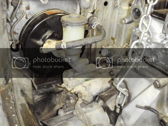

I also test fitted the Integra Master Cylinder. It's a tight fit, but it'll work. Integra brakes are a go!

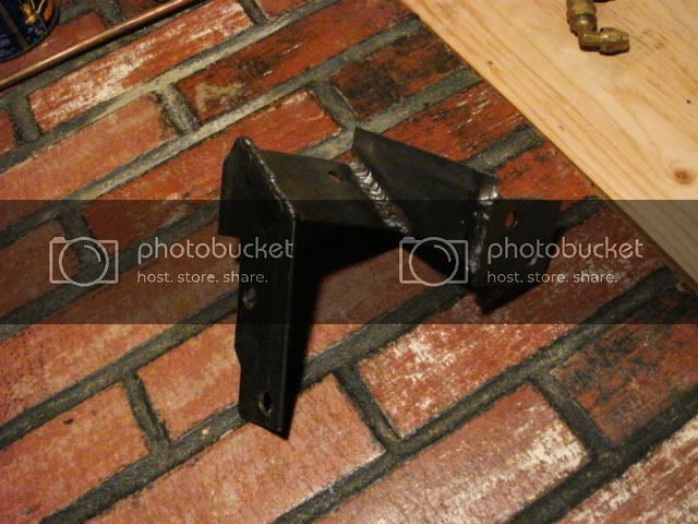

And finally I built a bracket to go from the stock civic mount to the Integra engine. I gotta add some more gussets, but I need to test fit it first. More to come next week.

Right hand drive? Or am I looking at the master cylinder picture wrong?
yup Its LHD, but the MC is on the pass. side. There's a bar that goes from the brake pedal, across the firewall to the passenger side and actuates the MC. It actually helps things fit quite nicely.
Ah, good information. Now I know.
