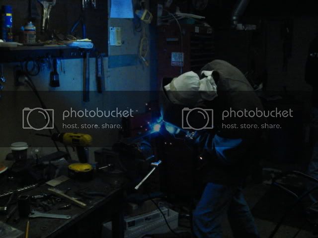

I suck at welding

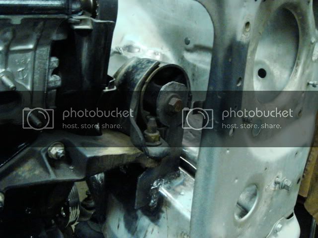

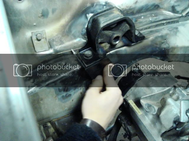

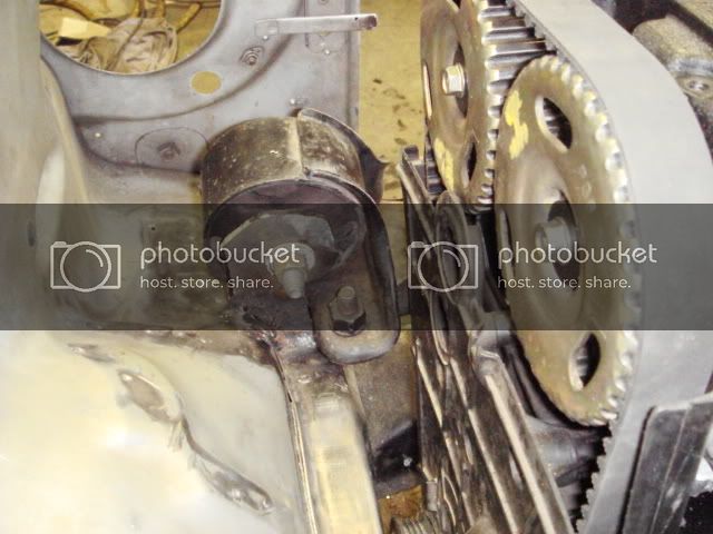

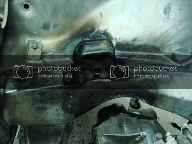

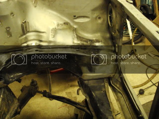

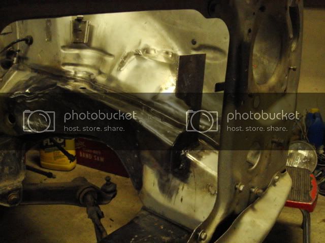

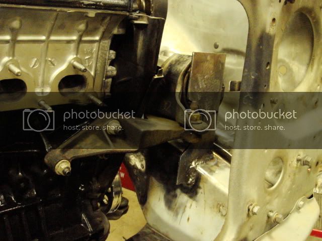

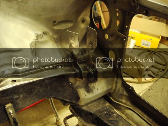

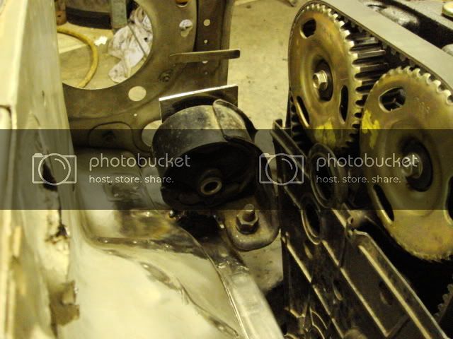

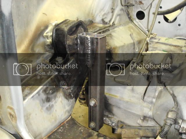

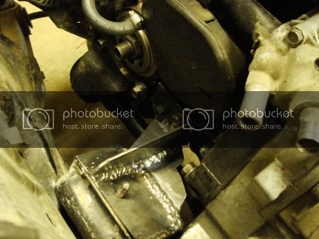

Finished the rear mount and started in on the drivers side mount. I have more pics but my camera died before I could upload them all :confused: anyway enjoy.
I know, it looks crooked, but I fixed it.
I'll get the rest later when the camera's charged.

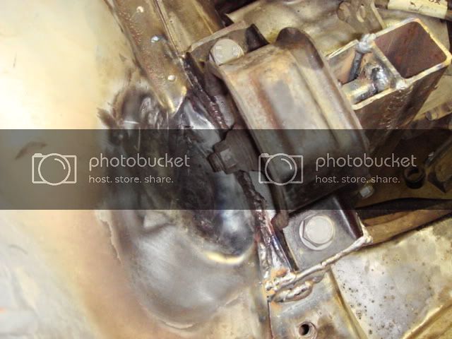

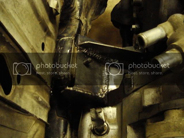

I thought that too, but once he gets the back spacer welded in, it'll be fine.
Take a look at your car, it's only like 1/8" stuff... His metal might be a little bigger than stock ones actually!
+ take into consideration that these motors are only like 250lbs. You've got 3 structural supports, so it distributes that weight, so that 'thin' mount might be only holding under 100lbs... and welded steel can support lots of weight!!!
Keep it up Klyph.. lets get some more pics in this beast!
:p
those mounts are thicker than the ones in my mirage, and my motor doesnt move :)

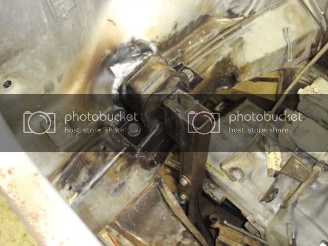

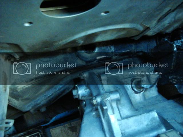

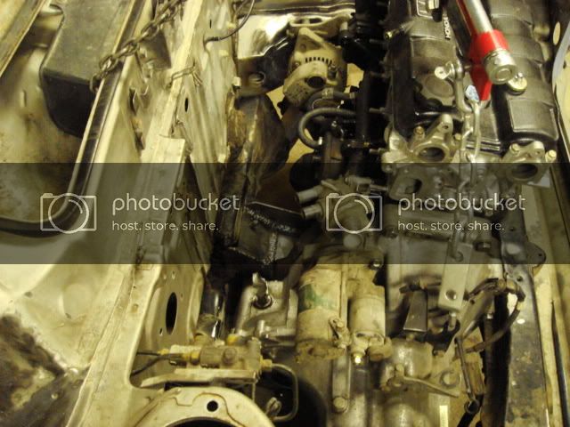

And now feast your eyes

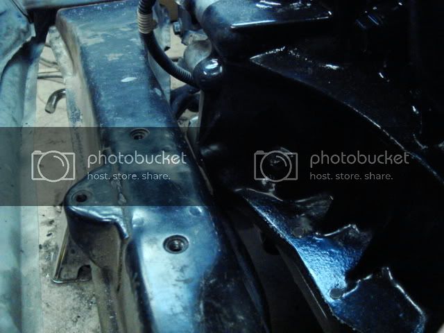

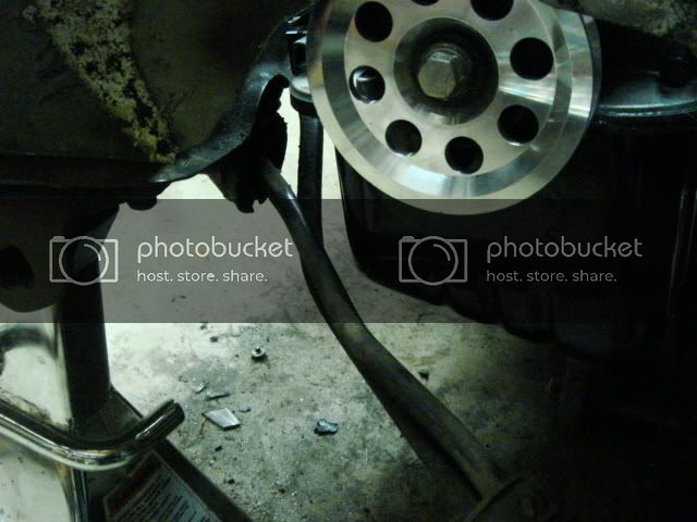

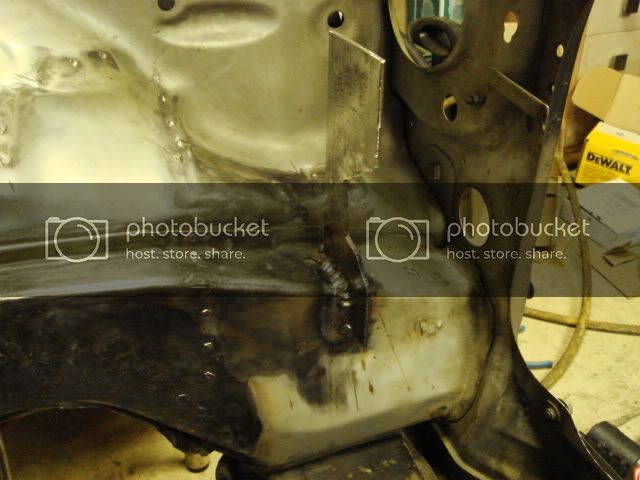

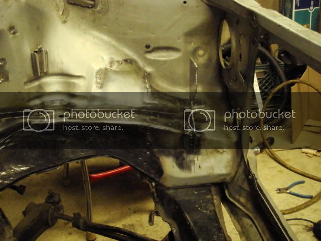

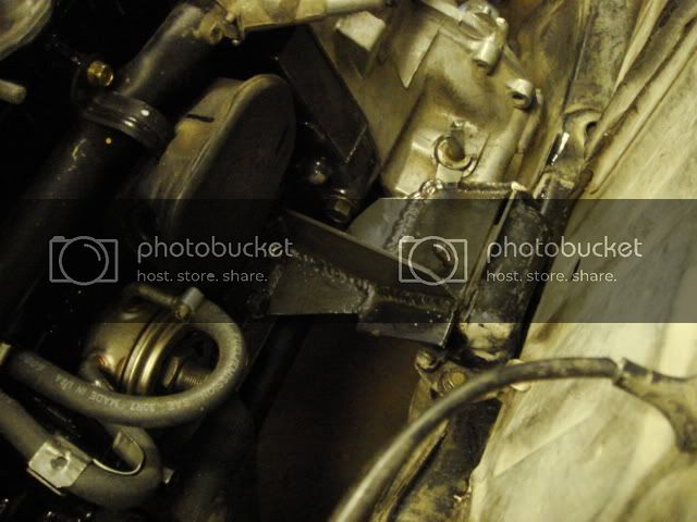

Here's a pic that shows the clearance of the drivers side tie rod to the oil pan
These show the clearance to the front and rear crossmembers.
And this shows the clearance to the firewall

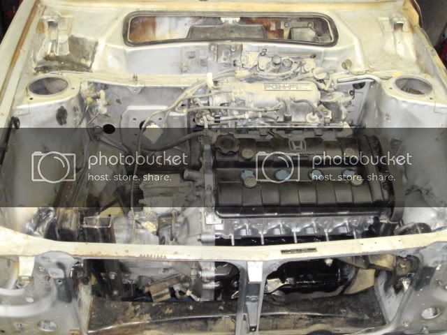

What lurks inside this strange beast?
OOOOOO Yeah

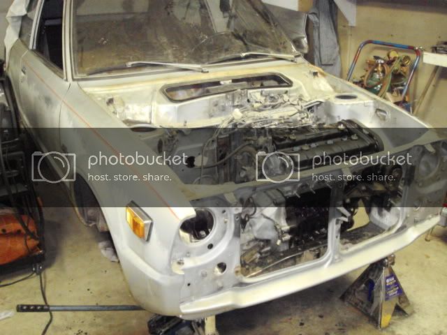

And she's finally mounted!
Yes, that's right. SHE'S MOUNTED
