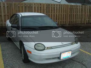

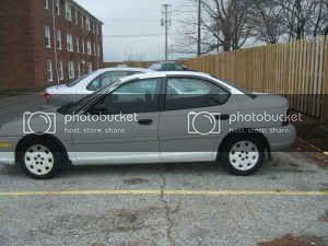

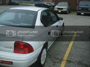

Well I finally found one.

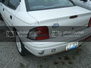

And the bad. Light hit in the rear.

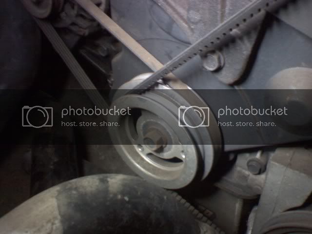

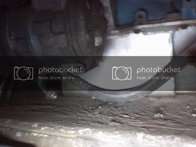

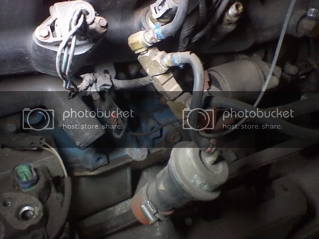

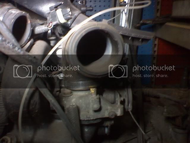

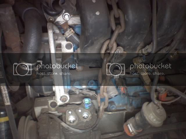

Gonna be taking a closer look at the motor tomorrow to see what is missing so I can get whats needed and try and get it on an engine stand so I can take the oil pan of to see what kind of internals are in it then take the valve cover off to see what cam is in it. Lots of research before I can swap it and fire it.

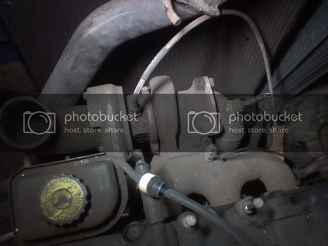

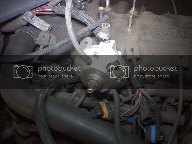

first thing you do and let me tell you from experience is ditch the fmu and buy megasquirt. fmu's and neons don't mix well, i am lucky i have a fuel rail left it liked to run at well over 175 psi of fuel pressure. if ya have any questions or need pointers shoot me a pm i have done everything you could possibly do to my neon motor and turbo wise so i prolly have the answer for ya. Oh yeah and if you were wondering that is the hahn racecraft turbo kit ya got on there.
i can verify this... it was scary as hell watching that fuel pressure needle bending against the stop pin :eek:
Alright, Why should I not use the FMU?
