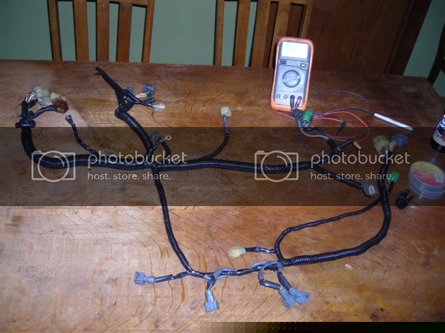

Also, the ground made no difference. I installed the ground wire, cleared the codes, and they came right back- same idle, too.:mad: I'm gonna have to dig into the harness with a multimeter...ugh!

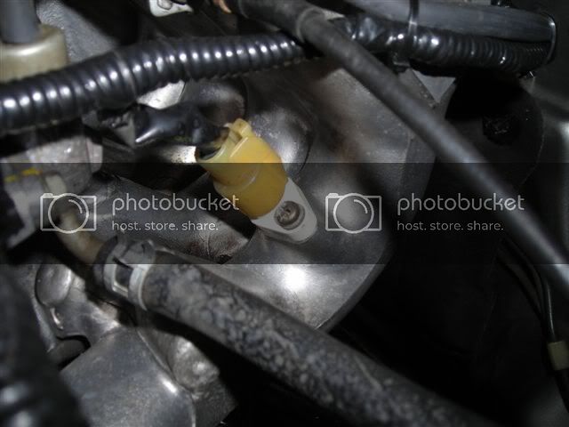

I'm a dumbass. I had iacv and intake temp transposed. D'oh!
ha nice, yea that'll get ya every time
Harness v.2.0
rerouted and tweaked some things, since it was all laid bare again. Ready to put it back in, hopefully for good!

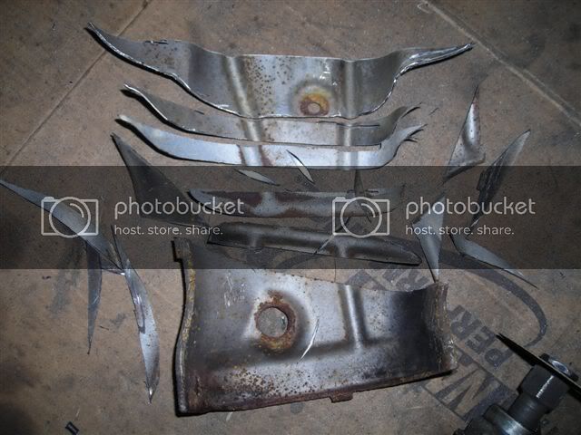

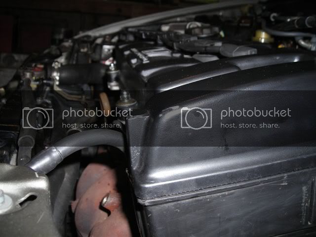

All the swap articles mention denting the 'frame' rail for alternator clearance, but nobody mentioned this:
I've been wondering ever since I set the engine in the car about clearance here, and sure enough, the hood was hard to latch and stuck up a bit. Just barely hit the corner:

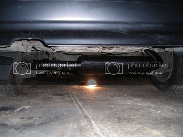

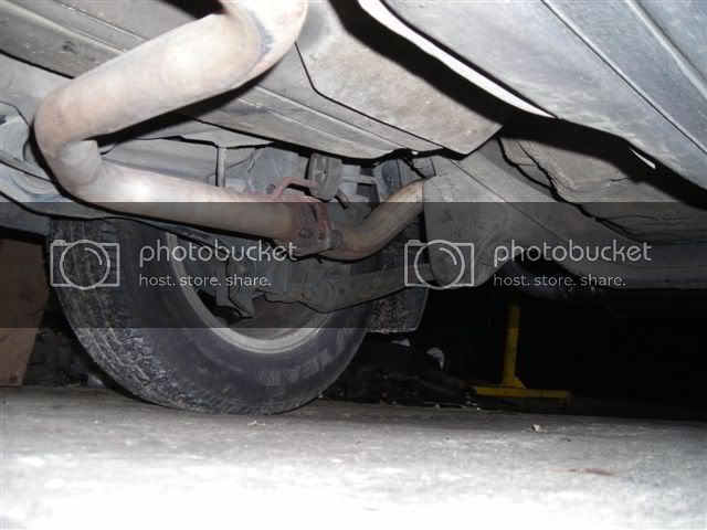

Pics of the finished DA2EE exhaust mod
Finally got to drive it tonight...what a difference!

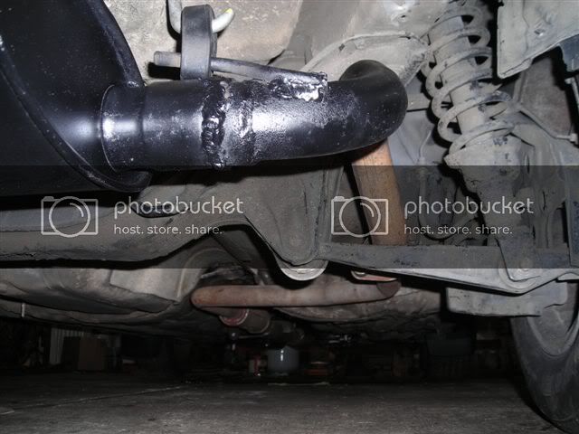

...and no cracks about the welds. Just 'cause I own a welding machine don't make me a welder
In my defense, I was laying on the ground, welding cover passes over rusty old welds, trying not to knock over my PBR...

thats odd you had an issue with the hood hitting the valve cover there though. i've never seen or heard of that happening before.. i know i certainly didn't have an issue there with my engine clearing. maybe its just a wagovan thing?
I haven't heard of interference issues there either. Did Hasport make more than one version of B into 4thgen mounts? I bought these used...

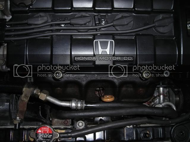

After checking out some bays I admire, I did a little carving
little by little 'til I could fit it in
also relocated the head/vc ground
and a big long single flash in OBD1ese is NOT a one, it's a ten!

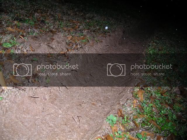

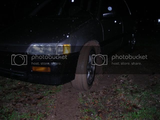

Now, a wagonist who had NOT been enjoying a Sierra Nevada Celebration Ale would've known better than to back down the hill in the backyard to turn around... in flooding conditions
Guess I'm not driving the wagon tomorrow- it's STUCK
