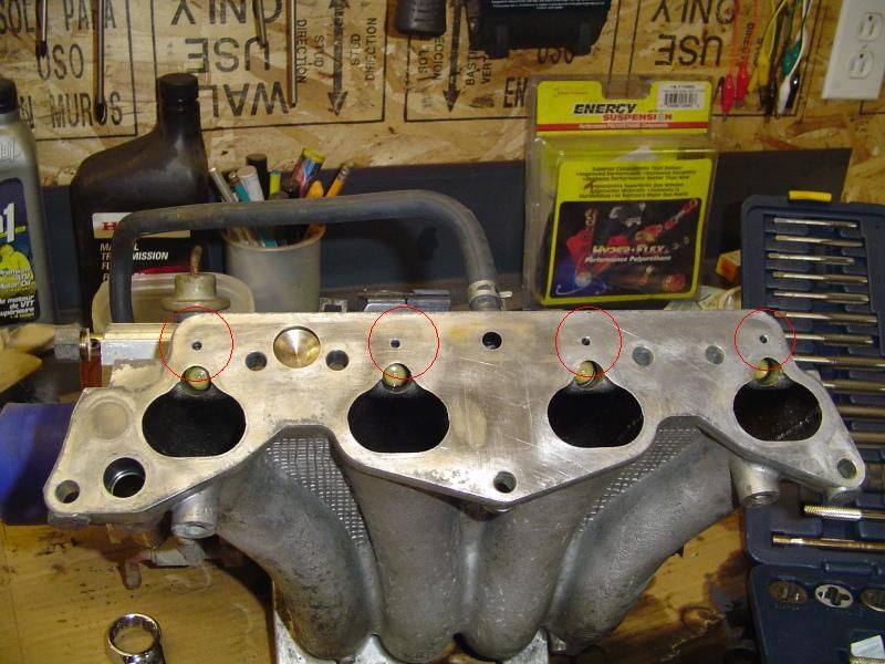

Well guys, it turned out to be the four hole difference between the DB16Y8 manifold and the DB15 head was what caused the whole problem. In fact, the vacuum from the holes caused the manifold gasket to fail, so when I sprayed carb cleaner near it was very easily detectable...thanks freak. Ended up plugging the holes with wood "golf tees". I was gonna try aluminum tape, but if the vacuum caused the gasket to fail, figured it might punch through the tape. Also tried JB weld, but it didn't want to stick to well...guess I coulda roughed up the surfaces? I suppose if the "tees" don't last, I'll pull it off and mig weld the holes up, but for now it's doing the trick. Decided to (eventually) replace the obd2 (p2p) ecu with a (p08) obd1 with a conversion harness, to get rid of the cel instead of the knock sensor trick. The "trick" seems too "jerry riggish" for me to be comfortable with.
Anyway, thanks freak & kevin for all your help. Maybe this thread will be useful to someone else experiencing similar problems.
Hey no problem glad to help.. And you can use the aluminum tape or duck tape. Either one will work that is what my friend used and I did the same thing when I used a y8 intake manifold..

My brother and I just finished the swap today. From d16y8 to d15b jdm three stage. Swapped intake exhaust manifold and dizzy from the y8 to the d15b. Car fired up and ran between 1600 and 1800. Few minutes passed as we were attempting to adjust the idle then idle started bouncing up and down. Kind of stuck at this point. Do you have any ideas on what the issue is?
The holes that are circled in red need to be sealed up I use aluminum tape or duct tape... If you did this check for any other vacuum leaks or air in the coolant system..
